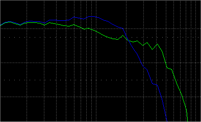

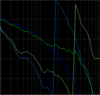

Set ARTA to spectrum analyser. Have your mic positioned at your listening position and press record, then move your mic sideways until your treble shows that it is properly centred.
Change to Impulse measurement and record a log sweep. In the time sequence that shows up you should be able to see the initial impulse, and might be able to make out the early relfections. By varying the gating time you can focus on different issues.
For example, try to find the quiet patch after the main impulse but before the first big reflections, and set your gate just before those reflections. Do a single gated analysis and set this as an overlay, then do a dual gated analysis. There ought to be some useful information there already.

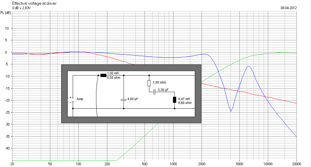

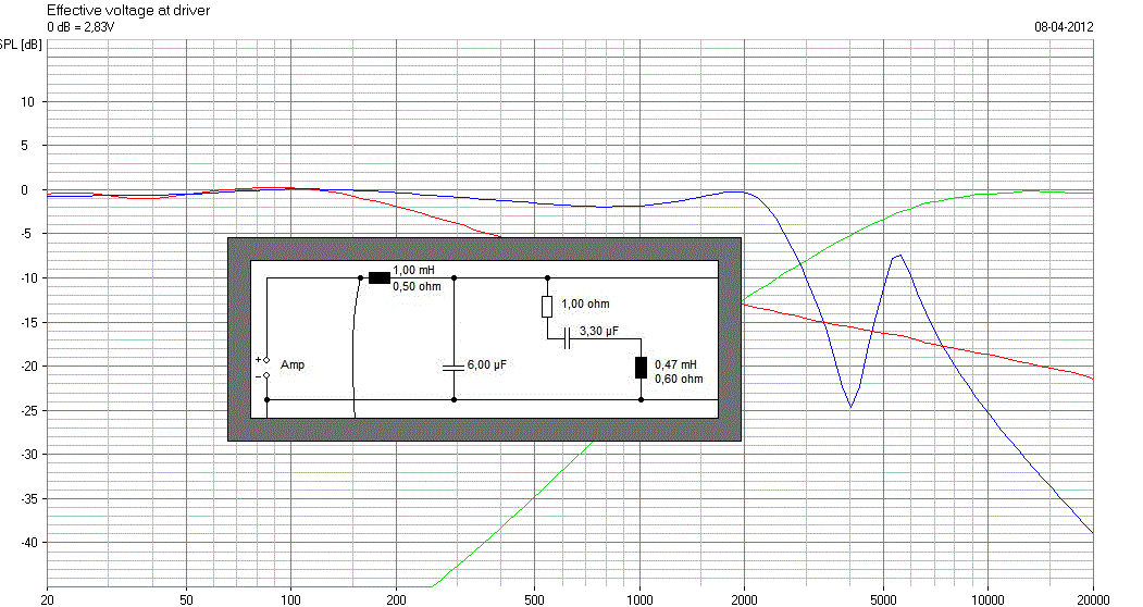

I believe many on the thread already knew that reducing the capacitance in a second order low pass filter increases damping but also increases the higher frequency content. (shown textbook, and with a real woofer impedance)when that really isn't the point.
Actually the opposite happens, you need to simulate to see it like I did, for my amazement.I believe many on the thread already knew that reducing the capacitance in a second order low pass filter increases damping but also increases the higher frequency content. (shown textbook, and with a real woofer impedance)
Also, as was referred a second order (+cap) on the woofer would also alleviate from top brightness/breakup peaks.
I would also make probably a third order on the tweeter, +for phase matching.
I'm prepared to back up what I said in theory. If you have a practical example that goes the other way, I'd be interested in seeing it.Actually the opposite happens, you need to simulate to see it like I did, for my amazement.
Chances are moderately good that it will, but fair that it may increase the response around resonance. Then the resultant phase change will not be of the nature that can be corrected by swapping polarity.Also, as was referred a second order (+cap) on the woofer would also alleviate from top brightness/breakup peaks.
Have your time.I'm prepared to back up what I said in theory. If you have a practical example that goes the other way, I'd be interested in seeing it.
What's your plan, Dave? Now I'm getting confused. &Chances are moderately good that it will, but fair that it may increase the response around resonance.
[Also polarity and phase might be something difficult to preview without a better more accurate simulation, but we/I work with what we/I already have (no data for frd-zma's/inductors) like size/dimensions of speaker, approx. drivers positions and some crossover data]
Adding a capacitor may reduce damping, similar to the blue trace in the second example using a smaller inductor, or may succeed, using a larger inductor like the first example. (I named the files backward )What's your plan, Dave? Now I'm getting confused. &
The phase now incorporates the extra component and a theoretical extra 90 degrees, which is typical. It's shape has changed and will not match either with or without a phase reversal.
The above would be true if the phase were a reasonable match to begin with, as it probably is...but if it were not, then what hope is there regardless. I considered these possibilities before posting earlier.[Also polarity and phase might be something difficult to preview without a better more accurate simulation, but we/I work with what we/I already have (no data for frd-zma's/inductors) like size/dimensions of speaker, approx. drivers positions and some crossover data]
I'm sorry, what did you mean with this?Have your time.
Just saying. Had to scan the images.I'm sorry, what did you mean with this?
0.5dB atten.@1000Hz
1dB atten.@2000Hz
This data is verified with the data available for simulation. Taking into account output+phase final frequency output is in another graph not shown.

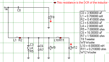

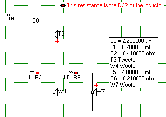

1. Lowering crossover frequency with 6uF on tweeter.
2. 4uF on the midwoofer, now available from tweeter, gives a better handling at lower crossover band.
3. And finally the second order for the woofer, to prevent some of the breakup.
You can find a crossover I designed a little wild ago, that had that in mind, with 2xDynavox LW6004PMR 6-1/2" woofers and a Vifa DX25TG-05-04 tweeter.
http://www.diyaudio.com/forums/multi-way/163796-some-design-help-please.html#post2131776
