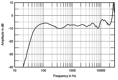

This is not a good idea, the crossover will have been designed appropriately for the drivers. The stand mount version of this speaker, the GS10 was measured by stereophile and although not perfect, the crossover does a decent enough job for being as simple as it is.
Monitor Audio Gold Signature GS10 loudspeaker Measurements | Stereophile.com
First of all we can see that the response is reasonably flat, save for a peak in the top octave. This would be my first target for an overly birght balance.

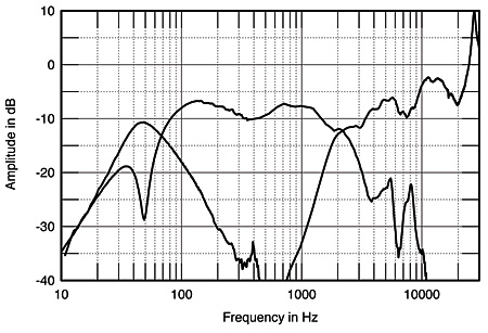

Stereophile is also good enough to show us the individual driver responses with the filter in place.
Here we can see that the mid/bass clearly has a strong resonance with MA targeting the notch filter at just above 6kHz.
The design isn't bad but there is definitely room for improvement. One would need to be capable however to actually do this correctly.
