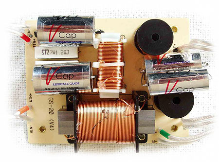

Is it really modified? Or it's just the looks...:cool:
Monitor Audio GS-20 crossover, Modified by Pierre Krebs
V-Cap comments by Pierre Krebs

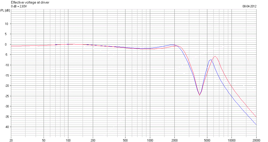

Actually the opposite happens, you need to simulate to see it like I did, for my amazement..
Are you refering to the 'parallel' capacitor in the woofer's XO? I did some simulation in LsPCAD and found that increase the cap rolled of the amplitude of the midbass faster but it also affected phase.
Yes. Refer to posts #97 and #106 for your answer see the simulations done both by me and AllenB with the obvious commentaries.
Phase is affected lightly. (This is w. such a small change in the cap value.)
Use clarity caps (SA or better), replace the 1,2 ohm resistors with 2,7 ohm, replace midwoofer inductor with goertz 0,58 - 0,6 mH 12awg, or 14awg if you like treble / bass.
(and maybe replace tweeters with Seas tffc, (-haven`t tried)).
Give it some days and the speakers goes crazy, - its heaven.
