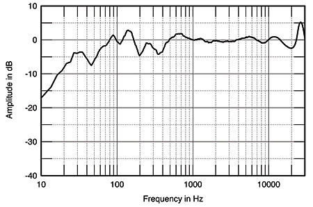

We can see that that isn't what's going on with these loudspeakers. The Stereophile review shows that in the GS10s, the two way version of these two and a half way speakers, that there is no peaking around the xover frequency like this whatsoever. It is unlikely to be causing the issue with these speakers too, although granted, it's not 100% certain.

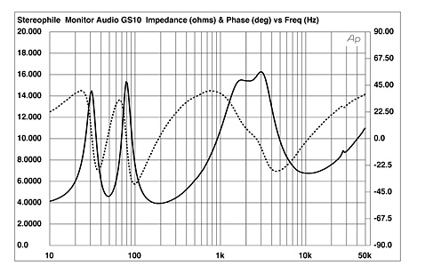

Here is a measurement of the GS20 done by stereophile. It is the top trace.
It looks almost identical to the GS10 throughout the xover frequency and we can see from the GS10s measurements that the xover shows no peaking whatsoever throughout the transition band of the mid/bass.

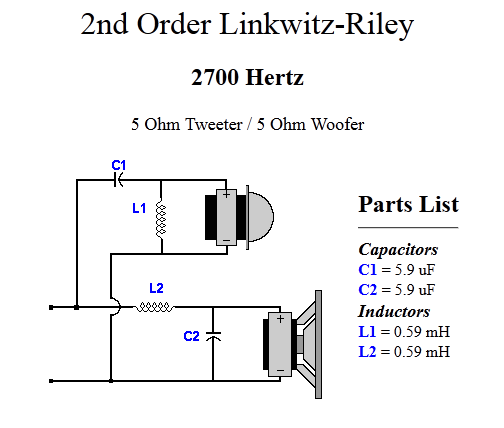

It's to do with impedance being interrelated to frequency response. For a High Q filter setup like a chebysheff, you peak output at a low impedance. By contrast, Linkwitz_riley has a rise in impedance corresponding to a less peaky output at a lower Q. The power calculation is modified by the load impedance so you're not breaking the laws of energy conservation. Butterworth falls between the two, being overall flat impedance with a slight SPL rise due to having two drivers reinforcing each other.
In this case we seem to be looking at Linkwitz-Riley filters by the impedance signature at 2700Hz, which is the crossover frequency I reckon. As strawberry has picked up, the filter rolloffs seem slightly staggered, hence the untidy double hump at crossover.

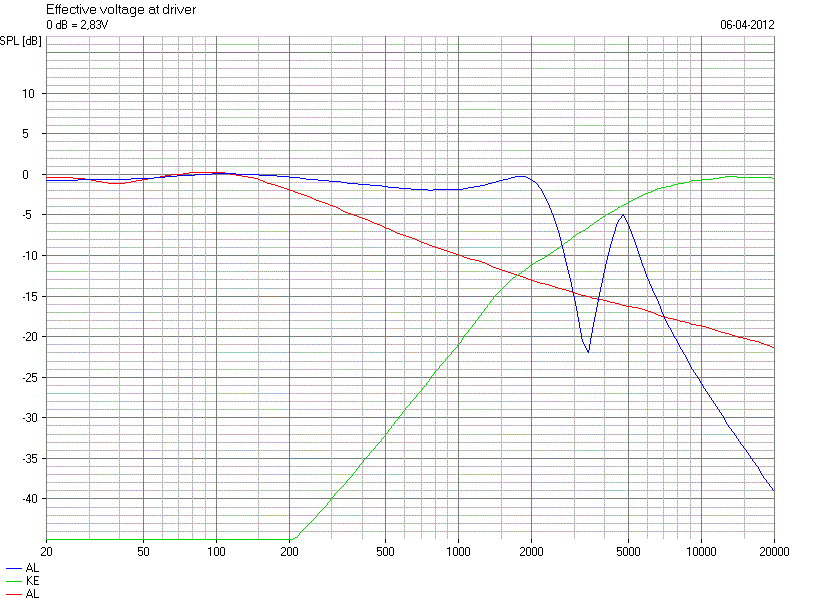

This is an approxim. simulation of the crossover electrical response.

What's more is, while we might be able to deduce from the impedance profile that the MA filter circuit might be a little off, should we try and figure out what should be changed using a simulation and suggest alternate values to address it? Maybe even post that simulation? or should we just say "meh, flip the capacitors around and add this arbitrary value that I can't explain how I came up with." and then when people invariably say "What are you talking about?" have a two paragraph tantrum that still doesn't address anything relevant unless you consider butthurt raving about our psychological health to be germane to the discussion.

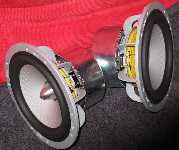

I don't know if it helps but the midrange driver has 5.5 ohms DC resistance and 1867grams weight Bass driver has 11.2 ohms DC resistance and 1788 grams weight

Here's what we know at the moment aside from the fact that these are tricky metal drivers with all sorts of unpleasant resonances:
Tanks (aka Traps) and notches (of which MA have fitted one on the midbass) have an unpleasant effect on impedance. IMO, it's gonna be more doable to modify the crossover to third order and attenuate the ringing beyond crossover point. The impedance plot also showed a resonance at 27 kHz and an unfortunate rise in impedance beyond, which will affect some amplifiers more than others, which is why an L-pad on the tweeter might help. The bass unit could perhaps go to second order.
As Troels has often noted, metal cones always sound like metal cones, and polys like polys, so I'm not expecting miracles here however good the fix!

A look at the tweeter+filter response in post nr 31 is quite revealing.
It can been seen that at approx. 7 kHz the tweeter plot steeply rises tot +7 db at 12kHz.
This very sudden, not gradual, rise in response might well be the reason for the somewhat bright sound of this system, in my experience at least.
My suggestion would be to, instead of changing drivers or upgrading to boutique components, redesign the high pass section with an LCR trap. This will not be trivial, since a suck-out LCR trap at approx 11 kHz will be needed to flatten out the tweeter on axis.
Measure and import your .FRD and .ZMA files into BoxSim.
Be prepared with BoxSim, however, you will have quite a job to simulate such a suck-out plus hi-pass.
After such an optimization, a little experimenting with tweeter levels through a series plus parallel resistor can work miracles in the overall presentation of a multi-way loudspeaker.
Furthermore, it seems to me the LCR trap in the low-pass section is also sub-optimal.
Have fun and experiment before you start buying new drivers.

It doesn't look like 0.5 mH and 6 uF will be the disaster I spoke of. The capacitor is still too small to create the hump in output that is possible otherwise. From the second order crossover it looks like the mid driver is following its raw output up to about 3 kHz, and then it rolls off. But the trap around 7 kHz should cut out the unwanted peaks. A swap of the 4 uF and 6 uF is still a good idea and should be tested. 20 uF on the woofer. And it's just a test, and a fair guess, so no, the world will not go under, and there is no need to get nasty.
Fig.7 Monitor Audio GS10, spatially averaged, 1/6-octave response in JA's listening room.
Given the debate regarding the GS10 x/o you can't really argue
with the above. There is no sign of any real issues at the x/o point.
It does look somewhat hot at the top in general, a more HT like
flat power response in the treble than the more old school hifi
flat on axis response with an inevitably drooping top end power
response.
