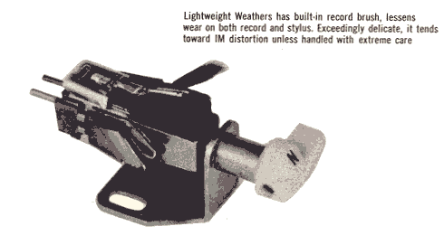

But this thread did remind me of those old PiezoElectric record pickups though. I'm naturally old enough to have used one...This was before CD and MP3 you understand. They sounded pretty good and didn't need much equalisation, but definitely low end. :eek:
Unlike magnetic coil cartridge devices, which are called Constant Velocity, they are constant amplitude. Electrically, they would only drive a very high impedance around 2 MegaOhm IIRC.
This ancient device had a stylus you could turn over to play either microgroove LPs or the ancient fatter grooved Shellac 78s which were originally played on "Wind and Grind" record players, called that due to the old bamboo stylus and mechanical horn arrangement driven by clockwork in the 1920s.
In fact, most of the old Louis Armstrong records from the 1920s are copies off 78s. Crackle comes free. :D
Thought I'd share. Goodnight.

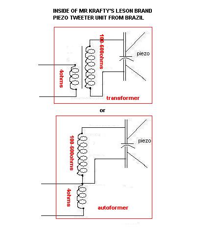

Oh, and i thought this sketch might be useful for the sake of this discussion ... This is a schematic of what is contained within Krafty's LeSon brand piezo tweeter.:)
It is one or the other (out of the two arrangements in the sketch) and they both accomplish the same goal..
The point is not the alleged impedance of the transformers,
its the reflected impedance of the capacitance of the piezo
and the necessarily very low subsequent voltage rating.
rgds, sreten.
DCR of transformer windings usually don't tell you much, but
here I'm prepared to concede that said windings are also
effectively the series resistance I said you must have.

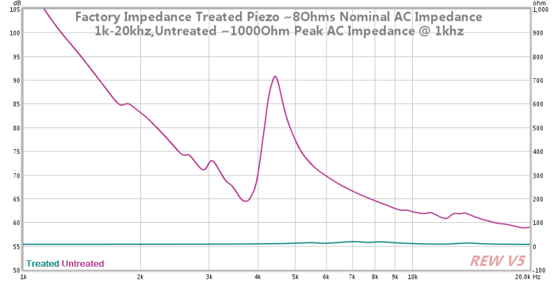

Sreten, this guy performs an impedance sweep on both units and the results tell us a lot about how the impedance curve can look, at least on the primary side of the transformer.
Custom Piezoelectric Tweeters - Impedance Treated (Measurement) - YouTube

Ahh, ok, so the one tweeter in that guy's video is a LeSon TLX-2 you say .. very cool ... do you like the way your TLX-2s sound in your living room? What sort of network did you use with them?
Hopefully your 4ohm LeSons have a primary impedance that is as flat as what the guy demonstrated in the video... The measurement of his LeSon was extraordinarily flat :) .. Since his and yours are the same brand with the same circuit we could assume that your impedance curve is likely to be at least reasonably flat....
In case you guys didn't catch it The LeSon's curve is the light blue curve on the bottom which he calls "treated" (meaning it includes the transformer)....
The other curve, the wild looking one (light pink) is the "untreated" 1016 style Piezo..
The flat impedance curve of the LeSon is a good thing :) because it makes designing networks for it easier, more straightforward, and more likely to have predictable results :)
