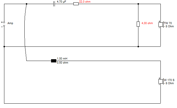

Please check out my final circuit X/O with piezo

Back to the Piezo. I'd use a 4 ohm shunt resistor to give it a good steady sort of impedance to start with. It will never rise above 4 ohms that way even if the transformer presents a very high impedance at high frequencies. We are guessing it's gonna actually be 2 ohms with the piezo and 4R resistor in parallel.
Then a series resistor of say 20 ohms decoupled from DC by the series 4.7uF capacitor will become an attenuator with a 1:10 step down, becoming 1:5 in the worst case of the tweeter becoming a high impedance.
Seems simple enough. See how it sounds.
You can fiddle with values later.
Here's the trial circuit, since pictures are easier. Just use some nearby value, this is rough and ready!

Ok, I guess this would be it?
I need to understand if the part you say "decoupled from DC by the 4.7uF" is right in this circuit, since decoupling caps are placed from hot to ground...

Update: Just saw you posted a circuit. The difference is that the cap is before the 20R resistor. Doesn't that go against the manufacturer's order of components?
Your circuit isn't the same thing. It will burn low frequency power through the wirewound resistors. Which is wasteful. I've a feeling it would let more low frequencies through to the tweeter too, maybe even resonate with the coil.
This tweeter only has significant output above 5kHz, so the capacitor goes where I drew it. Actually, if you exchanged the 22R and 4.7uF in my diagram, it wouldn't make any difference.

The parallel resistor is not a bad idea, it should insure that we have a more-so flattish impedance response :) Based on the most recent sketch that was posted the series 4.7uf is going to have to be changed to a different value now though since it is seeing a 22ohm load instead of a 4 ohm load so in order to maintain the same crossover point the value for that cap will have to be around .8uf (or you could try caps in the ranges of .5uf to 1uf in order to "season to taste" to get the sound you want ..)
However, another option here would be to reverse the positions of the 20ohm (or 22ohm) resistor with the series capacitor, but in this case the cap's value would have to be doubled to 10uf in order to maintain LeSon's suggested crossover point ... Two 4.7uf caps could be "piggybacked" to get close enough at 9.4uf. :)
4.7uF into 22 or 26 ohm load is going to be a very low crossover altogether. I'd think it's -3dB below 2kHz. So far I think the response of the piezo will be almost free-running, which means it's -3dB around 6kHz.
In other words, 4.7uF is way over the top really. There may be scope to reduce it later.
Swapping a resistor and capacitor round makes no difference at all, if you don't mind me pointing it out. The overall impedance R + 1/jwC is the same as 1/jwC + R. Notice my use of the engineer's j rather than the mathematician's i. We are, after all, PROFESSIONALS. :D
by the way guys, the piggybacked cap and resistor components that i included in a previously posted schematic are nothing more than a little bit of equalization ... Adding a RELATIVE boost to the highest frequencies reproduced by the LeSon by attenuating (via the resistor) everything below the high pass filter defined by the value of the cap ....Of course if using only a 4ohm resistor in the network the effect will hardly be noticeable, it will require a larger resistor value to make the effect more apparent ... It no big deal and its nothing mysterious, and it is by no means necessary but can add a little bit of "air" and sparkly high end response if that is what is preferred .. It can help you approach a sound more similar to what you would want for home audio use or car audio use instead of the traditional harsher PA compression driver sort of sound..

For example , here is something else that is counterintuitive and zany .... Take a look at what LeSon is suggesting to us ... A 4ohm load with a 4.7uf series cap ... If you put those figures into a crossover calculator you end up with a crossover point of around 8500hz! Which doesn't seem to make any sense to someone who is expecting to get strong and fairly flat output down to 5000hz but what i have found from experience is that adding a step-up transformer to a piezo can create quite a significant tilt up on the bottom end the piezo's range, and as it turns out the series cap has a shallow enough curve (1st order =6db per octave) to almost perfectly compensate and correct the response. Cool eh? :cool:
