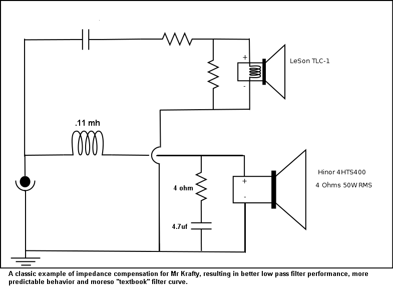

Tested the last incarnation of the circuit, with the shunt and 0.11mH filter. I can tell you that the tweeter is very muffled. If I short-wire the 22R, there is no effect. If I place another 4.7uF cap making 5.36uF, there is a tiny improvement in treble. But I guess this would be "alright" for a standard golden ear. My ears are kinda not so golden and demand a bit more treble.
Seems like the 4.7uF + 11R in the living room enclosure is much better.
Krafty ,
The shunt resistor is attenuating the signal a bit .... No problem , you will just have to use an option in our list which has a smaller value series resistor ... I would try the first option in the list which employs the 10ohm resistor and the 1.2uf cap (except that if you include the shunt resistor it makes the tweet look like a 2ohm load so that series cap should really be 1.4uf)
I could draw up a sketch for you if you like .....
Or you could just try removing the shunt resistor, making it similar to the network in your living room speakers ....
Let us know how it goes :)
Ok, here's my latest findings...
The coil seems to be "null" on this circuit. If I shortwire it, no changes.

You are correct about needing to do all tests with the EQ settings at 0 ... That way you know that the frequency response of the amp is close enough to "flat" for the sake of accuracy..
If all goes well we can get your speaker to sound reasonably good without EQ, and right now at this stage that is the goal we should be striving for ..
In the end, if we have done a good job of choosing the right values for your network then only minimal amounts of EQ will be needed for satisfying sound when you are listening to music (at least when it comes to midrange and treble, but better bass would require modifying the cabinet) :)
So Krafty, it sounds like you found out that you need around 10 ohms of series resistance (without the 4ohm shunt) or a 5ohm series resistor along with the shunt which actually calls for the cap to be 2.5uf ....
Both of those above options will sound exactly the same with your tweet since it's impedance is likely well behaved (like the LeSon in the youtube video which uses the same internal step-up circuit) ...
If you want to reduce the amount of 5000-9000hz spittiness that you are hearing you might want to try a cap with a slightly lower value such as 1.2uf instead of 1.5uf (or 2.2uf instead of 2.5uf) , and just let me know if that gives you a sound quality that is closer to what you prefer to hear, ok? then we know which direction to take things.
About your woof, your coil will only lower the 6000hz+ frequencies and it's effects might be subtle in that lower range, there is a simple way to increase it's effectiveness though(with components that you already have), and we can do that if it is necessary to reduce the interaction between your LeSon and woofer (in the range where they overlap a bit ) to smooth things out ...
I can sketch up a schematic for you if you want to see how this is done ..

Yeah, I kinda noticed that it has a very subtle effect. Was testing here without the tweeter connected. However, folks saying I need 1mH, it would get even less mediums, is that right? I might buy those just to see what gives... Know of a cheap online store to get those 1mH?
Yeah, you can sketch this up, please.
Also interested on what sreten has to say as rebuking whatever that he thinks it's wrong, preferably not with replies in bits.
I took the late night to read this post.
So, I am going to start over and try to follow everything that is in there. Including adding components to the midbass.
I feel relieved that the air core filter, 0.11mH looks like the ideal according to the calculations of that tutorial. A 4 ohm midbass on a crossover point of 6.000Hz would be: 4 / (6.3 * 6000) = 4 / 37800 = 0.000105 = 0.11mH aprox.
But there is still impedance correction to be made, something I didn't do.
So that is why I am asking others here why they said this is not much of a filter, but instead 1mH is...
I realize I have been speaking crap on some posts and paying as an imbecile, even knowing the pretty basics of electronics. A cross over cut at 10.000Hz? That was laughable. Anyway! I will try to get more serious. You know, in the beginning you start as a total amateur, but then after defeating your laziness of reading, things start to make sense. A lot of you have contributed to a large extent, even through disagreements, it only helped me to move forward on this. Now I am planning on 2 projects, and it started as a very naive first project back in 2012.
Anyways I will seat down here and recalculate the whole scheme. Seems like the tweeter will still be the major villain being a piezo, but to be honest I am not seeing much of a difference of crossing it over from that tutorial, apart from a shunt cap and resistor and an additional inductor. Wellll... we'll see. I am even willing to buy conventional small tweeters if I find them here. I have to confess that the whole piezo thing wore me out. But I don't plan trashing them any soon, so I will try to work this out in the new scheme. But if I can get conventional tweeters, or cone tweeters this small, to fit in the same place, I'd be glad acquiring them.
Since I am also going to replace the living room drivers and no piezo tweeters in there, looks like I will be trashing all 4 piezos in the future :)
Any of you know a place to buy good price inductors on the internet (USA, Canada or UK)? (Except Parts-Express). Looks like I will need more.

Krafty,
I am glad that you are starting to consider the subject of impedance compensation because it is what i was going to include into the next sketch for you, a method to allow your .11mh coils to have a moreso "textbook" and reliable filtering effect.
As far as inductors (coils) for woofers are concerned i do understand where Sreten was (probably) coming from with his suggestion of a higher mh value, and it is due to the fact that any woofer's voicecoil (being a coil) has an inductance (mh) value of it's own which can take away from the effectiveness of a series coil via the rising impedance response (feature of inductance) of the voicecoil, so some people will just use a larger value series coil to compensate for this phenomenon, but being that your woofer has a small voicecoil, and is usable up to 8000hz would all indicate that your woofer's inherent inductance is likely to be rather small. So the amount of compensation needed will also be rather small (not tenfold) ... ANYWAY, there are other simple ways to compensate for the voicecoil's inductance ... I will demonstrate with the following sketch using parts that you already have :
