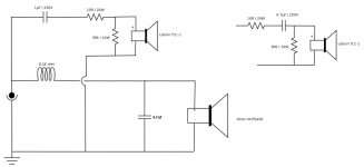

Please check out my final circuit X/O with piezo

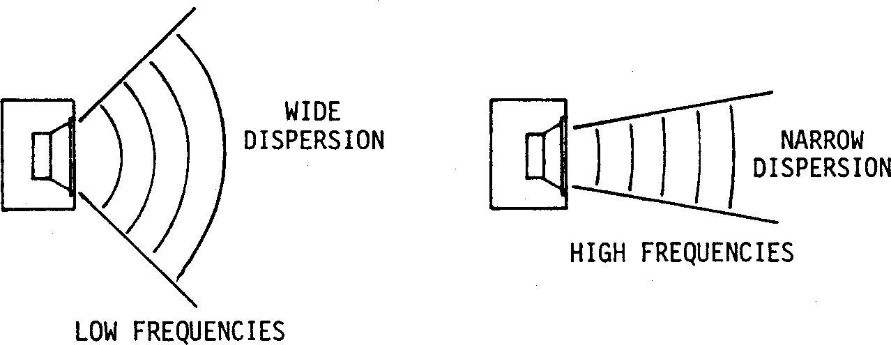

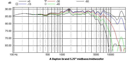

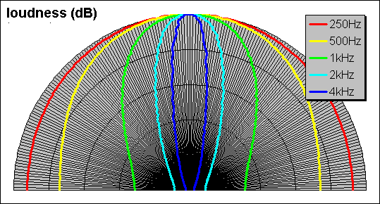

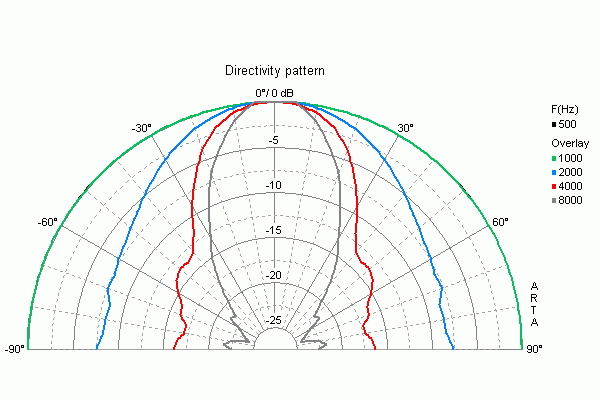

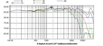

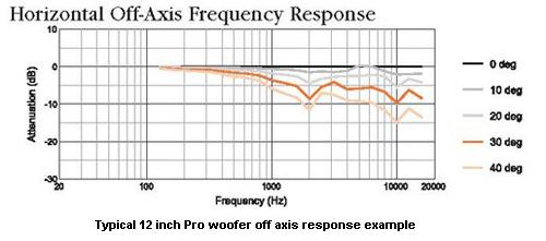

Krafty, there is a good reason that you will see a trend of larger diameter woofers using lower crossover points which is done for the purpose of avoiding problems like cone-breakup, and overly narrowed dispersion which is sometimes called "beaming" ...
Your 4 inch drivers should be ok for use up to 5khz or 6khz , the radiation pattern will start to be somewhat narrowed but should still be totally useable ..... With your 8inch drivers its a little bit of a different story, at 5khz an 8 inch woofer has much narrower dispersion which means it would sound ok as long as you are standing or sitting straight in front of the woofer (they call it "on axis" ) but if you walk around the room and move off to the sides of your speaker you will no longer hear those upper midrange & lower treble sounds, the upper mids will sound "scooped" and lack clarity until you walk back out in front of the speaker and then everything will sound good again.. ... It is only acceptable if your listening position is straight out in front of your speakers..
The above behaviour is a big problem for lots of commercially made 2-way pro audio cabinets made by big names that use a 15" woofer and a horn tweeter, im sure you have seen this type before, they are very common... With this design (unless their crossover point is set very low, which they are often not) there are major dispersion problems ... Its amazing that cabinets such as this example are so popular when their response falls completely apart if you are standing anywhere other than straight in front of it ...
This is one good reason why you shouldn't rely on your Hinor woofer to solely handle everything up to 10khz (which is what you would have been doing if you were to prevent your LeSon from reproducing sound below 10khz) ... So that would have been a bad idea ...
Its also the reason i will recommend going "3-way" for anyone who is wanting to build a speaker system based upon a 12 inch or 15 inch woofer...
Check out the different pictures that i attached, they are different ways to visualize the nature of dispersion.

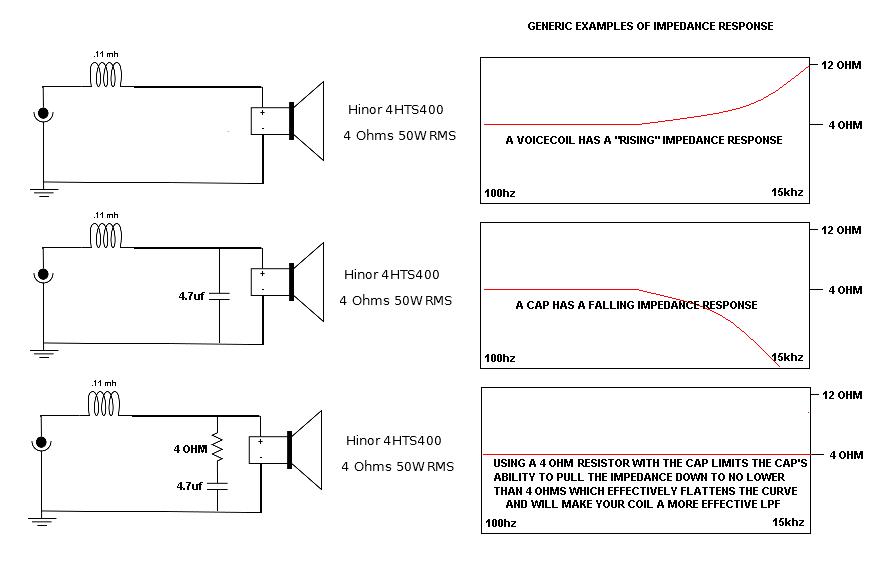

Matthew, I've seen that you've come up with a 4R resistor and a 4.7uF capacitor for the midbass impedance flattening job. As I read in the article, there are these values of Rdc and Le to take into account. How did you come up with 4R and 4.7uF ?
I have sent an email to Hinor asking for the midbass datasheet, specifically asking them for these two T/S parameters. So let's see what is their answer (if they ever answer).
(They did not go out of business - they just discontinued this product in question without leaving any legacy support or download).
I wanted to use values that you probably already had on hand (based on your earlier sketches and experiments), so this circuit was loosely based upon a "2nd order butterworth" filter at 6000-7000hz.. The values were "in the ballpark" enough to work ...
This will simply allow your coil to function more effectively and give you a sharper rolloff in the upper end response of your Hinor, in other words it should roll off faster above 6000hz with this circuit and that means there will be less overlap and less undesirable interaction with your LeSon ...
Take a look at the sketch , it explains how this method works ..

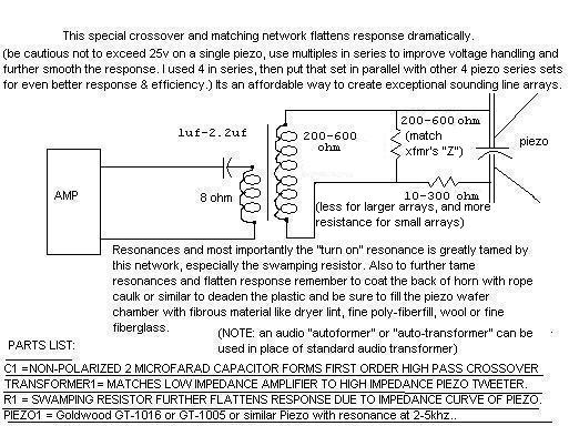

If your LeSon still sounds "spitty" to you then i have some other methods to show you for actually treating the Piezo itself (adding a few simple things within the casing), dont worry, its easy and cheap ;)
I built some Piezo arrays in the past using step up transformers and thats how i have some experience in this area ... After lots of measurements I found that i had to add some damping material around the piezo element itself (i used dryer lint! haha!) and i also ended up having to use a "swamping" resistor (200 to 300 ohm worked for me) across the secondary windings of the transformer (same as across the element's leads) to further flatten response, so as i said if your LeSon Piezo still sounds rough to you just let me know and i can show you how to modify it ..
When i finished with my Piezo arrays they sounded smooth and natural, much better than Piezos would normally ever sound :happy1: ... For me it was definitely worth the extra effort ...
This was the network i ended up using for myself .....
I found that the final series resistor seemed more necessary when using only one or a few piezos, and if i was using a larger array that value could be reduced quite a bit .... Using a series value that was too high would result in attenuating the response above 10k too much , especially on larger arrays ..
The parallel "swamping" resistor made a very noticeable difference! It really flattened and smoothed the response at the cost of a few DBs worth of output..... That compromise was totally worth it ..
I find it interesting that i actually settled with a 2.2uf series cap (before the transformer) at 8 ohms, coincidentally thats the equivalent to 4.4uf at 4 ohms which is almost the exact same target crossover point that your LeSon requires ... I still got strong response right down to 3khz (with the GRS brand piezos, but the Goldwood 1016s would only go down to about 4 or 5khz )
by the way, my transformer secondary was around 300 ohms, the transformer i used was actually one designed for wideband "70v" distributed sound and was good up to 15khz +... .. So I re-purposed it :D

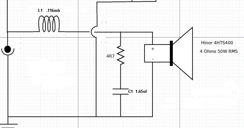

Well, you almost hit the nail on the resistor value for woofer. I did the math here. The "Rdc" or "Re" parameter of Hinor 4" is 3.51 Ohms. The ending resistor was about 4R3. So 4R was real close. I need to know what is the Le parameter, hopefully Hinor speaks this Tuesday about this.
Updating the calculations...
Well, getting the value according the tutorial....
Re = 3,6 ohms -> 3,6 x 1.25 = 4,5 R (4R7) -> 4R7 ^ 2 = 22.09
Le = 0,345 mH (0.000345)
Now to establish the value for capacitor, following the same calculation principle...
0.000345 / 22.09 = 1.5617926663648709823449524671797e-5
0,000015617...
(according to the tutorial, 0.0004 divided by 46 is)
8.6956521739130434782608695652174e-6, which is:
0,000008695...
So if the tutorial is saying this value is 8.7uF, then the result of mine would be 15uF? Is that right?
Good job on getting the complete specs from Hinor, that figure of .345mh is nice and low! thats a good thing! It means that only a small amount of capacitance is needed to compensate for the inductance in order the flatten the impedance curve ...
I will admit to be being somewhat terrible at math but if i count the placement in your figures i get 1.56uf for the first calculation and about 1.74uf for your second calculation and that seems like a very reasonable range....
It also looks like you used the wrong coil in the sketch, using a value any higher than 0.2mh would likely shift your filter point too low with the Hinor (would shift it to below 4.5khz) ....... 1.0mh shifts the crossover point to well below 700hz which would cause a gap in your response since your LeSon tweeter only plays down to around 5khz before it drops off pretty quickly below that...

Wondering why in that tutorial,
specifically THIS POST, he came up with 8.7uF
I confess that "not much of a filter" and "miles better" stuck in my head, as far as the coil is concerned. But others have stepped out of the thread and won't comment anymore. If 0.11 will do it, then it will be a win. The calculations so far gave me the exact 0.11mH, with the Hinor values and every cross over calculator out there, even with trying other "orders".
The 1 mH coil on the 4 ohm bassmid is a ballpark number
for the rather tricky "baffle step compensation" of the driver.
Could be somewhat less.

Matthew, well the maths really point to a 15,6 uF capacitor on the zobel network. I just used a online zobel calculator to confirm the previous manual calculation.
Updated the circuit, for now:
I will maintain the cross over split at 6000 Hz. I guess it was a good decision from the start. From the woofer's graph, 9000 is the max. 6000 is reasonable for cut.
I read about the Baffle Step thing, well... I don't know, as I read there are implications one can trap himself in, and for what I read, it is only necessary with some drivers? I think I won't go to the 1mH coil. Will stay with 0.11 with this set.
The piezo novel, well, I guess that the tutorial is not considering a piezo right? And a coil is not even needed like a normal cone tweeter... I may stick with either the two options I left in the circuit.

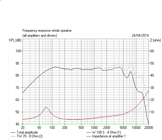

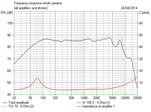

I'd be interested to see the frequency response of your 4" bass speaker.
You see it's obviously designed to run on the back shelf of a car, and sound reasonable with no filter at all.
The way to look at your bass filter is it just tilts down the top end a bit. The overall shape will be similar.
I just ran a 4" Visaton (Le 0.5mH) W100S-4 past boxsim as a wall mounter, which means it's close to a wall, so no bafflestep needed to boost the bass.
I think you can see what goes on with your filter of 0.11mH and 5R and 15uf, and a secondly with a slightly bigger 0.22mH coil plus half Zobel of 5R and 6.8uF. The dotted line is running fullrange, i.e. no filter.
This looks like it might work to me. :)
