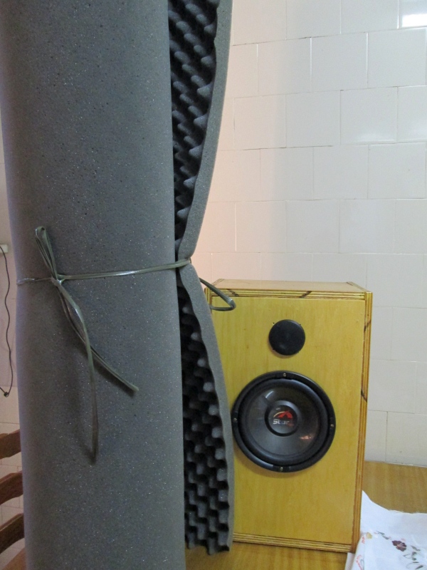

Egg crate foam doesn't actually do much.
It's usually used in cheap reflex designs.
Another one of your cheap throwaway lines that is misleading / wrong.
It doesn't do anything in terms of wall damping and is not
intended to, it is very good acoustic damping, near the best.
The good stuff is very expensive and ideal for lining vented boxes,
especially 4th order bandpass, but it is pretty pointless for sealed.
(Wall damping is addressed seperately.)
rgds, sreten.

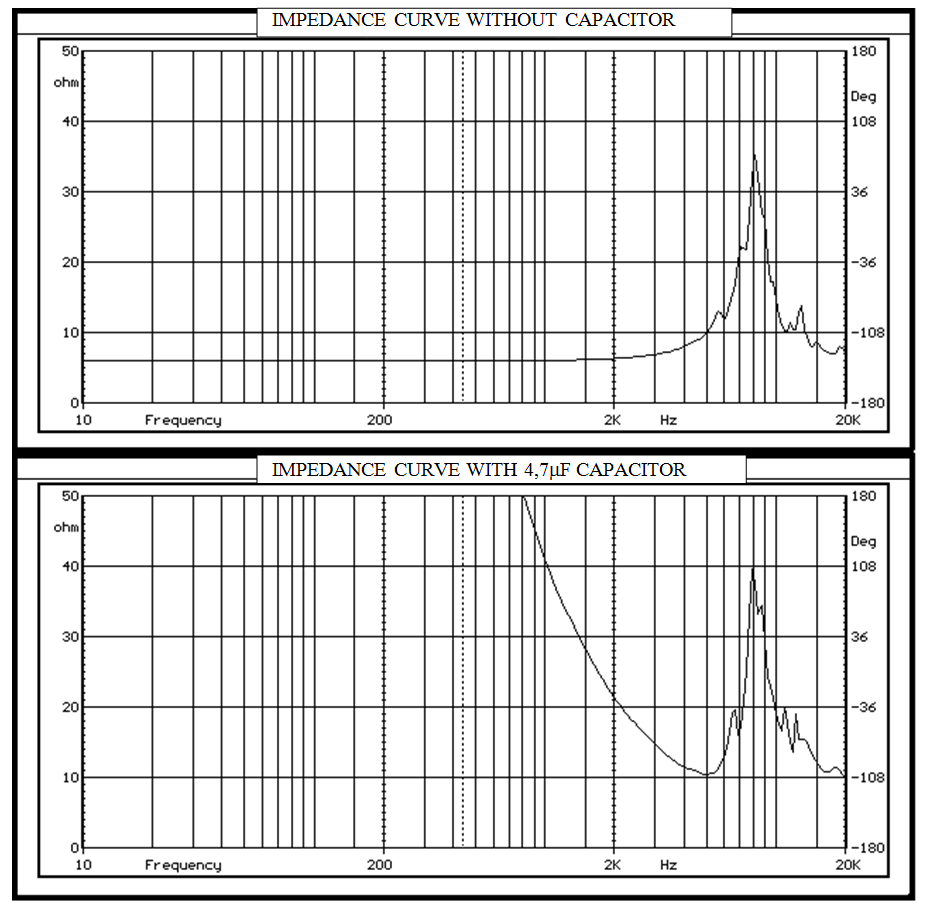

And the LeSon Piezo? don't sweat it guys, because it is not really all that mysterious and its not a "shot in the dark" by any means ... LeSon provided a response graph which i tend to believe is probably close enough to reality based upon the experiences i have had with making my own transformer driven piezo arrays, when done right the response can be that flat or even moreso ......So lets just move ahead and assume LeSon is being honest on the graph, especially since Krafty doesn't have the ability to measure response right now ... .
As far as the impedance response is concerned we already found a youtube video of a guy running impedance tests & sweeps on a similar model LeSon Piezo driver (with internal transformer circuit) , i can post the link again if anybody wants me to .... In that video he demonstrates that the impedance response is damn near ruler flat, its quite impressive! I wouldn't expect that Krafty's LeSons (that appear to use the same internal arrangement) would be very different ... In my opinion this would be a safe assumption since we know that the transformer circuit does a good job in regards to isolation, meaning the amplifier mainly sees the impedance of the primary coil of our transformer (or autoformer), not what is beyond it.

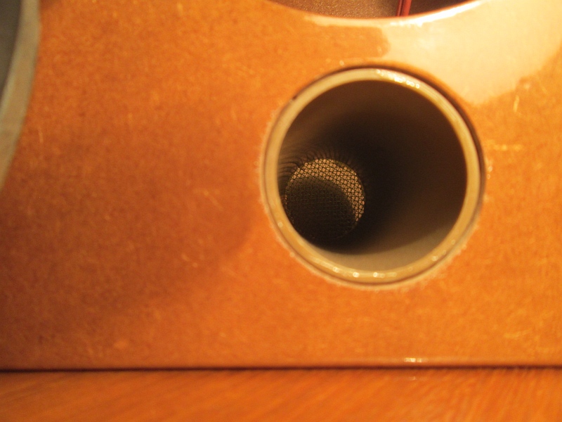

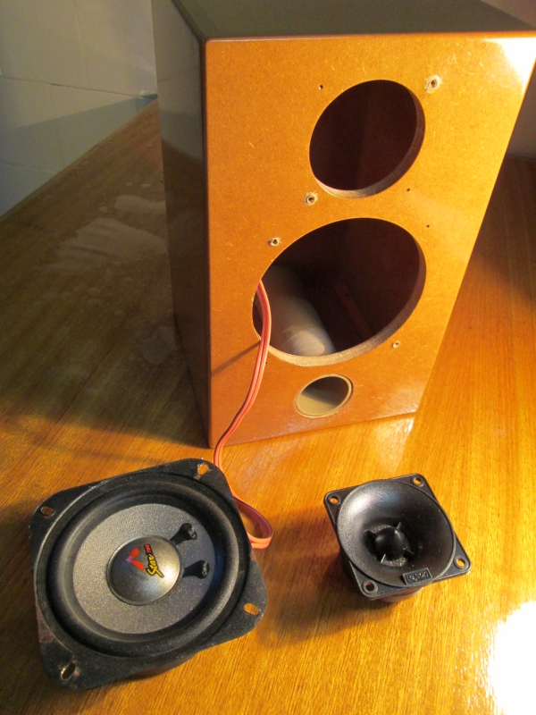

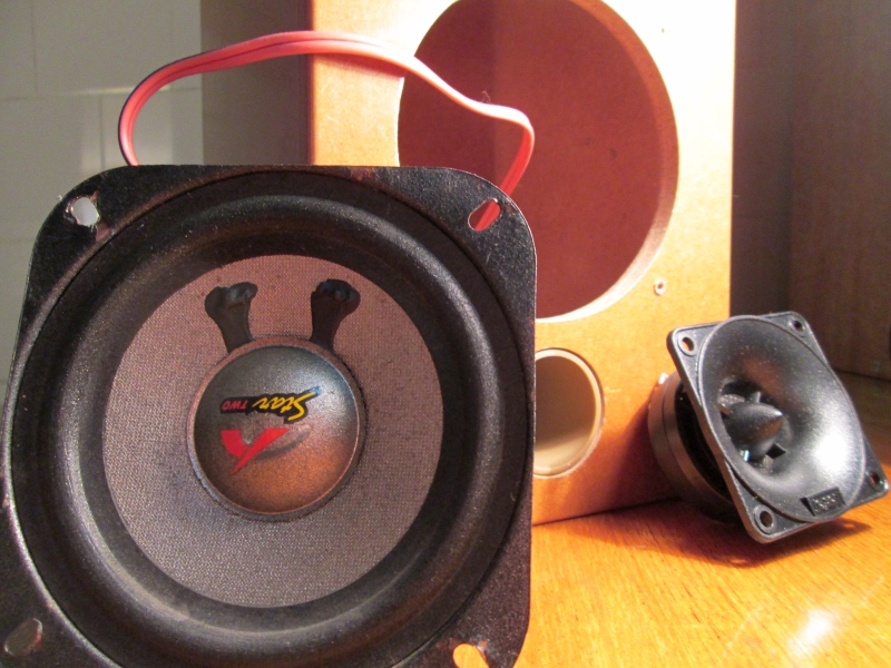

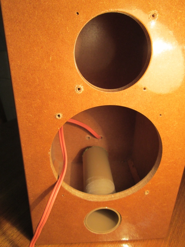

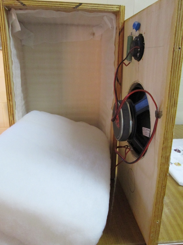

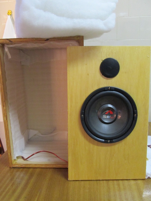

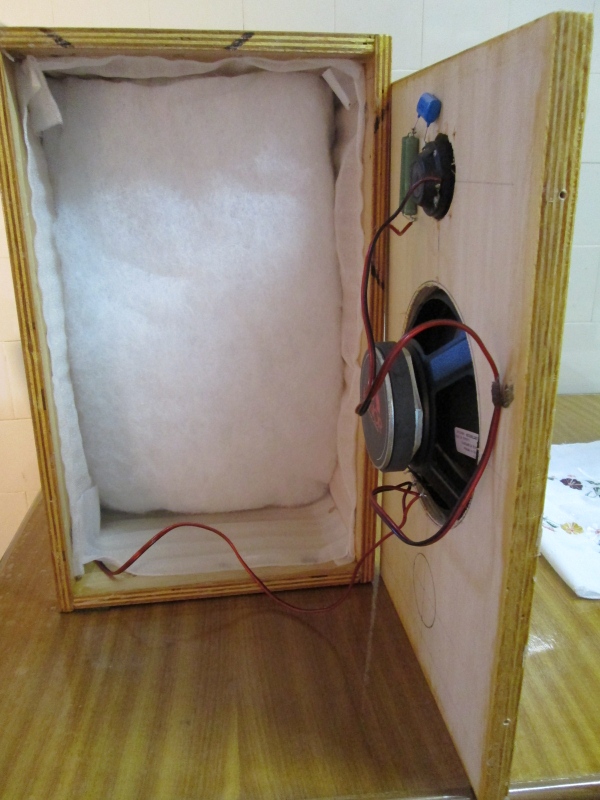

New pictures, right? Because this is fun, after all...
The box is 9.6 (h) x 6 (l) x 6 (d) inches. I made this box based on what WinISD Alpha and Beta told me to do. A vented 4.0 liter box. The port is 4cm wide (3,4cm) approx. 1 1/2 inches. Its length is 12cm or 4.78 inches.
You can also see my new foam.
I intend to put some on the small loudspeakers enclosure (this project).

Other thread project: The old setup has gaskets with addition of polyester damping sheets. I confess, that at the time, I had no idea of what I was doing.
I also intend to replace the bigger loudspeakers damping material by the egg crate foam, perfectly cut.

FWIW you just stuff a sealed box with fibreglass / rockwool / BAF /
pillow stuffing to suit, nice foam on the walls won't help much.
Vented boxes it will and it is the right sort of stuff. Though
the stuff you have is thicker than typical small box stuff.
rgds, sreten.

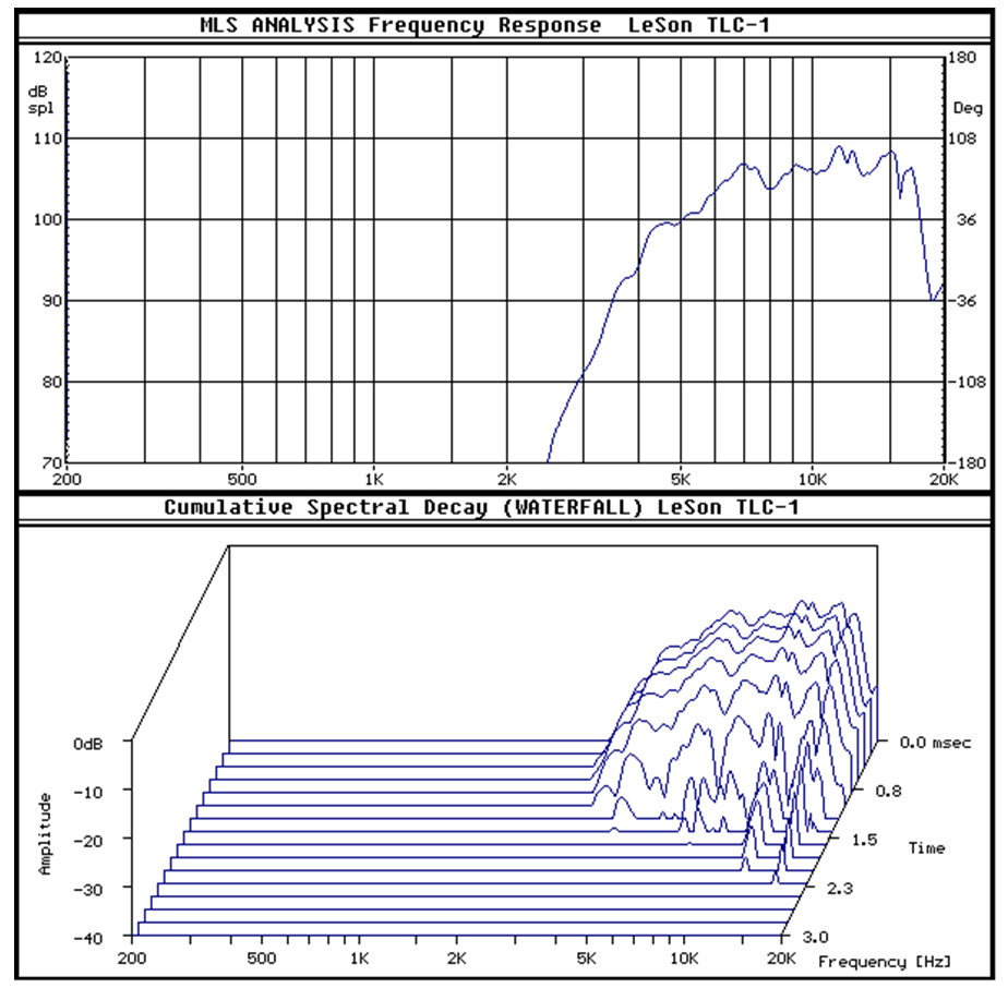

The tweeter datasheet sadly lacks an impedance curve,
so it is hard to predict the effect of a x/o on the given
driver response, which I assume is given driven directly.
I'm confused as hell, drivers intended for car use hardly
ever have suitable parameters at that size for 4L vented.
This is the effect of a typical box on a typical 6.5"/1", scale
the frequency upwards for a smaller typical driver and box :
rgds, sreten.

Good pics of your cabinets Krafty, and good job on getting more technical info on the LeSon tweeter! I think it is great that the Brazilian manufacturers are so responsive and helpful ! ....
That port in your cabinet for the smaller Hinor , how long is it? What frequency did you tune the box for using winISD?
That impedance graph that LeSon gave you isn't as flat as what that fellow measured in his video, surprising that they would be that much different since they are based on the same operating principle, same brand, similar range etc....
It also seems like they sent you the impedance response for the 8ohm version of that LeSon, if you will notice the impedance never goes below 6ohms on the graph ....... Nevertheless, its no big deal, just keep in mind that using parallel resistance will pull down the output of the LeSon in the range where the impedance peak is (centered between 7khz and 10khz) which can be a good thing if that range needs to be knocked down , on the other hand, if overused the small value resistors in parallel may cause a "suck out" between 7khz and 10khz so just be aware of that and use that adjustable option to your advantage
So it looks like between the careful choice of series cap, attenuation and parallel resistance you have quite a bit of control over your LeSon Piezo ...

That port is 12cm long. The frequency was 84 Hz.

Here is the impedance curve of tweeter!!!!
Thanks to LeSon supplying this!
So, tell me sreten, WHAT NOW....
Yes, well the plot thickens as the impedance curve is indeed
all over the place. However with the extremely high amount
of attenuation needed here just L-pad the tweeter with a
8 ohm series and low value parallel to negate the curve.
I have no idea what MMJ is talking about, regarding parallel
resistors, the smaller the parallel value the less peaking
you will get due to the series value and the impedance.
A small value cannot create a suckout, that is just wrong.
rgds, sreten.
I will explain, no problem,
First of all the impedance graph that they sent to him looks like an 8 ohm driver , not a 4ohm driver ..... Even without the series cap the impedance graph never dips below 6ohms, and with the series cap it never dips below 10 ohms within it's useful range, so once again if Krafty truly has 4 ohm driver in his possession then the graph we are looking at is not actually for Krafty's drivers ...
Krafty, what is the DCR of your LeSon drivers? Is it in the range 3 to 4 ohm? or 5 to 7 ohm range? If it is the latter range then that might be the proper graph, otherwise it is not and we are looking at a graph for another driver ...
Anyway, to explain myself when it comes to the parallel resistance/impedance response vs frequency response comments, its basically just a matter of relative attenuation meaning when there is a impedance rise and peak like what is shown in that graph (between 7-10khz) you can expect that when using parallel resistance (in parallel directly with the LeSon, in other words across the primary coil of his transformer) there will be attenuation of course, but the amount of attenuation will be greater where the impedance peak is located ..... So the response at 8khz will be attenuated much more than the responses at 5khz and 20khz (with parallel resistance that is)........
The reverse is also true when adding series resistance (would attenuate 5khz and 20khz more than 8khz .........
I was simply saying that this could be a useful phenomenon to exploit when trying to get his LeSon tweeter to sound acceptably good ..
The choices made in values and how to arrange the resistors could make the difference between a scooped response , or a response that has a big hump in the middle .... Or if we are good , a nice flat response
