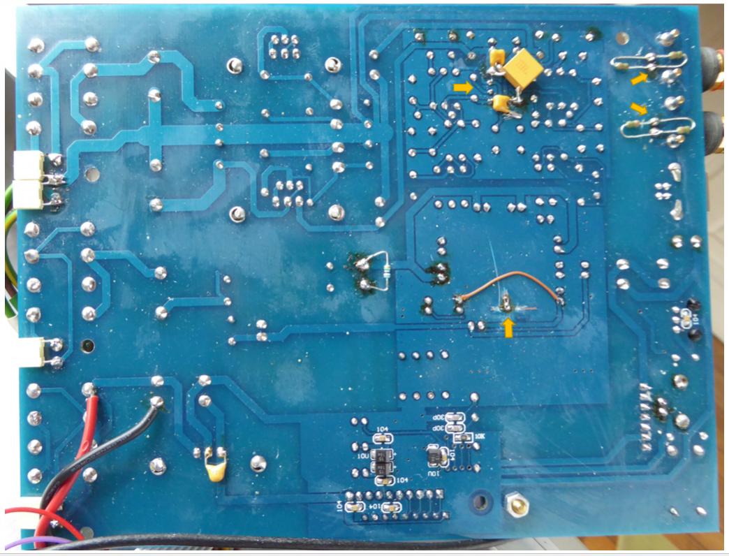

AIM can You take some closeup pistures and explane to us you'r mods?
Skrstic,
Mods are identified by yellow arrows in the two pictures.
On Above view :
• Restored control over SD and SLOW filter select switches : changed misplaced Dip Switch by jumpers
• Installed resistor attenuator on the output in order to reduce output level (-9,5dB)
• Changed 220uF on VDDL/R and VRefL/R on the output of the 6,7V regulator (LT1963) by 1500uF
• Removed film cap for high frequency decoupling of OpAmp
On Underneath view :
• Turned Off SSLOW filter :
o cut DVDD (+3,3V for Digital domain) track before and after the via feeding pin5 of the 4495.
o Connected the via to ground.
o Reestablished the connection to DVDD (brown wire)​
• Resistor attenuator
• installed OpAmp decoupling as closest as possible to the chip and with rights caps
• Installed discharge resistor for the 1500uF cap (see above)
That’s it, the DAC sounds OK for now. Next mods are planned in order to replace the MCU by an Arduino and take full control of the AK4495 and 4118. I also have to find a way to check if some critical component (LT1963, Oscon Cap on the Xmos board, 22uF cap around the 4495,…) are not fake.

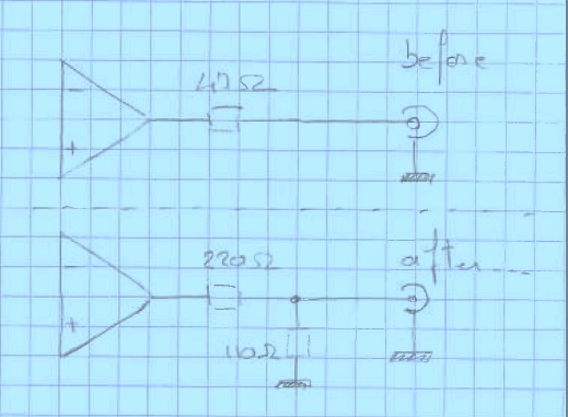

Hi Aim , thanks for the info.
Just for clarity , where do the resistors for signal attenuation go and what values did you use?

Hi Ozcal,
this is fairly simple, as we say in my country :'a good sketch is better than a long discourse'.
I used low values in order to keep low output impedance (event if ly NAD amplifier as a 100k on on input); but not two low in order to not overload the opamp which will have to handle the feedback in high frequencies. Why 110 Ohms with two resistors : my shop sold me 220 Ohms ones by pack of 10...
