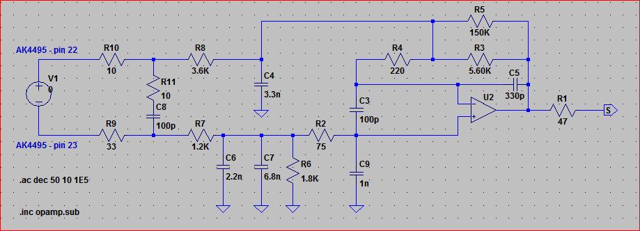

Bernie, my board is 1.1 and I confirm R2 is 75 Ohm, R8 is 3.6k and R4 is 220 Ohm. I think the 150k is aimed at fine tuning the gain and filter.
The gain is the pic attached, it should be correct but it's a very long time I haven't made those kinds of calculation ..... Notice that R20=R3//R5
On my board it's near +3dB. Cut frequency is around 105kHz.
I've fixed an error in the layout and changed the diagram in order to get it closest to the output stage of the DAC. (differential with DC offset)
Please also fin a plot with your values of R2, R8 and R4 : bernieplot.jpg
Much thanks! 3dB gain doesn't seem so much yet it's quite a bit louder than most DACs. Are they mostly unity gain?

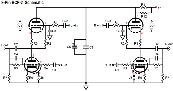

Hi guys , I run a passive buffered preamp. I decided to replace the AD827 OPAMP in the dac output stage with a valve based balanced to single ended unity gain converter by tapping the +and - inputs to the opamp. This works but has resulted in a large drop in gain compared to using the opamp.
Can I recover some gain by tapping the signal at the dac chip outputs ie at the input side of resistors R9 AND R10 as per the schemmatic(fig2)?
Do I need any added resistance or capacitance between the dac chip outputs and the input of the valve board ?The valve board is ACcoupled and the input resistors to the grid are 47k ohms.
Can I implement a passive low pass filter @80khz between dac output and valve board and what values of Rand C should I use.

Hi Ozcal,
I know very few about valves, but I'm sure you can’t replace an opamp by a unity gain amp with 47k input impedance. But I believe you may replace the whole AOP output stage by your valve's one. On our board the analog out stage (internal) of the AK4495 is powered at 6,7v and the output voltage is 2*2,8V peak to peak. Each minus and plus output has a DC bias of 6,7v/2 so you need cap (high quality ones) for coupling. You may try to remove all component of the right of R11/C8 and plug your valve AC coupled on the R10/R11 node and R9C8 node. Then you should build a 2nd order low pass filter after your valve converter. Or you may build a 3rd order one if you remove C8/R11.
Have a look to the following thread : http://www.diyaudio.com/forums/digi...entations-alternative-post-dac-filtering.html it may contains good insights for you.
Have also a look to the 4495 datasheet, out impedance is not given but load resistor should not be lower than 1k and load cap higher then 25pF.
Just to be sure...what voltage (rms) do the above translate to at the rca output?
If I understand you correctly, the ak4495 chip outputs 2*2.8vp-p (2vrms) and there's a further gain of 3dB at the LPF circuit, then the output is 2.85vrms.
Standard for most DACs single ended output is 2vrms.

Bernie,
You were right, this was high. I did a mistake. I currently think that differential output is 2,8 Vpp (2*1,4Vp) multiplied by (VREFH-VREFL)/5. where VREFH-VREFL=VDD=6,7V (see datasheet page 9). So differential output of 4495 is 3,75 Vpp or 1,32 Vrms; with further gain of 3dB by the ampop, the output of the board is 1,87 Vrms.
