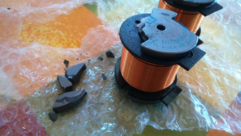

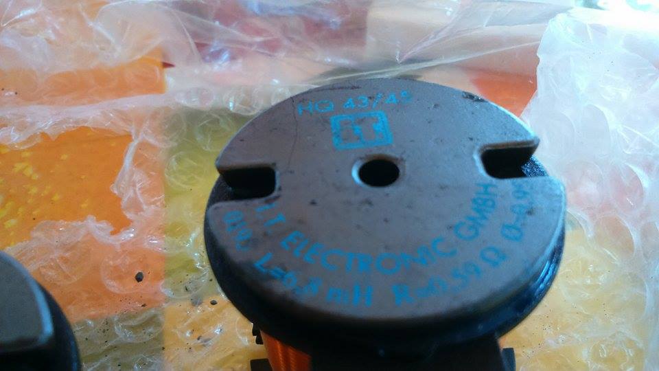

i got today the order from audiokit.it - but unfortunatelly 2 of ferrite coils are broken into pieces. had no option but send them some pics, and fill the RMA slip. i hope they undertand they need to package these kind of items better...
now ill see how long time the RMA will take, and the delivery process.
at least the rest of the coils and resistors are ok.
rough transport id say....

ive been talking to audiokit.it and they have offered to replace the coils with better ones since the coils above are out of stock and production. they even sent an message this morning saying the new better coils are already sent. this far their customer service has been top class. ill give a definitive valuation of their service once i get the replacements :D
