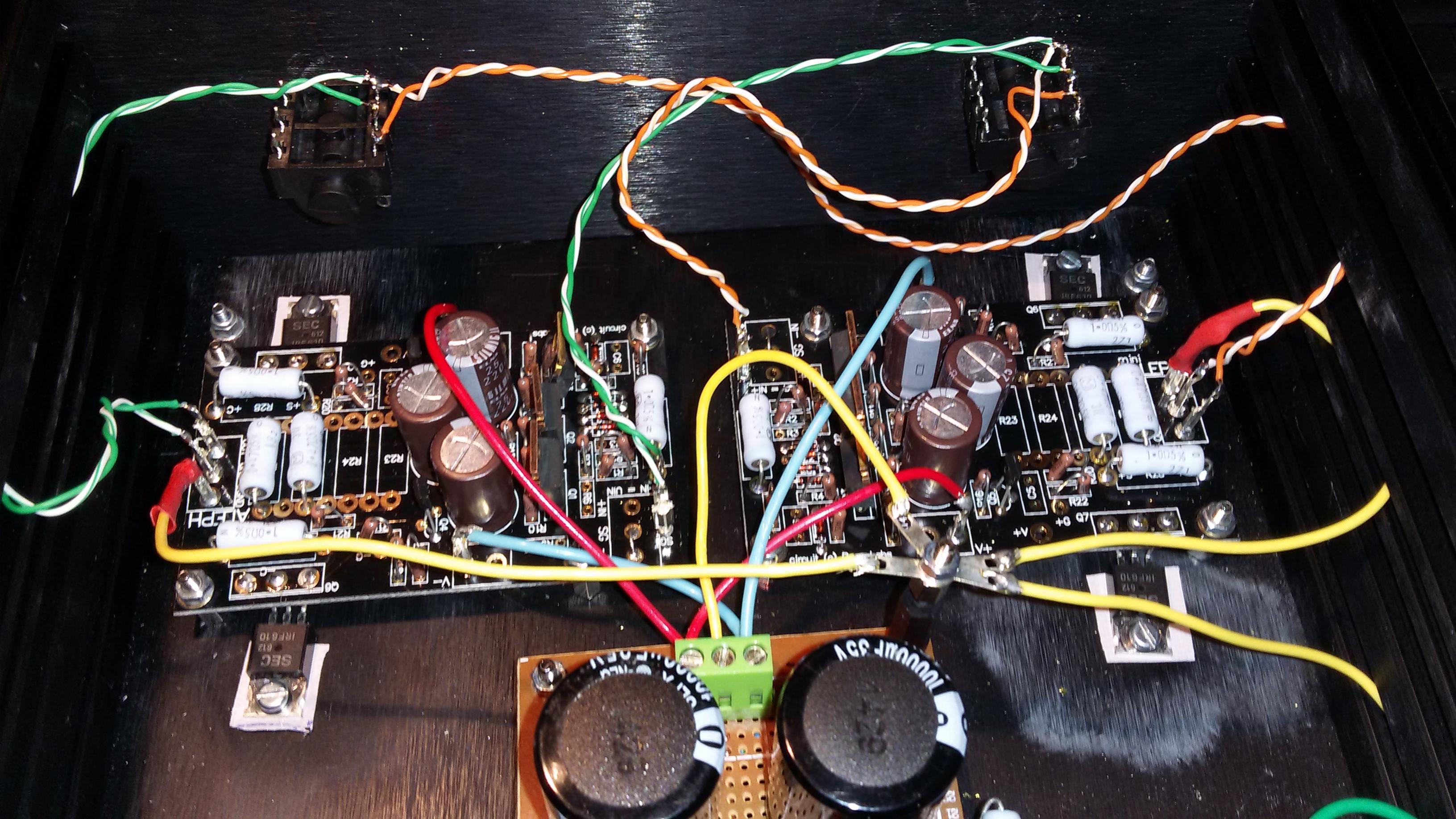

Assuming the hum was caused by a grounding problem, I decided to rewire the amp. See attached photo.
I removed the NYS2203 1/4" jacks and installed NYS216. The NYS216 is isolated (I checked with a DMM to confirm there is no connection between chassis and signal ground on the installed NYS216).
NYS2203 - REAN Connectors
NYS216 - REAN Connectors
I also replaced the input and output wiring, using twisted pairs stripped from Cat6 cable.
I changed the signalground wiring and made a new star point. The star point sits on top of a plastic hex spacer, so there is no unwanted chassis connection.
4 yellow wires meet at the star point. These 4 wires go to (clockwise on photo):
- left PCB at point marked CGND
- PSU 0
- right PCB at point marked CGND
- CL-60 (the other leg of the CL-60 is attached to the chassis)
This setup also gives me a "fat" connection between the two ground points of both pcb's, as suggested earlier by Zen Mod.
I had hoped these changes would have solved the problem, but the hum is still there.
Could the PSU be causing the hum?

If the aforementioned helps, you can then simply disconnect the white wires from the input and output connectors (leave the pcb side attached) and run another yellow wire from the connectors' ground tab to the star ground, which will only then be a proper start ground.
Y'all have no idea how much I hate ground loops...
Assuming the white cat5 wire is ground, you are forming a formidable ground loop through the inputs, outputs and yellow ground wires.
Disconnect all signal carrying wires from one channel (breaking the loop). Does the remaining channel still have hum?
Hi Rodeodave,
I disconnected the left channel (all wires, i.e. blue V-, red V+, yellow GND, orange + white from input and orange + white from output). Hum is still there.
Tried the same for the other channel (i.e. removed all connections to right channel PCB) bit it also has hum (actually a bit more than the other).

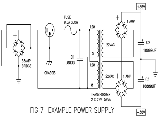

Hi Zen Mod (and others of course),
I had a small PSU board that I had made sometime earlier. It is the unregulated PSU as described by Wayne in the Pearl 2 article (see schematic below).
https://www.passdiy.com/project/preamplifiers/pearl-2
Each rail has 4 x 1N400x diodes (as bridge rectifiers), 1 x Nichion 10000uF 35V cap and a 3W 2k2 bleeder resistor. I know it will have a larger ripple than the PSU I had used so far (this Pearl 2 PSU is unregulated; the Pearl 2 regulates the supply on the preamp pcb), but it was interesting to see what it would do in my Aleph H. Would it affect the hum I had been getting?
I hooked it up to the 2 Amplimo toroids and yes, it did affect the hum. The hum got worse!
Note: this was with only 1 channel connected (input shorted) so not due to ground loops due to shared signal ground of both channels.
Can I generalise and say that in a given circuit, all other things being equal, hum or noise is proportional to ripple current?

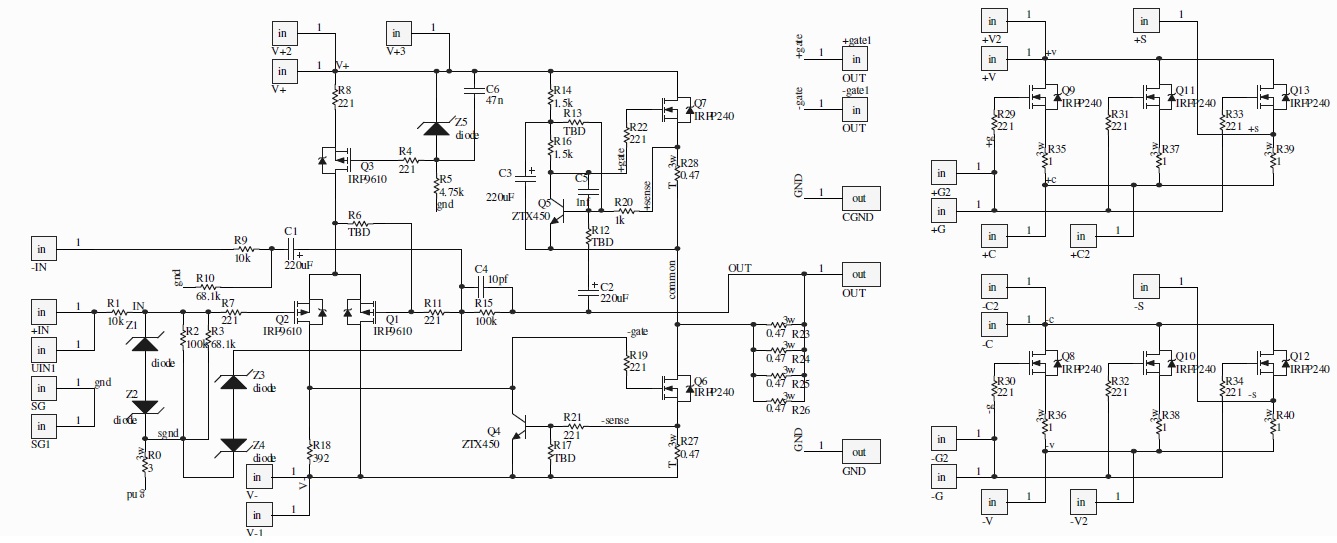

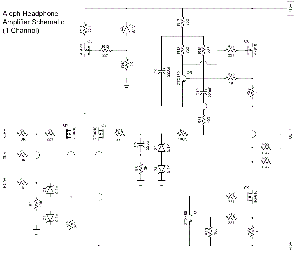

After re-reading the posts and the 6 moons article, there are a few things that I do not understand. Could it be that the schematic that Metalman posted in post#1 is wrong? I will try to explain why I am unsure if the schematic is correct.
But, the schematic does not fit the photo's or what is mentioned in the article!
1.
As Zen Mod mentioned in post #5, the amp discussed in the 6 moons article was unity gain. The schematic has 10V/V gain.
2.
The photo's in the article show a 50VA toroid. Zen Mod explained in post #55 when I asked if a 2x12VAC 30VA toroid was adequate:
But in the article Metalman is quoted saying:
Parts used.
- C4 (chipamp board numbering; across 100k resistor R15 (chipamp numbering)/R7 (Metalman numbering)) and
- C6 (chipamp board numbering; across Z5 zener).
These are not included in the schematic in post #1.

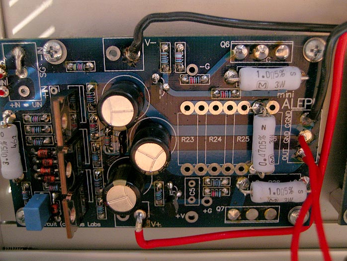

4.
As I mentioned in post #59, the photo's of the 6 moons article show only 1 3W 0R47 installed, but Metalman's schematic shows 2.
(R25/26 Metalman's numbering; R23-26 chipamp numbering).
I have no idea how good the general Aleph design is with regard to ripple rejection or otherwise if it tolerates a PSU that is so-so. I know that my DIY Aleph J (Peter Daniels boards, CRC PSU using 33000uF 50V Nippon Chemi, 4 x 0R47 3W Panasonic, 33000uF 50V Nippon Chemi) is dead quiet.
Could someone who can actually understand the schematic that Metalman posted in post#1 check it for any obvious errors? I am afaid I just "paint by numbers" and do not know how to proceed.

Do your output mosfet bolted to the chassis have a insulating shoulder washer in them? To keep the screw from making an electrical connection from the metal tab to the chassis?
More importantly, detach all the Cat5 ground wires from their current locations on the PCB and attach all to the star. (Yes, it will still work.)
Hi guys,
Thanks for your replies and suggestions. I have rewired the amp and reinstalled the original CRC psu.
wiring as follows:
both pcbs:
Red from V+ to psu+
Blue from V- to psu-
Yellow from GND to stargnd
Single cat6 wire from UIN to input jack
Single cat6 wire from OUT to output jack
ground from input jack to stargnd
ground from output jack to stargnd
Psu 0 to stargnd
stargnd via cl-60 to chassis
I checked the 610's and they are isolated (no continuity between 610 metal and screw).
hum remains ...
It is not so bad that you can't hear the music but is very annoying, specially during soft passages (classical music).
I think I can be reasonably sure that wiring is not the issue. Psu is my next guess. After 10 min or so I had 61mV of ripple (under load as amp was connected).
Perhaps a dial mono using 7812/7912 would be an idea. I think I have some 78xx and 79xx in a drawer somewhere that I bought from a surplus shop but have never used.
I think it would be good to have a decent reference power supply and think I will buy a bench power supply. Any suggestions for a good bench power supply are appreciated.
Would a (relatively cheap) Rigol digital scope help to find the cause of these kind of problems? Any other suggestions?

Is the hum getting any better/different with the wiring changes?
Don't worry about regulators, just add capacitance. Before the resistor.
Would like to see another photo of the new wiring...
Hi 6L6,
Wiring changes did not really make any difference.
Will try to upload a photo
Albert
