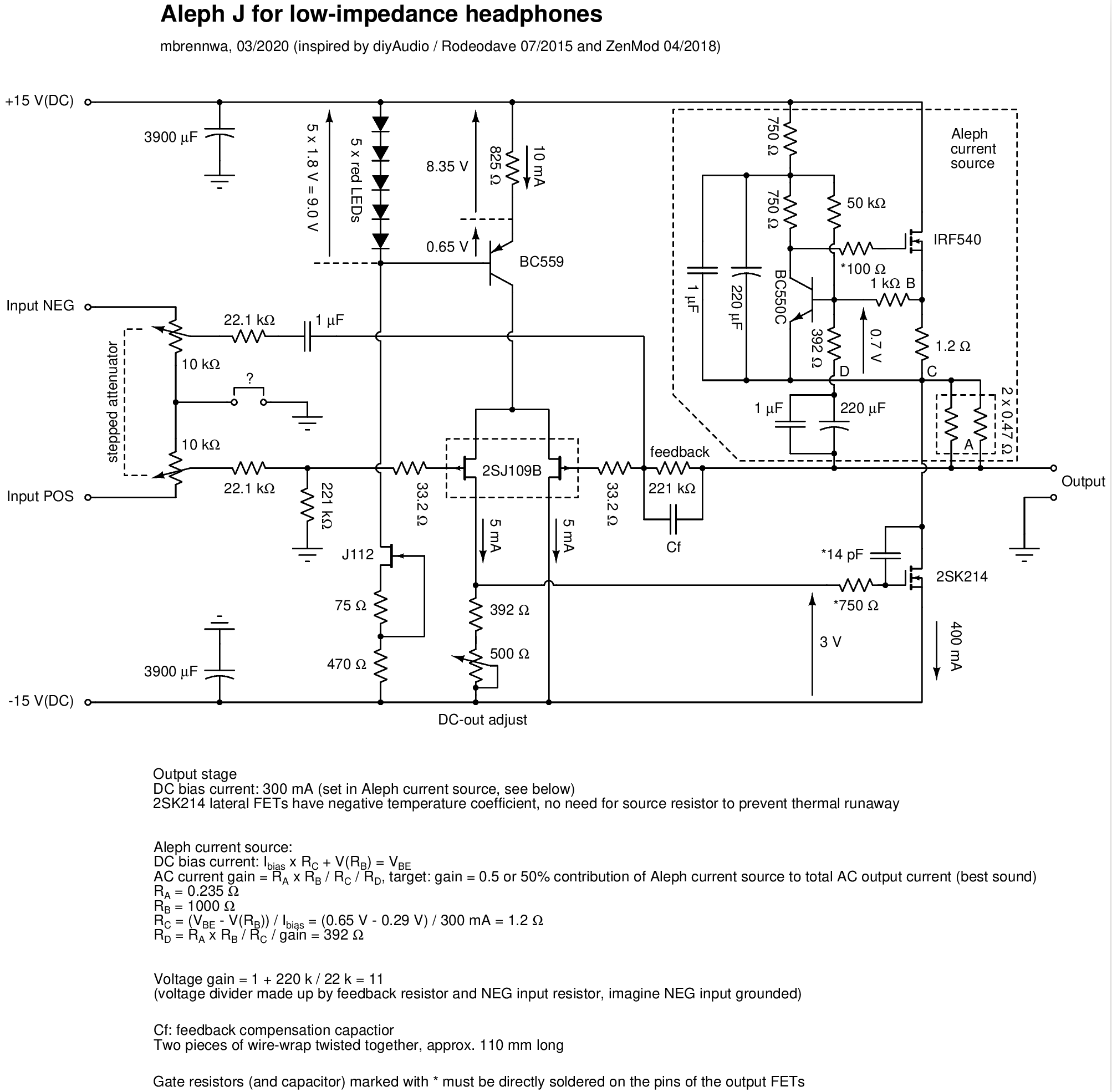

Hmmm, I am trying to get ready to start building my version of the Aleph J for headphones. I think I sort of understand most of how the circuit works. However, I am not sure about the source resistor for the gain device (R35 in the schematic shown in the first post of this thread). I see different values for this in the different versions of the Aleph circuit. I guess this has to do with (1) the bias current and (2) the output device -- but I don't know how to wrap my head around this. How do I choose a suitable value for this resistor?
P.S.: I am aiming for a bias current of 300 mA with 2SK214 output devices.

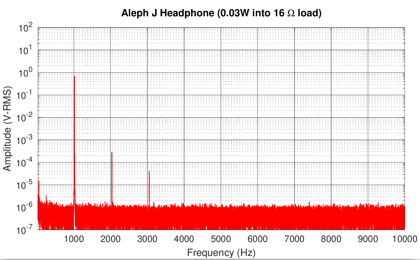

Ok, after a little bit of tweaking and some help from ZM I got the prototypes of my headphone version of the Aleph-J working pretty well. It goes up to 100 kHz (-3dB), clipping starts at 300 mW into a 16 Ohm load (ears would be gone long before that). Initial listening is good!

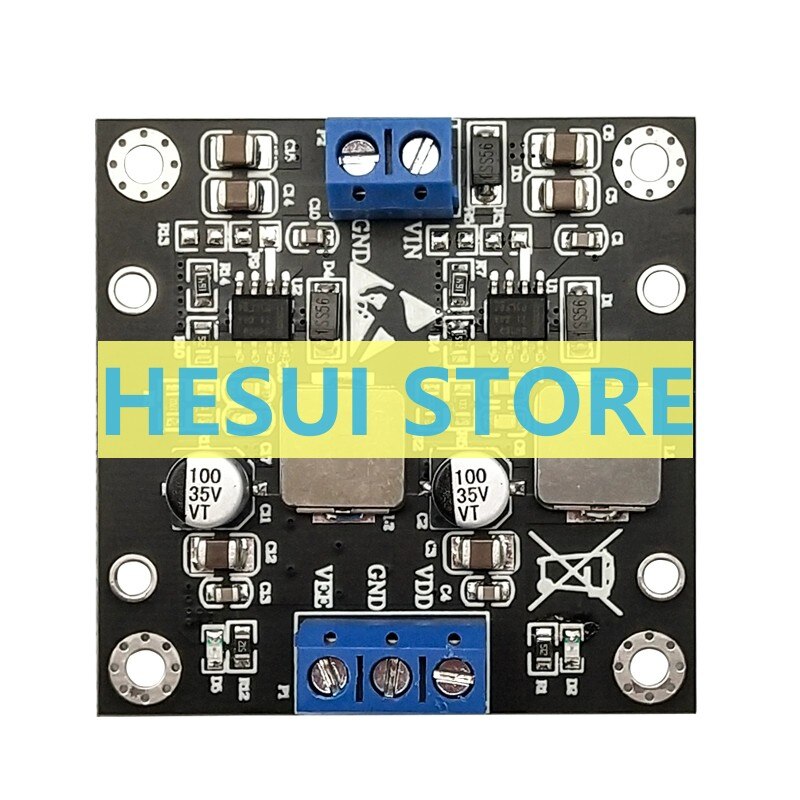

And then I came across a simple board on aliexpress, based on the TPS54360. It will take a single DC input and convert to a symmetrical output. Long story short, I fired it up today and it works. The best part is, no hum.

1 x TPS54360 board set to +/-15V
As the boards are relatively cheap (and may come in useful for other projects), I bought two. Since this is DIY and we are not afraid of overkill, I used 1 laptop smps + 1 tpss54360 for each channel

I have not had time to investigate the TPS54360 boards (besides check the output with a DMM), but it may be of interest to others.
The board I used is sold on aliexpress by a number of vendors for about US$7.
https://www.aliexpress.com/item/1005005815883872.html
Photo attached.
