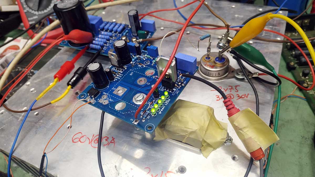

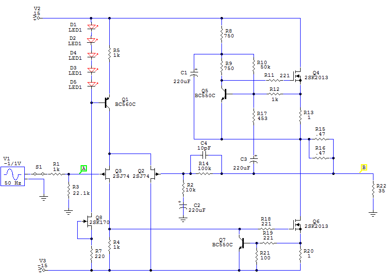

The plan is to replace the CCS Zener with a LED string fed by a 2SK170...
What is the targeted voltage across the LED string? Or, in other words, what LED type do you have in mind?
Just for the purposes of considering what the effect might be.
I am still trying to wrap my head around this. What current should be running through the LEDs? Which type of 2SK170 should be used (BL or GR)? Which type of (red) LED would work well (part number/example would be cool)?

Picodumbs: So a 2SK170 BL would be preferred over a GR?
Thanks rodeodave!
You want around 5mA give or take a couple of mA is fine.
More current is generally better but we want these things to last forever so I say 5mA is kind of a happy region.
If you get a BL then you would apply some degeneration to drop it down to 5mA. You probably want the degeneration since the jfets have a positive temp coefficient, meaning they will draw more current as they heat up, which will then affect the leds.
So yeah if we’re really considering everything a BL with degeneration is probably going to be better than a gr without degeneration in this specific case. How much better? I couldn’t guess off the top of my head, there are a lot of interacting components here.
