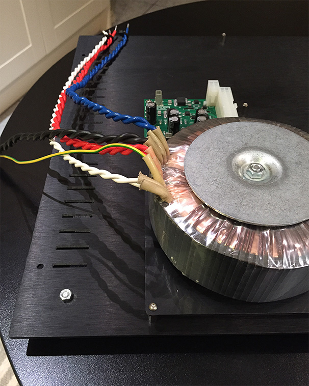

Jumping ahead a little, attached is a pic of my transformer sitting on its mounting plate which is in turn attached to the enclosure bottom. (I will likely flip the transformer up the other way so the leads point downwards.) I asked for it to be supplied with extra long leads. I need to connect the transformer at the front of the enclosure to the soft start board which is attached to the rear panel of the enclosure. Is it better practice to cut the primary leads short and do the run across the enclosure base with a heavily shielded mains cable or does it not really matter and hence I should just use the white primary wires from the transformer for the run? I'm wondering how to minimise EMI within the enclosure.
I have some 300V, 14AWG shielded mains cable (used for power cords) that I can use. Its shield is attached to a wire that can be grounded (which would, I believe, create a Faraday shield).
Also, as previously discussed the transformer shield needs to be grounded. A somewhat convenient place is the chassis ground point - again across the enclosure on the rear panel. If I use the mains cable for the run across the enclosure I can use its earth wire to connect the transformer shield to the chassis ground point. If I don't use the mains cable run and just use the existing transformer wires, is there any best practice, e.g. twisting the shield ground wire with the primaries, for running this wire?

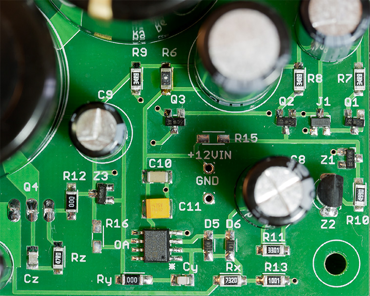

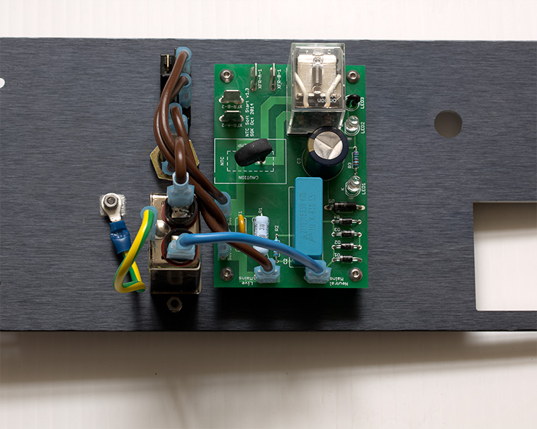

I connected up the soft start, added the transformer and measured secondary voltages. The 17V nominal secondary read 18.4V. I then proceeded to connect the 12V regulator module. The only load was my multimeter.
A wisp of smoke (and I wasn't getting 12V out) and that 'oh no' smell. In terms of obvious damage, R6 is definitely toast. Nothing else obvious. Of course, R6 is about the most difficult to reach part (lesson for the future).
In terms of trouble shooting this is there anything I should be doing other than replacing R6 and having another go? (I'd prefer not to make things worse.)

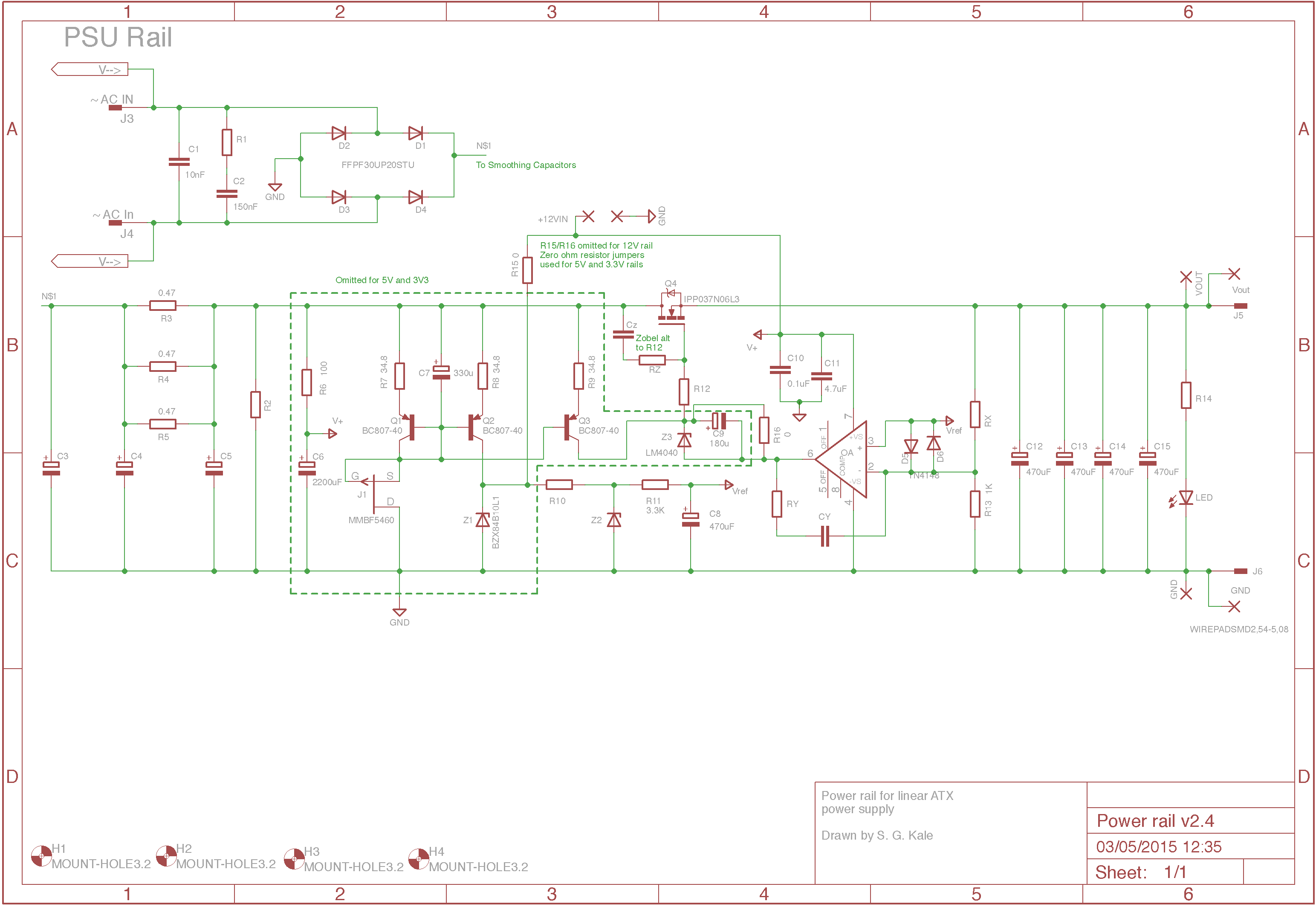

Is there any chance that the test hardware was mis-configured? Did a zero-ohm R15 short R6 to the +12VIN port, which explains the burnout? Is zener diode Z1 also destroyed?
Is C6 to blame for R6's demise? Is C6 shorted? Is it installed backwards?
Is the opamp to blame for R6's demise? It appears to me that removing the opamp from its socket won't do anything bad except cease regulating and let Vout rise up to (Vin - Vth_q4). After replacing R6 you could gingerly power-up with the opamp removed from its socket.

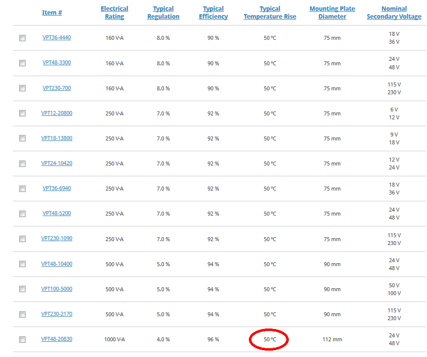

Or you can do what I did: either buy a DMM that ships with a thermocouple (like this one) or else buy an infrared thermometer (like that one).
Measure the temperature of the ambient air. Then turn on your power supply with full load on +12V and measure & record the transformer temperature every 2 minutes for 30 minutes. {a smartphone set to "stopwatch" mode helps, so does an egg timer}.
Now you have sixteen datapoints (time_since_turnon, transformer_temperature). Plot them on an XY curve. What is the final asymptote at time=Infinity? What is the "temperature rise"? Rise = (Final_Toroid_Temperature - Ambient_Air_Temperature)
Budget yourself 50 degrees Celsius or less of "temperature rise" for the transformer as a whole. 50C is pretty typical of transformer manufacturer specs, see below. For the 12VDC output {the 17VAC winding} you get (17x10) / ( (17x10) + (8x10) + (7x10) ) = 170/320 = 53.1% of the budget. When you're only loading the 17VAC winding, the "temperature rise" should be less than 26.5 degrees C, extrapolated out to time=infinity.
You may find that a curve fitting program shows an excellent match between your datapoints and a textbook classical exponential rise:

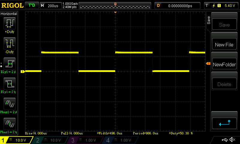

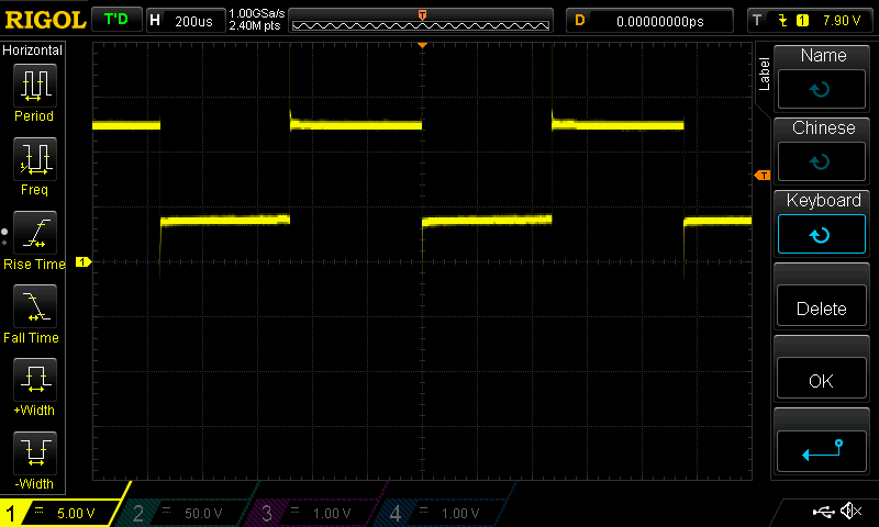

I connected the chop chop box with an 8 Ohm load and zero pre-load i.e. an easy 1.5A soft test. I'm wondering if this is what you meant previously. The gate voltage should fall to zero but doesn't appear to do so. With the load disconnected (second pic) it is fine. (Oops, note the different scales between the two pics.)
Does it manage not to thwack its own GND when delivering amperes of kaboom to its output?
It looks like there is a 3.5 volt difference between (i) the place where your scope probe touches the gate node; (ii) the place where your scope ground-clip connects to the grounding network. Furthermore that voltage difference appears not to change versus time; if it were an (L/R) timeconstant, (L/R) would have to be much MICH greater than 400 microseconds -- otherwise we'd see some slope on the logic-low.
Since Iout is 1.5 amperes and deltaV = 3.5 volts, we know there exists 2.3 ohms of resistance between the MOSFET source and the scope ground clip. If the ground clip is at the power supply input terminal "J2", this means that (RX + RZ) = 2.3 ohms in the picture below. You can leave the ground clip where it is and go probing along the ground network to find where the ground voltage drops are occurring.
Oh and if (L/R) >> 400usec when R = 2.3 ohms, it means that L >> 170 microhenries. Which is crazy; your wiring inductance will be between zero and 99 nanohenries (a factor of 1000 smaller). So it's definitely a resistive voltage drop, not an inductive voltage drop.

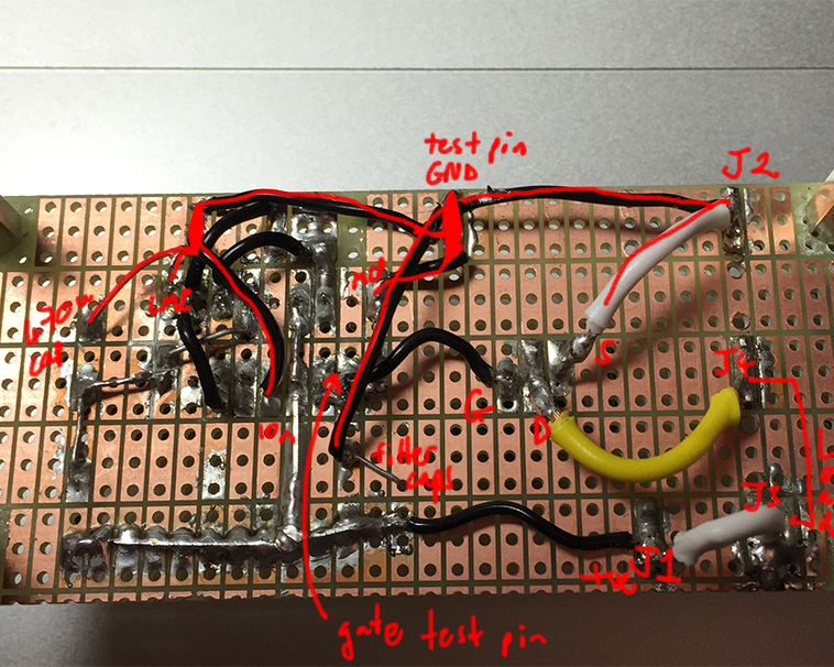

While I chew on the above*, here's a pic of my rather awful GND wiring on the actual box. Not dissimilar from your sketch, the GND connections re the LMC555 come together at one point, likewise for the MCP1407 and its filter caps which is also where I have placed the GND test pin. These are connected together. I then bring the latter to your J2 and the source of the MOSFET to J2 also.
The test pin for the gate is at the MCP1407 (pins 6 and 7).
* I'm not following. The high voltage is right at 12V. The gate's just not going to zero when low (when a load is connected).

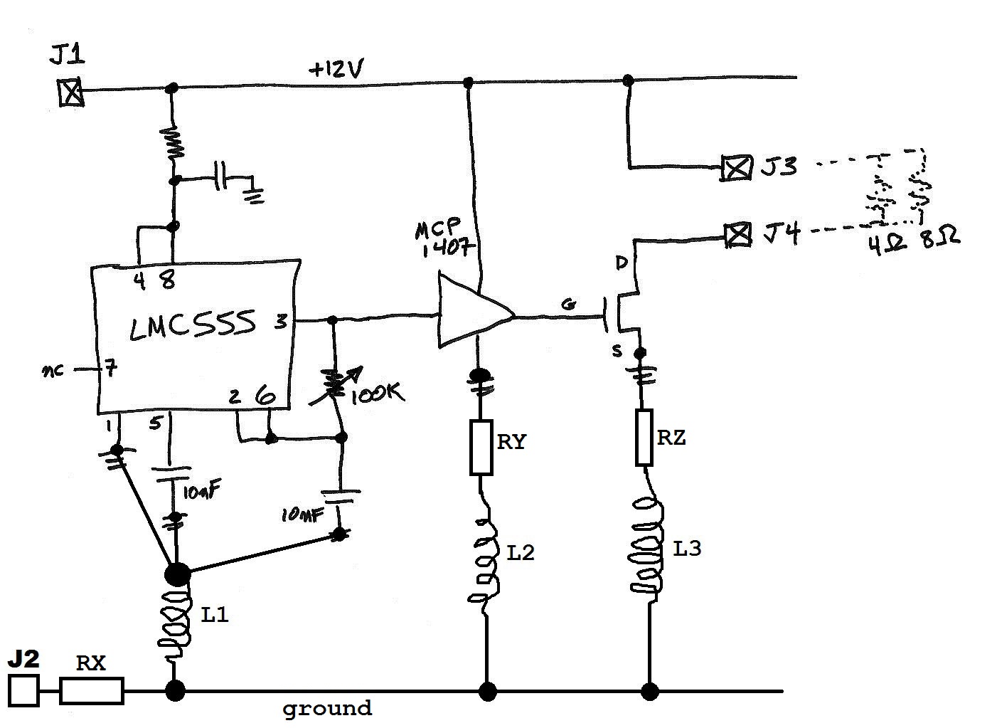

I'm struggling with this. I must be missing something basic in the following.
I am measuring the voltage potential between the junctions of pins 6 and 7 of the MCP1407 (which connect to the gate of the MOSFET) and where my alligator clip connects to GND (the confluence where I have joined pins 4 and 5 of the MCP1407 and the GND pins of the filter capacitors to the rest of the GND wires).
The LMC555 and MCP1407 have a rather simple job - charge and discharge the gate capacitance of the MOSFET. They charge it to the supply voltage and discharge it to GND. They (ought to) do this with 50% duty cycle regardless of the load attached and regardless of the current flowing through the heavy wires from supply to drain to source to GND (albeit, of course, the level of charge in the gate capacitance dictates how much current can flow).
The discharge path for the gate capacitance is via that where you have included RY. The chop chop box does all this dutifully when there is no load attached. If there were significant resistance RY then presumably we'd see the behaviour depicted in my left pic when no load is present, but we don't (chart on the right).
So when there's no load it can discharge G but can't do so fully when a load is attached. When a load is attached G remains 3.5V above the voltage at my GND test pin. I'm confused but will do some probing...
