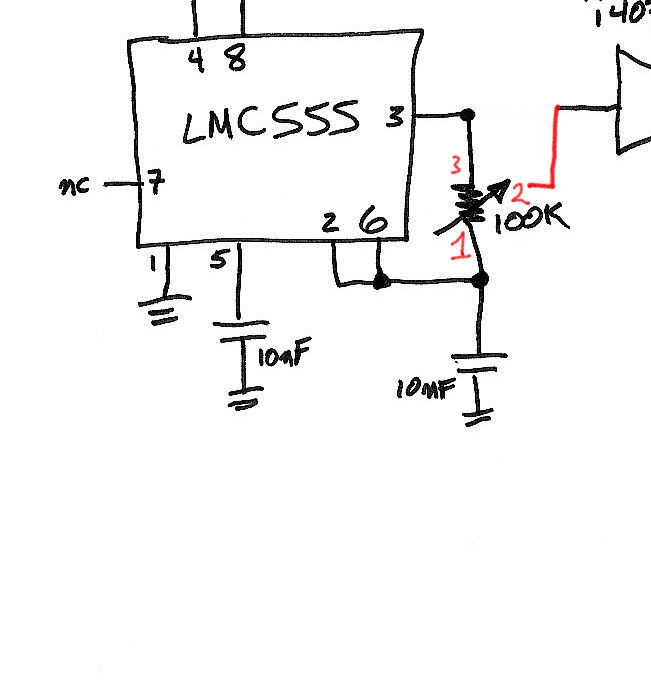

Yet another dumb question: do I have the (physical) wiring of this potentiometer correct? The lack of connection from the wiper in circuit diagrams is confusing.
Also, I see that if one were to want to display the scale for the frequency that a logarithmic pot may be more appropriate but given I won't be doing this (unlike Elvee's example) I simply chose a linear POT. Shortsighted?

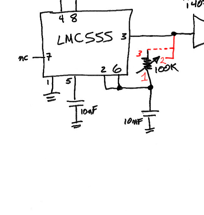

On reflection and further investigation... I understand that making the red dotted connection is also best practice. Learning painfully slowly. PSU and remaining test jig parts arriving tomorrow. I will hopefully get the chance to complete the jig but soldering the PSU rails will have to wait until I get back from a two week family vacation.

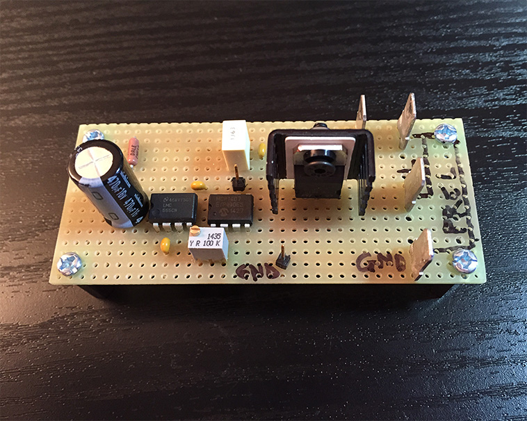

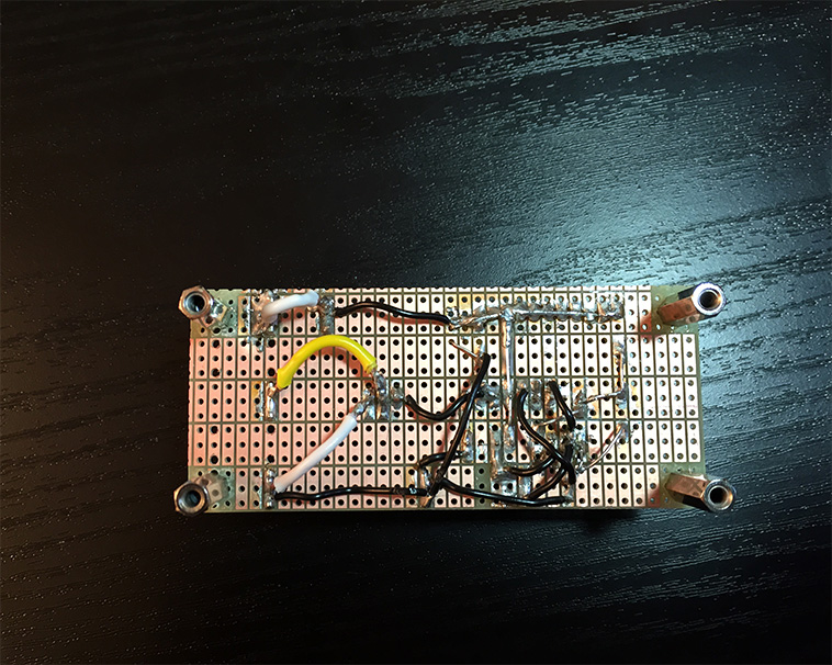

One small step closer...
Not at all my best soldering job!
Enclosure arrived today and so I now have heatsinks for testing. Enclosure looks great but I am increasingly nervous regarding the PSU!! :eek:
For some reason, for me the soldering was a pain in the proverbial.
I have only tested it to the extent of connecting a 9V battery and observing the waveform delivered to the gate of the Mosfet pass transistor. Initially it wasn't working but I found the bad solder joint. I get a nice square wave which varies in frequency when I turn the potentiometer. That was with no load attached.

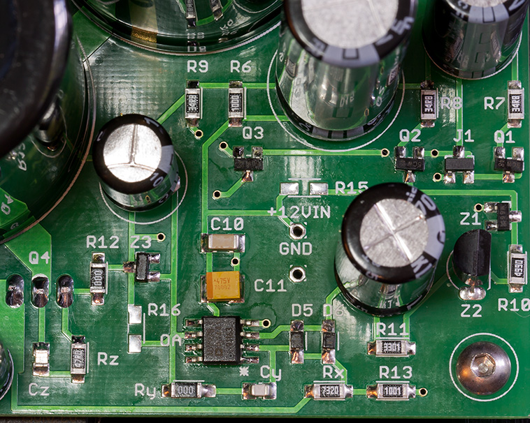

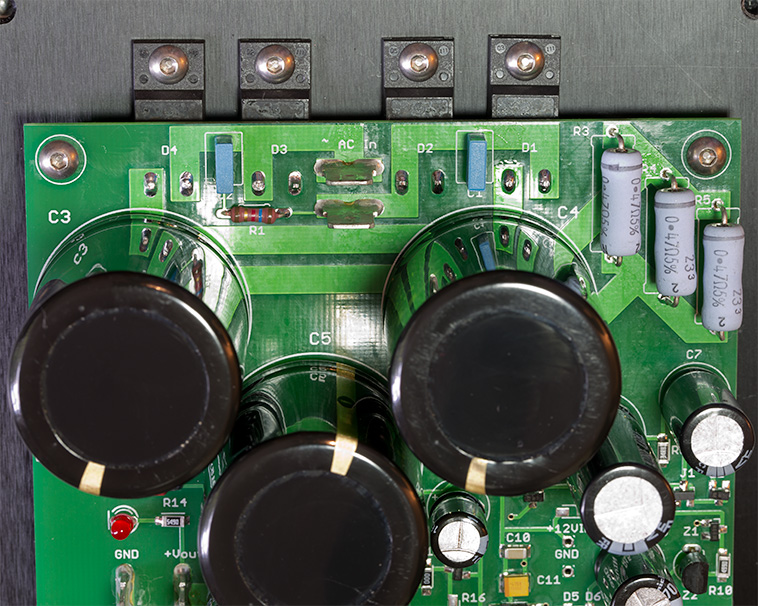

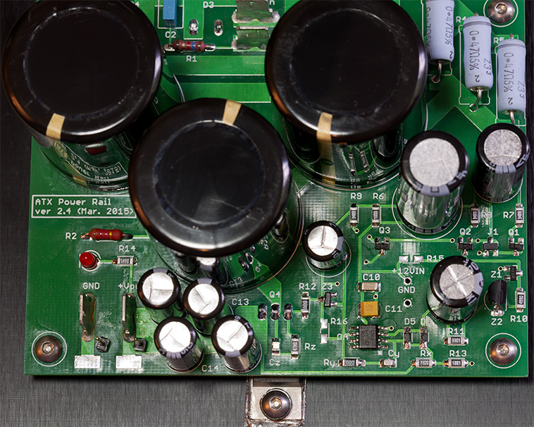

A few pics of the assembled 12V rail (Zobel at gate, Cz and Rz, rather than gatestopper resistor for now, R12). The SOD-323 diodes scared the hell out of me when I took them out of the package - tiny! - but it's interesting as were I to do the board again I would compact the SMT area of the board significantly.
I wish I could find a way to clean the pcbs a bit better. I am using Isopropyl Alcohol and a toothbrush.
