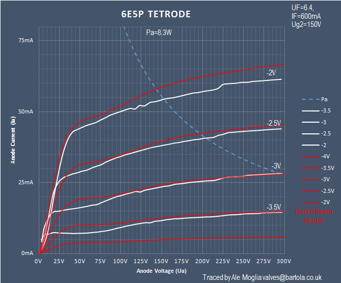

After 4 iterations and debugging of the Extract Model tool by Derk, I managed to refine the 6e5p beam tetrode model:
The valve saturates massively above 50mA so hence the gap with the model at low Vg values. Not an issue as will never be used at these levels.
Here are the details 6e5p beam tetrode SPICE model | Bartola Valves
