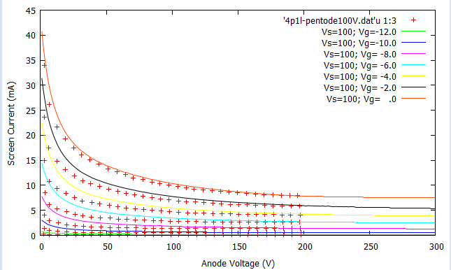

It works, albeit i found an issue when deriving the pentode curves using the pentode/triode curves which Derk is looking at the moment. However, the model can be generated.
here is a sample of the 4P1L pentode curves which I retraced again
Ale

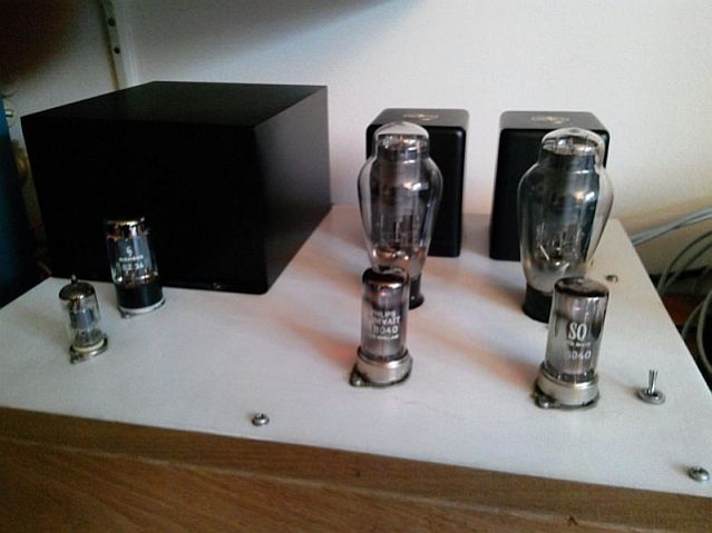

18040 once again
Jazbo8`s model for 18040 (from post no.122) is very good, say DC measurements.
I was curious to try this old Philips tube designed for Post equipments from 1950`s
I put Triode wired 18040 instead of C3G as a driver in my SET amp.
-4V (LED bias), 15mA (CCS), anode voltage is 230V one tube, and other 221V.
More than decent replacement for C3G.
Kevin, try them.

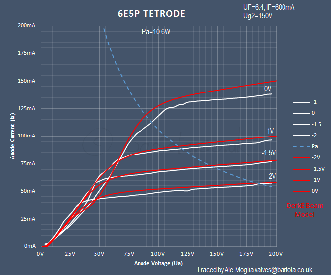

I've been exchanging some emails with Derk Reefman as a result of my debugging of the ExtractModel tool after testing many pentodes and tetrodes. Derk has kindly updated the tool (currently version 1.032) and hopefully Ronald will release shortly.
Here is an example of the challenging 6e5p russian tetrode. This high-mu tetrode is difficult to approximate with the existing models, and here is a result of the DerkE Beam Model:
It matches really well but with exception of 0V grid voltage curve at higher current values and I guess this is due to the grid current impact.
All bugs found were resolved so far. Recommendation is to plot at least 40 or 50 points within the operating area and also pick 3 or 4 Vg data sets where Vgmax is at least 4 times the Vgmin chosen so help the squares logic fit better according to Derk
I will continue doing some further tests and report.
