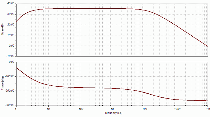

Ah, well, not terribly close.
I just noticed that the triode curve given on the RCA datasheet was for Type 30, not Type 19, so your model is actually pretty good. 😀
I had the same problem initially... 😉

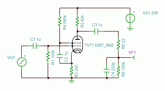

It's the incorrect version of the code. TINA uses the URAMP, not the LIMIT function... Try this one:
Code:* * Generic pentode model: 6267 * Copyright 2003--2006 by Ayumi Nakabayashi, All rights reserved. * Version 3.01, Generated on Wed Mar 22 17:22:56 2006 .SUBCKT 6267 A G2 G1 K BGG GG 0 V=V(G1,K)+0.59868749 BEP EP 0 V=URAMP(V(A,K))+1e-10 BEG EG 0 V=URAMP(V(G1,K))+1e-10 BEG2 EG2 0 V=URAMP(V(G2,K))+1e-10 BM1 M1 0 V=(0.010782364*(URAMP(V(EG2)-1e-10)+1e-10))^-0.70765893 BM2 M2 0 V=(0.67945278*(URAMP(V(GG)+V(EG2)/29.728844)+1e-10))^2.2076589 BP P 0 V=0.0013378994*(URAMP(V(GG)+V(EG2)/43.754099)+1e-10)^1.5 BIK IK 0 V=U(V(GG))*V(P)+(1-U(V(GG)))*0.00078620809*V(M1)*V(M2) BIG IG 0 V=0.00066894969*V(EG)^1.5*(V(EG)/(V(EP)+V(EG))*1.2+0.4) BIK2 IK2 0 V=V(IK,IG)*(1-0.4*(EXP(-V(EP)/V(EG2)*15)-EXP(-15))) BIG2T IG2T 0 V=V(IK2)*(0.83966688*(1-V(EP)/(V(EP)+10))^1.5+0.16033312) BIK3 IK3 0 V=V(IK2)*(V(EP)+7510)/(V(EG2)+7510) BIK4 IK4 0 V=V(IK3)-URAMP(V(IK3)-(0.00071507731*(V(EP)+URAMP(V(EG2,EP)))^1.5)) BIP IP 0 V=URAMP(V(IK4,IG2T)-URAMP(V(IK4,IG2T)-(0.00071507731*V(EP)^1.5))) BIAK A K I=V(IP)+1e-10*V(A,K) BIG2 G2 K I=URAMP(V(IK4,IP)) BIGK G1 K I=V(IG) * CAPS CGA G1 A 0.05p CGK G1 K 2.3p C12 G1 G2 1.5p CAK A K 5.3p .ENDS

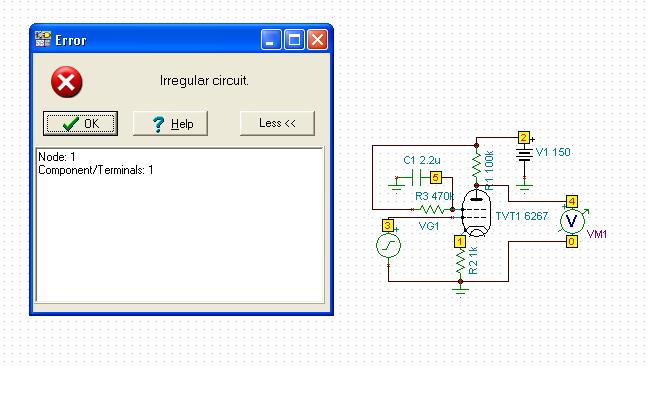

I installed the macro ok, but it does not work. I get an error at the cathode. It says it's an irregular circuit, whereas I have an EF86 model that works fine in the same location. Any help is appreciated.
I just tried it in a simple circuit with no such errors. Make sure you have the nodes in the subckt connected to the correct pins.I installed the macro ok, but it does not work. I get an error at the cathode. It says it's an irregular circuit, whereas I have an EF86 model that works fine in the same location. Any help is appreciated.
When it was building the macro, it only asked me to connect up G1 and G2. I did that correctly. The error is in the cathode. I don't have any idea why.
I can only think of two things, well three:
1. Make sure you are using the latest version (v9.0) of TINA.
2. Try re-importing the macro, just in case you missed something.
3. Make sure VG1 settings are correct.
Also the unaltered original 6267 Ayumi model (URAMP) posted by jazbo8 (post 294) will work in TINA. You have to uncheck the "Show suggested types only" box and type "tetrode" in the search box and/or choose vacuum tube from the "Shape type" dropdown.
