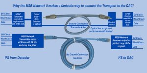

Like the picture below from MSB, they clearly tells us the existence of ground noise. However, the UFL wire we use has a ground wire. Even if it is an I2S wire, the UFL wire will still transmit ground noise. Optical has no ground, but optical will have additional jitter generated by the photoelectric conversion. This part of the MSB is wrong.
