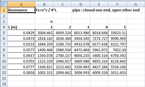

The table has calculated resonance frequencies for a typical tube that is closed one end and open the other end. There should be peaks at these frequencies and for the most part they are present in both actual and sim.

First, I need to correct a formula mistake in the table of calculated resonant freq vs tube lengths that I posted earlier. I discovered the formula mistake in my textbook (Horn Loudspeakers, Kolbrek+Dunker, pg 470, eqn 12.5.10). It is why some of the peaks were "apparently" missing when comparing the sim to the actual. I also simulated a single tube to make sure the table and sim results match (that's how I found the formula error). The avg tube length table is show below (tube dia=20mm, tube mouting plate dia=75mm).
Only the odd numbered freq multiples should have peaks. So in order to spread out the peaks using 8 tubes (from 1freq->3freq) , I used "8th root of 3" (2^0.125) as a multiplier from tube "m" to tube "m+1". I also chamfered the tube mouth to get a less abrupt termination. The "avg" length of the tube was used (mid chamfer length). This is not as good as the K-tube termination, but was just easier in CAD . I also oriented all outputs in the same direction to make it less polydirectional.
The peak spacing looks good and all 8 tube outputs are shown below. A point worth noting is the K-tube also throws sound at 45deg and progressively tilts towards axial as the frequency increases. I measured (in the simulator) at 1m and 22.5deg off axis from the shortest tube. Some of the SPL tilt is due to this effect as well as directivity increasing with freq.
