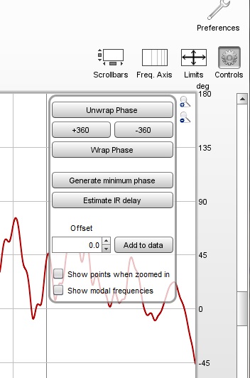

I also use version 5.19 but I can see all the graphs, the problem may be related to the JRE. In my pc the 1.8.0_181 32-bit on Windoows 10 version is installed.
You're correct. I needed to reinstall REW to get the right JRE. It must have gotten removed in one of my system updates. I can see all the graphs now and I'll compare the model to the actual measurements. Thanks @claudiogan.

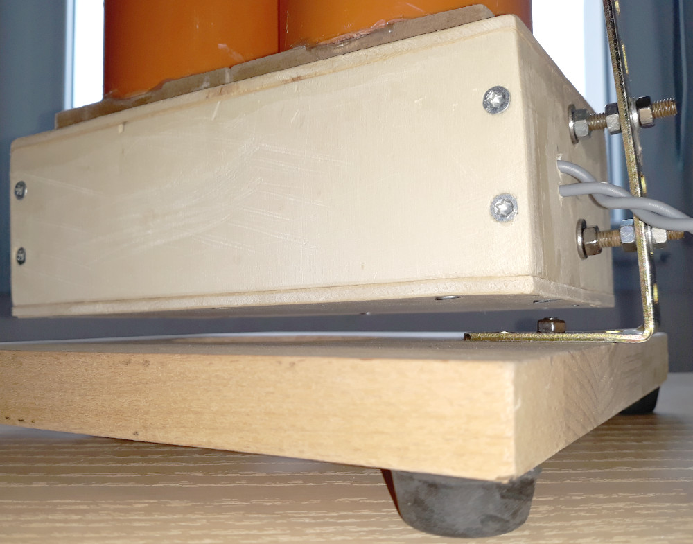

Yes, you should use a gasket to get a proper seal. I use thin (2mm) cork rubber gasket sheets and cut them to size.

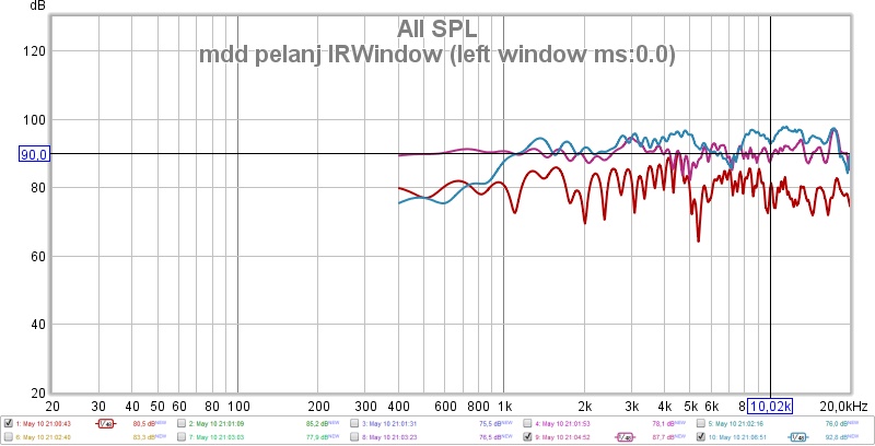

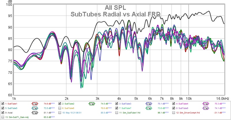

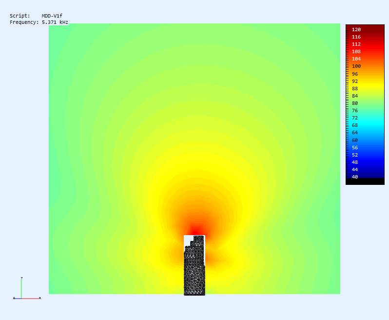

I was looking at the data @pelanj provided and these are a few comments on that data before comparing the simulation results. I made a few adjustments to the measurement data. The IR window was increased to [1,4ms] and the IR were aligned used REW [Controls\->[Gen Min Phase]->[Estimate IR]-[Remove offset] (pic provided). I only used 1Khz-16Khz because most compression drivers (including this one) have a problem below 1Khz.
The second pic has 7 radial subtube measurements and one axial. Radial measurement #6 was suspect and removed. I should add that the time gate should be OK to about 6ms where floor bounce occurs in this setup. However, I see some differences as I adjust the window (3-5ms) suggesting something else was physically near the measurement setup.
It also looks like the compression driver has a high pass filter, however it won't effect these relative comparisons. You can see radial omni behaviour from 1Khz-2.4Khz as the waveforms are in phase and similar amplitudes. You can also see increasing directional behaviour from 8Khz-16Khz as the radial amplitudes decrease with frequency when compared to the axial measurement. In between 2.4Khz-8Khz there are various phase and amplitudes suggesting interactions between the subtubes and driver.

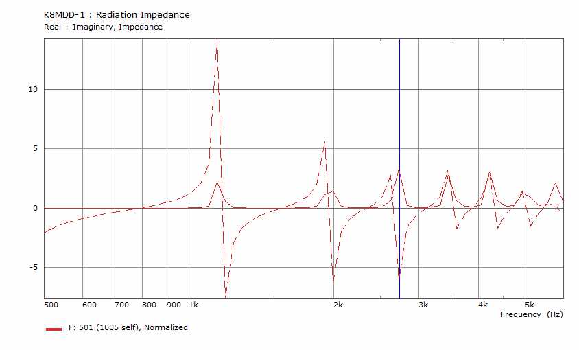

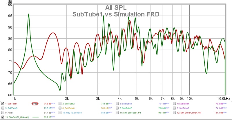

subtube1 compared to sim
This is a comparison of the simulation to the measured results for subtube#1. I adjusted the sim gain to mimic the measured compression driver gain to make comparisons easier (red=actual, green=sim). Simulated in 4Pi space with the mic at distance of 1m at subtube height.

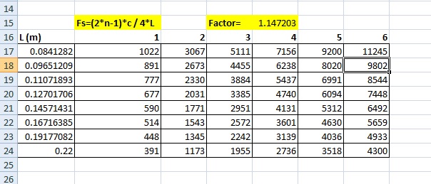

The table has calculated resonance frequencies for a typical tube that is closed one end and open the other end. There should be peaks at these frequencies and for the most part they are present in both actual and sim.
The compared results <2Khz are not so good and something is wrong here. I can only speculate that there may a leak somewhere. There is an occasional missing peak (ie 2.4Khz indicating there is either a leak or damping.
The remainder (2.4Khz-16Khz) generally has the peaks in the correct location. The sim has larger peak-peak excursions than the measured result probably because of differences between the simulation's ideal materials and real world materials.

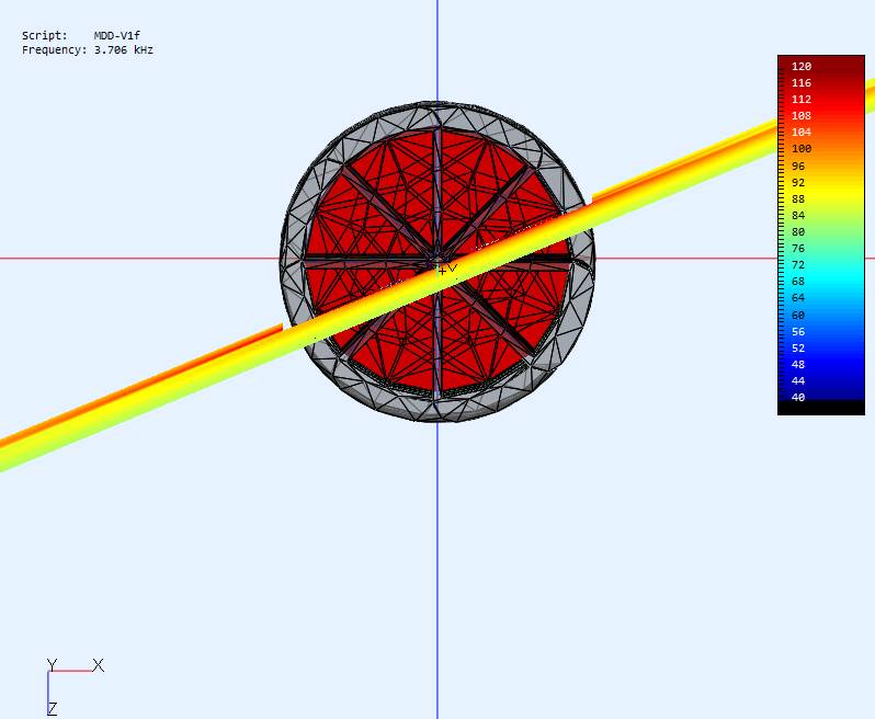

The observations field is oriented through subtube#1 (right) and#5 (left). You can compare the field patterns to see omni (1K3Hz) , lobing (2K5Hz-3K7Hz), and increasing directivity (10Khz-16Khz. This is also seen in the measured results where the radial subtube outputs are in phase (omni), lobing (phase difference) and increasing directivity (increase freq). The sim is far from perfect but it does give some behaviour insight.

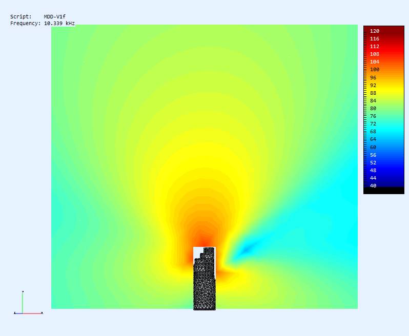

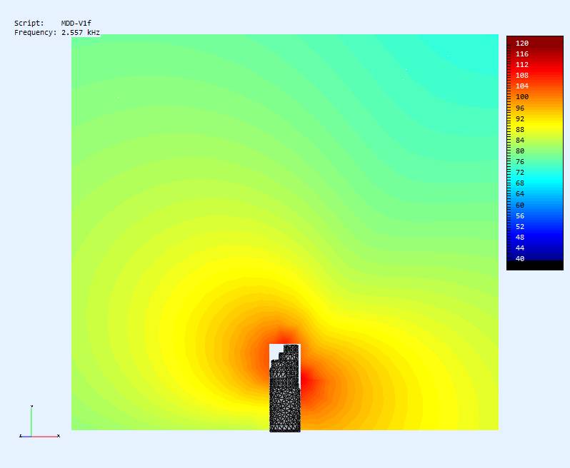

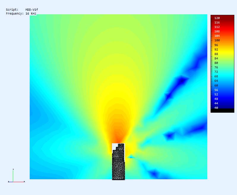

The DonVK sim is perhaps the first in which the search for the effects of diffraction rather than those of direct emission (front or rear) is the main objective. It is not surprising that there are corrections to be made, both in the model used for the simulation and in the interpretation of the measurement data, they are the results of software applications that are not optimized for the study of acoustic diffraction. The pelanj prototype can also be optimized with respect to directivity. I regret not being able to help in these searches for the moment, I can only list aspects of the system that intrigue me more than others, on which I still have ideas to verify.
The sound field graphs show the directivity but also a general decrease in the sound pressure emitted with increasing frequency. There are no dissipative parts in the system except for any turbulences created by the geometry of the waveguides. In the sim made by DonVK there is also a relationship between L / 4 resonances and filtered frequency response. With this hypothesis it is assumed that only the frequencies in resonance with the L / 4 rule can transfer energy from the driver to the listening environment.
Increasing the space between the driver and the beginning of the waveguides to 10 - 15 mm also activates the L / 2 resonances which provide additional frequencies to transfer sound energy from the driver to the listening environment. In my previous graph with the IR window = 0 msec it makes the frequency response more regular, perhaps in the sim there would be a higher emission at higher frequencies.

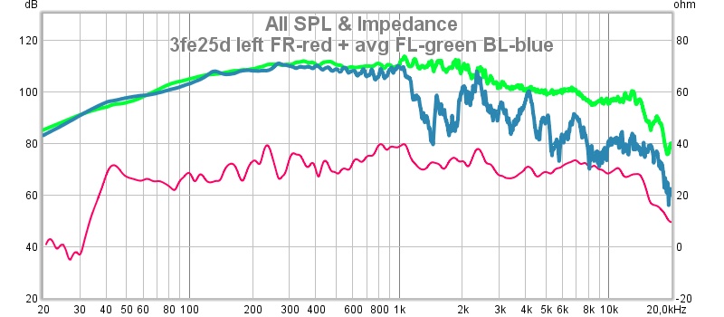

MDD3FE25d project

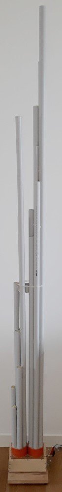

After a couple of months I managed to complete version d of the MDD3FE25 project. As expected, the increase in length of the rear acoustic load to 2 meters has improved the response to low frequencies. The time available allowed me to try various configurations for the front acoustic load, the best result is that with a front loading 23FL7d (1600 mm with resonances over 3 octaves), the maximum length is close to the maximum length of the rear loading 21BL7d ( 2000 mm with resonances on one octave). The perception of high-pitched sounds has also improved, from the measurements I do not detect the difference that is perceived when listening. The difference in distortion does not justify it, on the contrary it is just higher. Guides up to 2 meters long create more vibration and are more difficult to glue deafly. Pending confirmation or denial, I attribute the credit to the further optimized MDD effect.
In this period I realized that I underestimated the problems related to the omnidirectional emission of frequencies with a wavelength comparable with the size of the waveguides. I cannot simulate the behavior of my prototypes with a numerical model, empirical listening tests show that short frontal acoustic loads give worse results than longer acoustic loads.
The front load 23FL7d in the latest MDD3FE25d prototype is airtight and the 7 frontal emission points have the same diffraction geometry and emit over the whole spectrum. The 7 rear emission points emit frequencies up to 1 KHz. The distribution of resonances on one and three octaves makes the cabinet acoustically neutral.
For some time I will listen to music with these two meter high desk speakers which however have the advantage of occupying only 20 x 20 cm on the ground. They could also be wall mounted with a bracket and replace a driver array.
Those who want to try to make a replica do not forget that the MDD3FE25d project uses a 3 ” driver, it has many advantages but cannot generate high SPL.

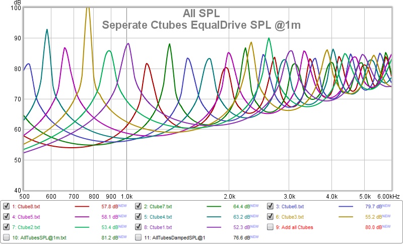

smoothing output ripple

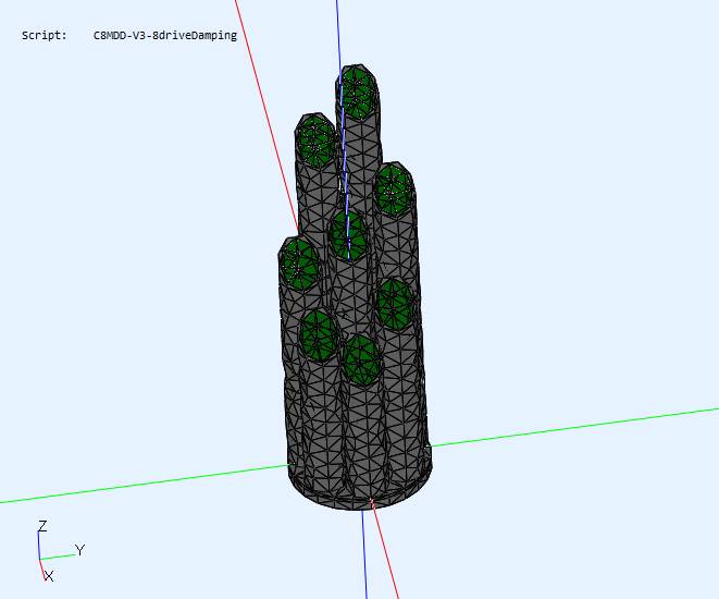

I've been thinking about a concept that was started in the K-tube thread 3D printed K-Tube for 1" compression drivers but after modelling @claudiogan's MDD concept it inspired an idea and here are some results that I'd like to share.
First, I need to correct a formula mistake in the table of calculated resonant freq vs tube lengths that I posted earlier. I discovered the formula mistake in my textbook (Horn Loudspeakers, Kolbrek+Dunker, pg 470, eqn 12.5.10). It is why some of the peaks were "apparently" missing when comparing the sim to the actual. I also simulated a single tube to make sure the table and sim results match (that's how I found the formula error). The avg tube length table is show below (tube dia=20mm, tube mouting plate dia=75mm).
Only the odd numbered freq multiples should have peaks. So in order to spread out the peaks using 8 tubes (from 1freq->3freq) , I used "8th root of 3" (2^0.125) as a multiplier from tube "m" to tube "m+1". I also chamfered the tube mouth to get a less abrupt termination. The "avg" length of the tube was used (mid chamfer length). This is not as good as the K-tube termination, but was just easier in CAD 🙂 . I also oriented all outputs in the same direction to make it less polydirectional.
The peak spacing looks good and all 8 tube outputs are shown below. A point worth noting is the K-tube also throws sound at 45deg and progressively tilts towards axial as the frequency increases. I measured (in the simulator) at 1m and 22.5deg off axis from the shortest tube. Some of the SPL tilt is due to this effect as well as directivity increasing with freq.

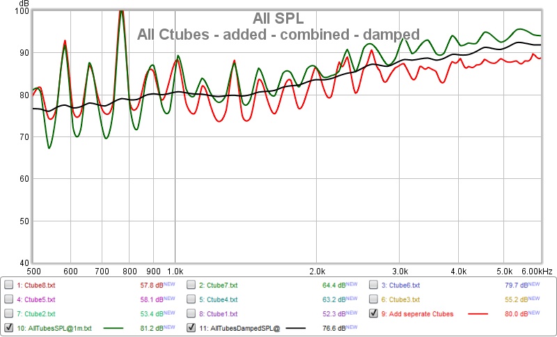

damping to reduce ripple
All the tubes were seperately driven with a constant velocity source in the graph below.
The "red" curve is a simple addition of all 8 separate tube's simulated outputs. The tubes still have relatively high Q and you can see that in the peaks.
The "green" curve is from driving all 8 tubes simultaneously (8 sources). The difference between the red and green is the effect of interaction between the physical tube openings. Keep in mind this is still 8 sources, not 1 shared source.
The "black" curve is when damping is applied to the tubes (all driven). I used D=5% Ft=1Khz which low. I'm not sure how much polyfill / fibreglass / cotton balls that is but it would be easy to put loose fill in a tube and measure the nearfield effect. Damping is also commonly used in TLs to smooth out these resonances.
In order to reproduce this from a single driver, the acoustic impedance of each tube needs to be similar because we will have 8 parallel loads on one driver. The impedance of a tube is a function of length and area ~f(L,A) . That part is next.
