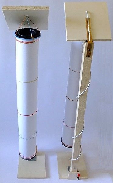

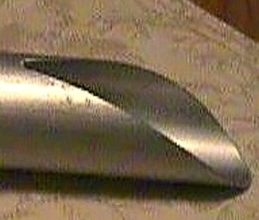

@ claudiogan
a pipe cut of the final part of the pipe made like the one in the picture, with the pipes all oriented in the same cutting direction could create a more directional sound and eliminate part of the divisions created by the walls if placed close to them?

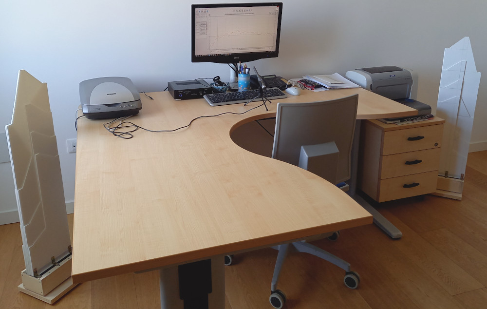

Just a note - this kind of slot is bending the sound waves of different frequencies at different angles. You can see some 3D simulations here: https://www.diyaudio.com/forums/mul...tube-1-compression-drivers-4.html#post6047971

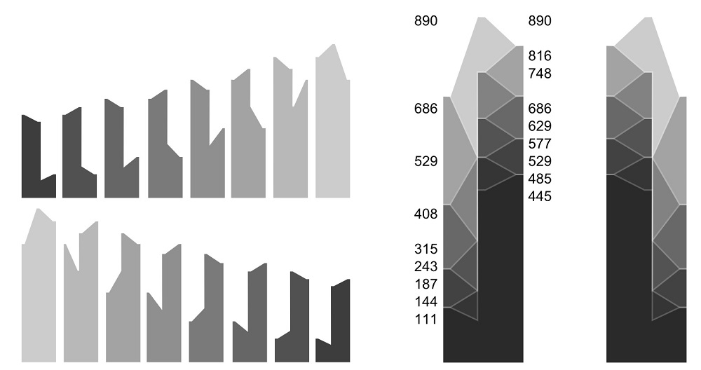

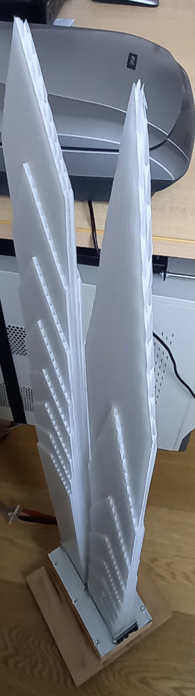

MDD3A89. A complex double acoustic load
The acoustic load of the mdd3a89 project is complex. 300 waveguides of different lengths divide the emission of the full-range drive and by acoustic diffraction generate delayed and coherent spherical wave fronts in different points of space.
The mdd3a89 project is simple to carry out, a couple of days of work. It requires less effort than projects with rigid PVC waveguides.
The mdd3a89 project is inexpensive under 100 euros for material including a pair of 3fe25 drivers from Faital-Pro.
In MDD (Multi Delays Diffraction) projects, multiple, coherent and delayed emissions aim to mask unwanted effects of listening room reflections. A path difference between two reflections of a couple of meters corresponds to a delay of about 6 milliseconds, which may be sufficient to activate the precedence effect studied by Haas. For different frequencies of the same instrument, reflections from different points could be perceived, listening can be tiring due to the need to trace different sounds to the same origin.
The waveguides of the mdd3a89 project generate delays between 0.3 and 2.6 milliseconds, the envelope of the emissions expands (it lasts longer at the listening point) and the reflections are perceived as being generated by the same origin, the fatigue of listening decreases and sound recognition is easier. Omnidirectional emission with the multiplication of possible paths and further reduces the possibility of activating the precedence effect.
The 300 waveguides are distributed between front acoustic load (MDDFL) and rear acoustic load (MDDBL).
The wave guides are obtained by gluing 8 appropriately shaped 5 mm alveolar polypropylene panels. In the same panel, about 20 wave guides are obtained for the front acoustic load and 20 wave guides for the rear acoustic load. The alveolar polypropylene panels are elastic and light, they can vibrate by interacting with the sound waves reflected by the walls of the room. To reduce the phenomenon I have placed the loudspeakers at a distance of 60 cm from the wall and with the panels inclined by about 45 degrees.
The length of 890 mm determines the maximum delay of 3 milliseconds. By extending the lengths proportionally, the delay interval increases, strengthening the MDD effect, and the frequency response also extends downwards.
How does it sound? Best of all previous MDD projects. Compared to the 34c9 with similar dimensions the frequency responses and distortion measurements are similar but I definitely prefer it.
Anyone wishing to build a pair of MDD3A89s should not forget an adequate running-in. I used a pair of 3FE25s purchased in 2018 and stored in the box for two years. In the first two days the high frequencies were reproduced considerably attenuated. Now after about ten days the sound quality seems to continue to improve or maybe I am getting used to the sound.

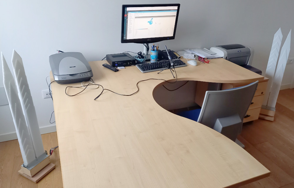

From 2009 to 2013 I used JB3 direct radiation loudspeakers which were much more expensive than the T-Amp DAC I wanted to use at school for a liquid music practice. I tried to make a TL with cheap components.
One of the first attempts made was integra001, a TL prototype that did the opposite of the normal recommendations used on DIY sites. The waveguide in cardboard about one meter long vibrated throughout its length, the bass was reduced but despite this I preferred my prototype to the JB3, they had some other flaws. I have attributed my preference to the presence of secondary waves which facilitate the recognition of sounds.
In the last few prototypes I was able to extend the bass response while also improving the perception of details.
The closure of the driver in the MDD3A89 prototype is apparent. The front acoustic load has a total section at the entrance of about 26 cm2. The rear acoustic load has a total section at the entrance of about 32 cm2. They are not very different from a TL or horn configuration. In the path inside the waveguides, the losses are minimal, I do not use damping material, only air. At the exit of each wave guide, the diffraction phenomenon is exploited without appreciable losses.

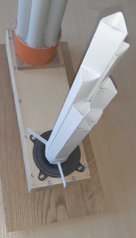

In the MDD3FE25a prototype part of the direct emission of the 3FE25 was sent to the listening room, I did not detect any loss of efficiency by switching to the closed front acoustic load of the MDD3FE25d prototype. The closed and elongated front load greatly increased the perception of details, even of the lower frequencies reproduced.
With the MDD3A89 prototype I even have the problem of keeping them detached from the back wall, in some tracks the bass notes resonate with the room and are too prominent.
I am convinced that the latest prototype MDD3A89 is great for appreciating the excellent qualities of the Faital-Pro 3FE25 driver.

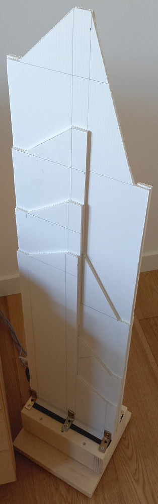

MDD3B89 another improvement in MDD technology
A further improvement over the mdd3a89 project with greater detail and ease of listening. It remains to pay attention to the positioning, excessive proximity to the wall highlights too much sustained low notes. The upper band should be slightly increased. I will not make any changes, I already have new configurations in mind.
The mdd3a89 project has the problem that the lateral forces applied to the alveolar polypropylene panel are not symmetrical, spurious vibrations are generated which can be detected in the reproduction. In the measure of the distortion I cannot highlight the effect, while listening it is evident. In the mdd3b89 project the front acoustic load is separated from the rear acoustic load. Both acoustic loads use 16 honeycomb polypropylene panels 2.5mm thick and shaped to tip. The tolerance of manual processing is about 1 mm, within this error all lateral forces are considerably reduced compared to the mdd3a89 prototype in which there were differences of several cm per project.

If I had these answers ready I would probably also be able to commercialize MDD technology.
Now I'm working with 5mm honeycomb polypropylene. Compared to the MDD3FE25d project the sound is more detailed even if there are no variations in the distortion graph. It could simply be the gluing of the guides with flat surfaces instead of circular ones that eliminates spurious vibrations. It could also be the timing of delays.
The lengths I have chosen and the configuration adopted in the MDD3A89 and MDD3B89 projects make the frequency response irregular, -10 dB between 3 and 10 KHz. When listening I have to keep the speakers away from the walls to prevent the bass from covering the rest. Despite the attenuation, I can hear more details even on the highs. With a little bit of testing, I should be able to regularize the frequency response while maintaining the current detail.
For the resonant frequency, the length of the waveguides in the rear acoustic load matters above all. In the MDD3FE25d project with a maximum length of 2 meters the first impedance maximum is at about 47 Hz. In the MDDHX135-42 project with a maximum length of over 3 meters and the first impedance maximum is at 33 Hz. In the MDD3A89 project with a maximum length of .89 meters the first impedance maximum is about 70 Hz.
I have not yet made sensitivity measurements but I believe that keeping the total surface of the guides similar to the area of the speaker cone there should be no significant losses.
For the 5FE120 driver I would do a test with the measurements of the MDDHX135 project, the rear load waveguides extended up to 4 meters and wrapped in a cubic box style subwoofer. To reproduce 30 Hz or less it is necessary to bend the waveguides one or more times, they must be longer than 2 meters.
