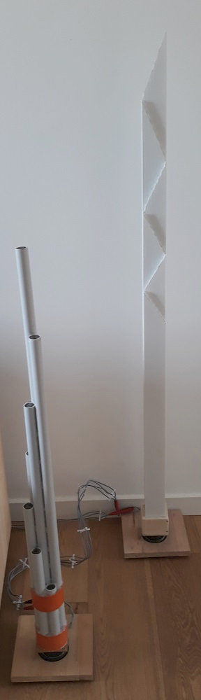

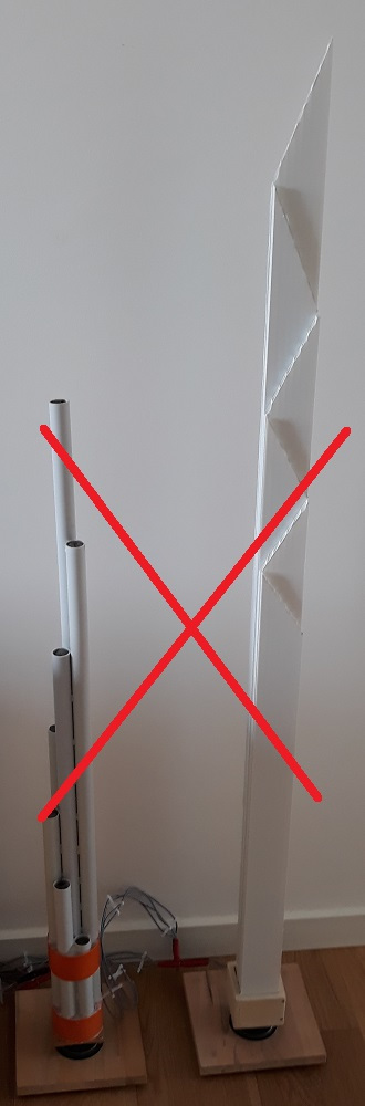

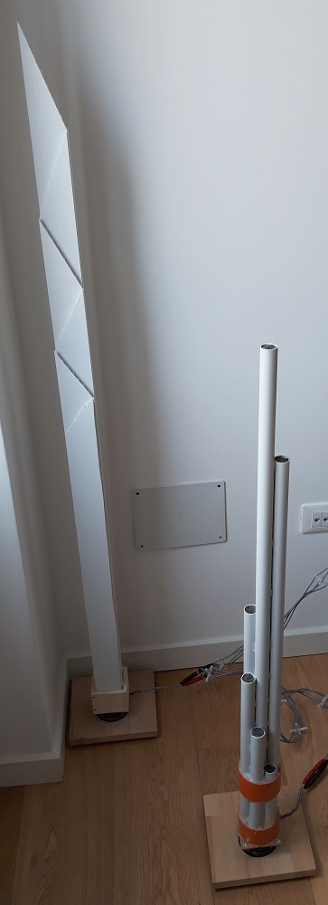

Hello Pepe
the simplest way to make satellites omnidirectional is to replicate the MDDFL 21FL7 front load. Seven rigid PVC waveguides are positioned raised 10 mm in front of the speaker cone, the length is progressive in a logarithmic series (276, 305, 336, 371, 410, 453, 500 mm). If the satellites are to be placed on a desk, it is better to halve all the lengths, avoiding to send the energy of the high frequencies above the listener's head.
The rear load can be a sealed-box, a bass-reflex, a TL or an MDDBL rear load chosen from the MDD projects on the site. With a maximum length of 1000 mm it reaches 80 Hz, with 2000 mm at about 40 Hz.
To increase the perception of the 3D effect of coherent, omnidirectional and delayed secondary waves, the acoustic loads are positioned by imitating the shape of the letter "J". The short side of the J corresponds to the front load MDDFL, the long side of the J corresponds to the rear load MDDBL. The two groups of waveguides are connected at a distance of 300 - 400 mm, in this configuration the emission points are also spaced in the direction of the depth and not only in height. The distance in the lateral direction is ensured by the presence of the two stereo channels, right and left.

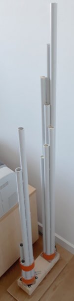

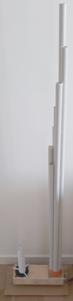

MDD3FE25c: 23FL7(227H) + 21BL7
The MDD3FE25c prototype is an important step forward in MDD technology.
In the prototypes MDD3FE25, MDD3FE25b and MDD3FE25c the length of the open frontal acoustic loading varies, from 294 mm 21FL7, to 640 mm 22FL7, to 1070 mm 23FL7. In percentage terms, the increase between the first and second prototypes is greater than the increase between the second and third. Listening to the third prototype is much better than the other two. The difference is not due to the very similar frequency response or distortion, but to a specific aspect of the MDD technology.
In projects with double acoustic load: open front MDDFL and closed rear MDDBL I optimized the frequency response as if it were a mechanical and acoustic two-way independent system. In the time domain, the two acoustic loads generate two series of 7 sound fronts in successive and separate time intervals, one in phase and one in counterphase. The hearing must elaborate two series 7 of temporally separated sound fronts and reconstruct the origin of the sound which can be the same instrument.
In the MDD3FE25c prototype, the longest waveguide of the front loading 23FL7 (1070 mm) is comparable with the length of the shortest waveguide of the rear loading 21BL7 added to the base (774 + 250 = 1024 mm). In this case, in the time domain, the two sets of delayed sound fronts are partially overlapping and require only one processing, the recognition of the sound is simplified.
While listening to the previous prototypes, there remains a series of information that the listener cannot instinctively trace back to a specific instrument of origin. I thought it was the effects of residual speaker distortion.
In the MDD3FE25c prototype, the recognition of the sound is simplified, the lost information is traced back to minimal changes in the timbre of the instruments or to slight modulations of the sustained notes. The acoustic scene is simplified and increases the realism of the instruments reproduced, some words that were previously confused become recognizable, in the tails of the songs you can perceive sounds of minimum level that previously escaped. In this situation the residual distortion of the speaker does not disturb listening, at this moment I prefer the reproduction of the MDD3FE25c prototype to that of the MDDHX135 prototype which uses a speaker 10 times more expensive.
The MDD3FE25c prototype further reduces the sound decoding time, increases the time available to the listener's imagination and also increases the listening pleasure.

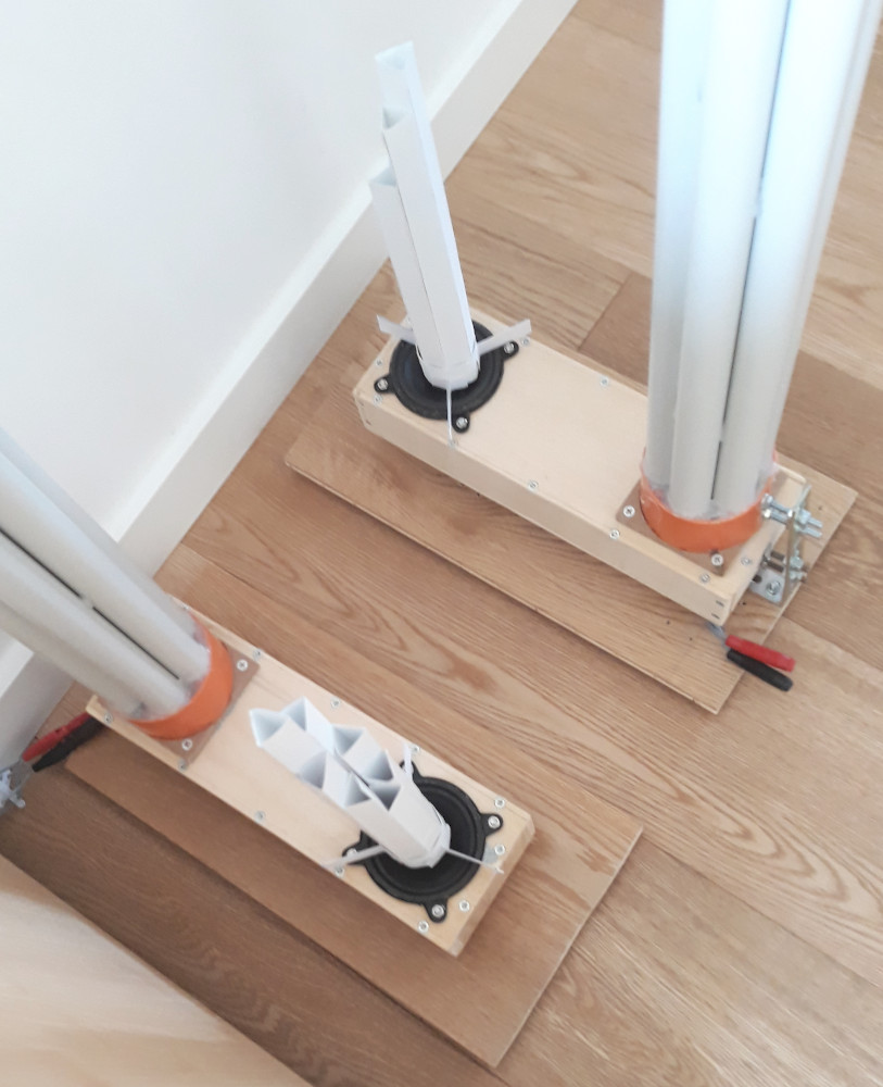

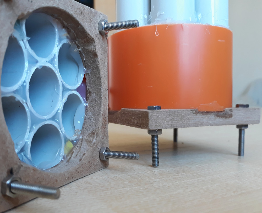

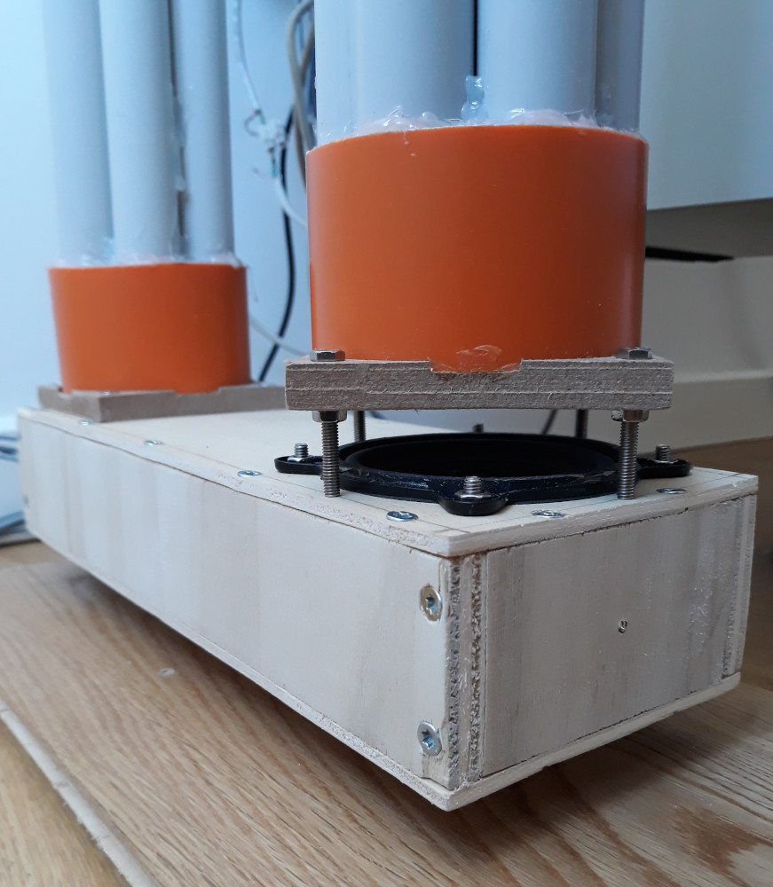

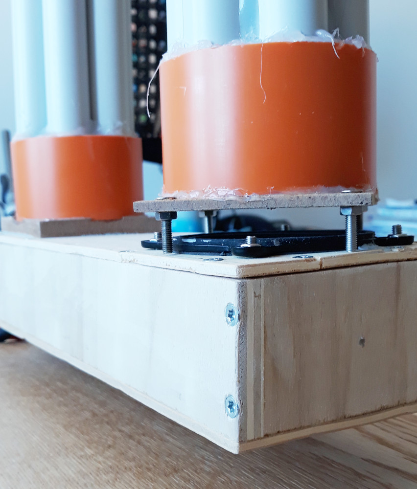

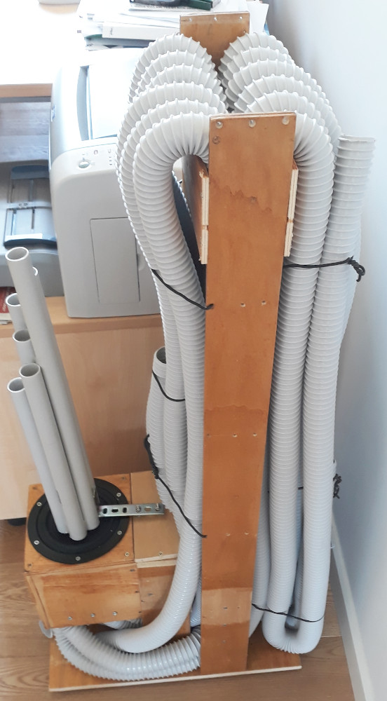

Maybe I missed something, but what is the reason for the lower box being so long? Could the front and back pipes be closer together and the back pipes longer? I will be printing new holders for my Al tubes and scrap the wooden ones if they turn out well. I ordered some more 3FE22 drivers so that I can try the dual arrangement - in Al and 3D printed holders.
Also, with 3D printing, all the tubes could be most probably arranged into one tower - 5x5 tubes with any number of them fed by the back of the driver and the rest by the front of it (e.g. 12 by front and 13 by rear). I think that would look awesome, would that work acoustically?
3D effect

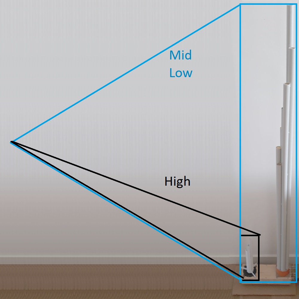

Hi Pelanj
the base is 300 mm long to give depth to the sound scene. At the end of the page 54m42 - MDD project with alveolar polypropylene pipes. Version: Medium. I summarized with three photographs the best arrangement for a configuration with double driver and double acoustic load.
The double acoustic load is intended to optimize the frequency response. A group of waveguides use length and airtight assembly to best reproduce the low notes, MDDBL. The other group of guides is open, shorter and makes the house omnidirectional even at high frequencies, MDDFL.
If the MDDBL and MDDFL acoustic loads are positioned at the same distance from the listener, the sound image is 2D, you also reported it for your prototype with the 3FE22 driver, https://www.diyaudio.com/forums/ful...irectional-range-3fe22-build.html#post5959726.
By placing MDDFL closer to the listener, the sound image gains depth, it seems to me that listening improves as it is possible to attribute a virtual volume to the instruments reproduced. I call it a 3D effect and I appreciate it when listening. The configuration with double driver has already been created and customized also by Kec.
In the frequency domain, a compact base on which to mount MDDBL and MDDFL would have similar response and distortion measurements of a longer base.
In the time domain things change. With the longer base, the listener is able to perceive sound waves emitted in closer or more distant points, simulating a virtual volume of a musical instrument that emits sound energy in multiple points of 3D space simultaneously. These are not substantial differences but nuances. As a comparison, I think about the choice of fonts in road signs, changing a font means that in certain conditions of poor visibility, the probability of correct reading of the information increases. If you like a piece of music, it will continue as you like or vice versa. In optimal conditions, more details can be recognized.
In the MDD3FE25 project the compact base works well, I recommend it if the loudspeaker should be inserted in a furniture and must have a well-groomed appearance. If I want to experience the best possible sound with a driver, I prefer the longer base.
The 300 mm for the moment are the only test done, it could be even less but I haven't tried it yet.
