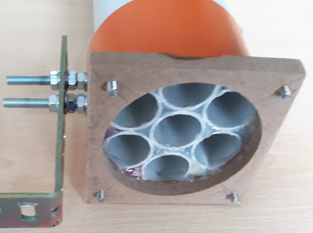

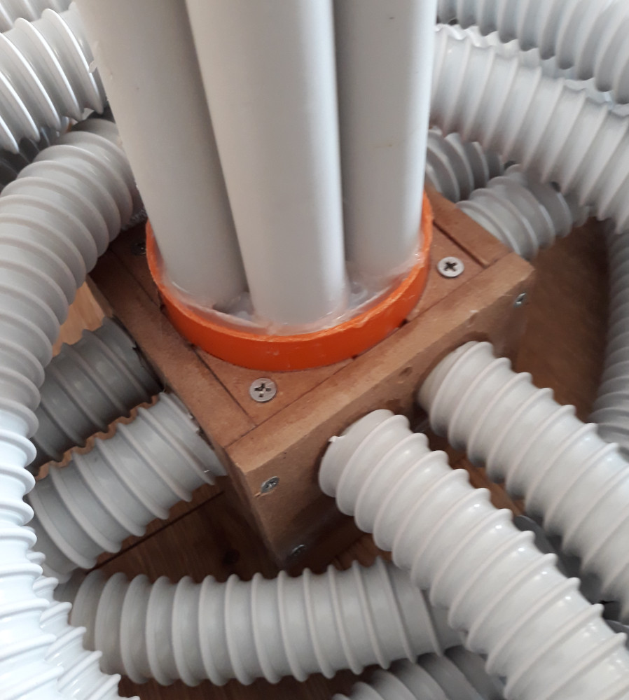

In the 21M7 project, the internal diameter is 22 mm, the outer diameter 25 mm and the PVC thickness is 1.5 mm. The tubes are used in electrical systems, already cut at 2 or 3 meters.Claudio, what is the internal diameter of the PVC pipe you use?
For a quick test you can use a pack tape as a flange.

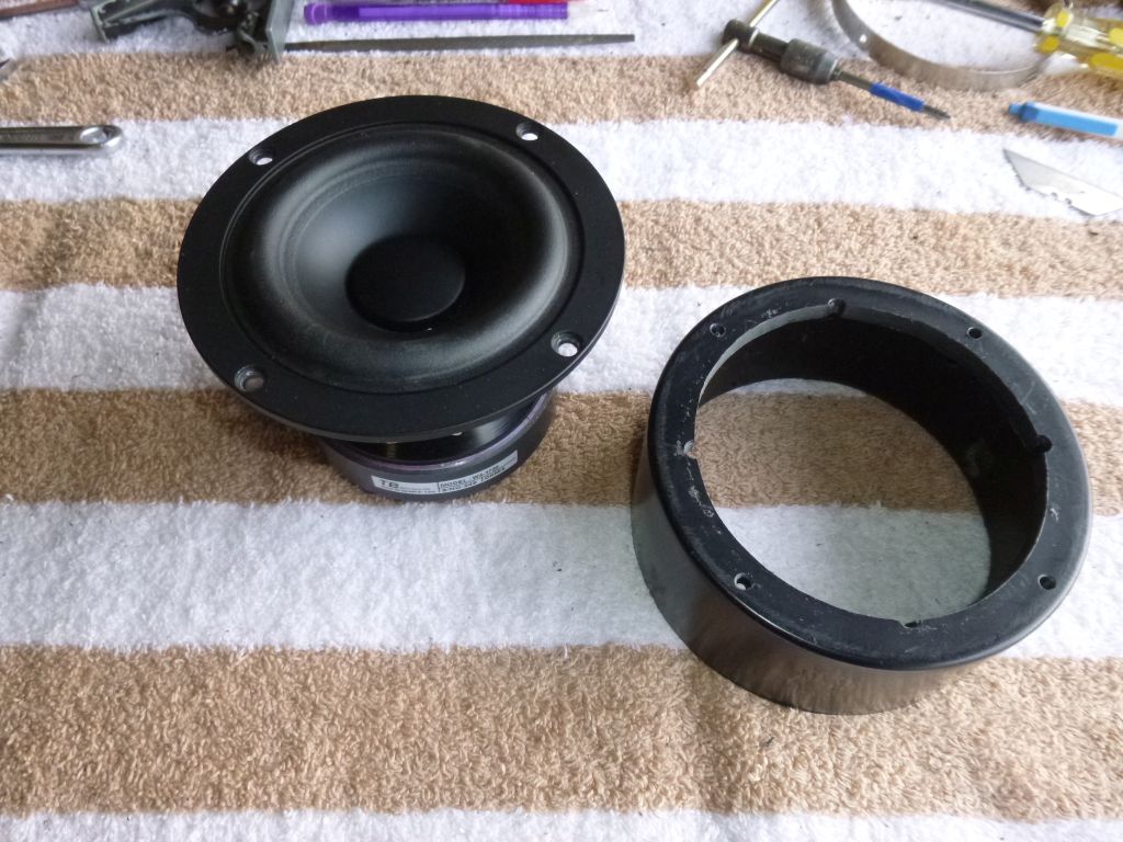

It is convenient to use 3D printing only to build the connection flange between drivers and pvc pipes. With a euro you buy a 25 mm x 2 meter tube for electrical installations. It is easily cut to the desired size and you can save tens of hours of 3D printing.

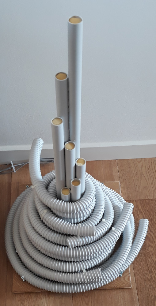

22C71L8 an MDD project
Premise, do not take into consideration the appearance of this new 22C71L8 project, it will change.

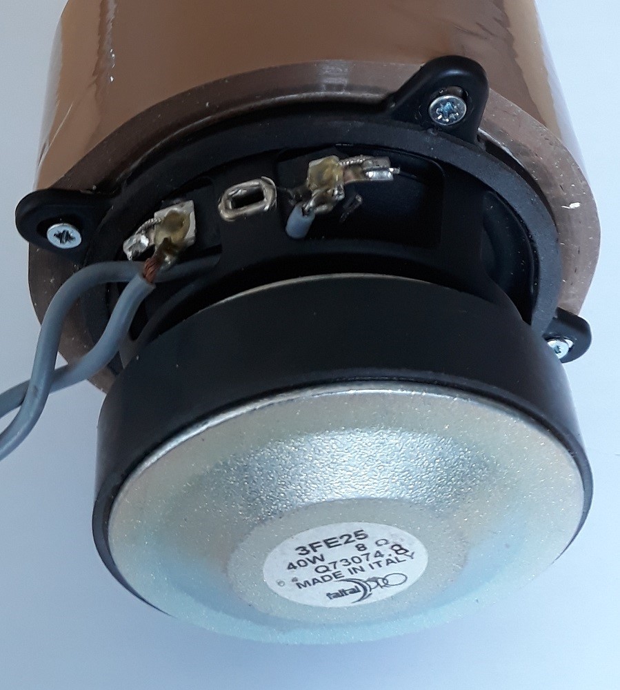

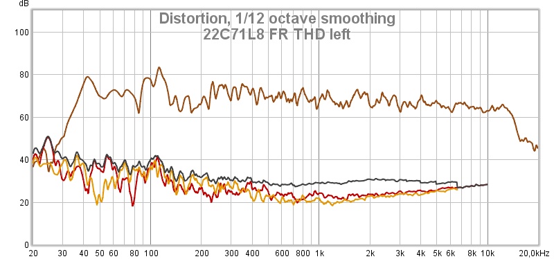

The acoustic characteristics are very good:
- 40 Hz to 0 dB with a 3" Faital-Pro 3FE25,
- omnidirectional on the whole audio band,
- almost full-range 40 Hz - 15 KHz,
- reduced distortion up to 80 dB SPL,
- coherent emission points in a three-dimensional volume.
link: 22C71L8

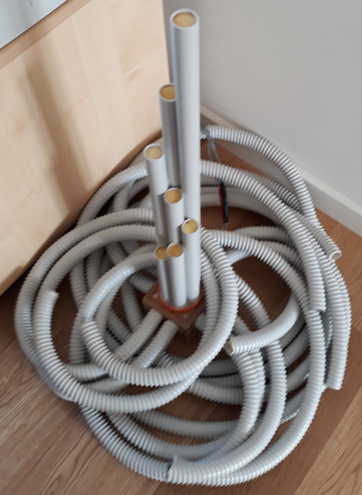

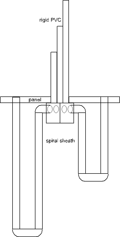

Alien loudspeaker🙂 I wonder if the multiple pipes at the back are really necessary - maybe a single stuffed line or horn would give enough LF extension. I still plan to try that one day.
To extend the low frequency response I thought of both an air suspension and a rear transmission line. In both cases the response at low frequencies would improve and could be calculated with simulation programs.Alien loudspeaker🙂 I wonder if the multiple pipes at the back are really necessary - maybe a single stuffed line or horn would give enough LF extension. I still plan to try that one day.
I have renounced the air suspension for the generation of internal reflections and the loss of efficiency due to the masking of the rear emission.
With single TL rear loading, an acoustic load could be calculated that exactly compensates the characteristics of the speaker but could not take into account the interaction with the listening environment.
The use of multiple TL has some advantages.
The frequency response at the various points of emission in the listening room changes and you listen to the sum of signals that statistically partially compensate each other.
The emission of coherent signals in non-coplanar points increases the realism of reproduction. I use the expression: 3D effect.
The cost of the spiral sheath is minimal, 20 euros for 30 meters. Unlike a wooden TL in a specific installation with the 22C71L8 project, some waveguides can be lengthened or shortened to equalize the frequency response at a point in the listening room.

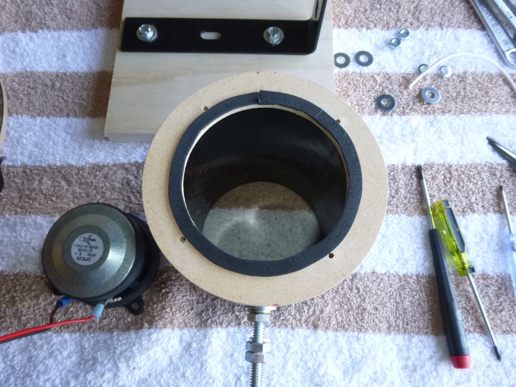

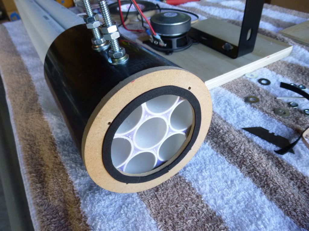

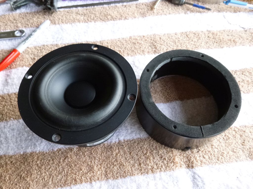

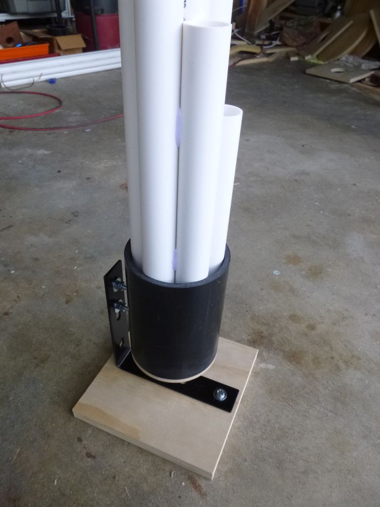

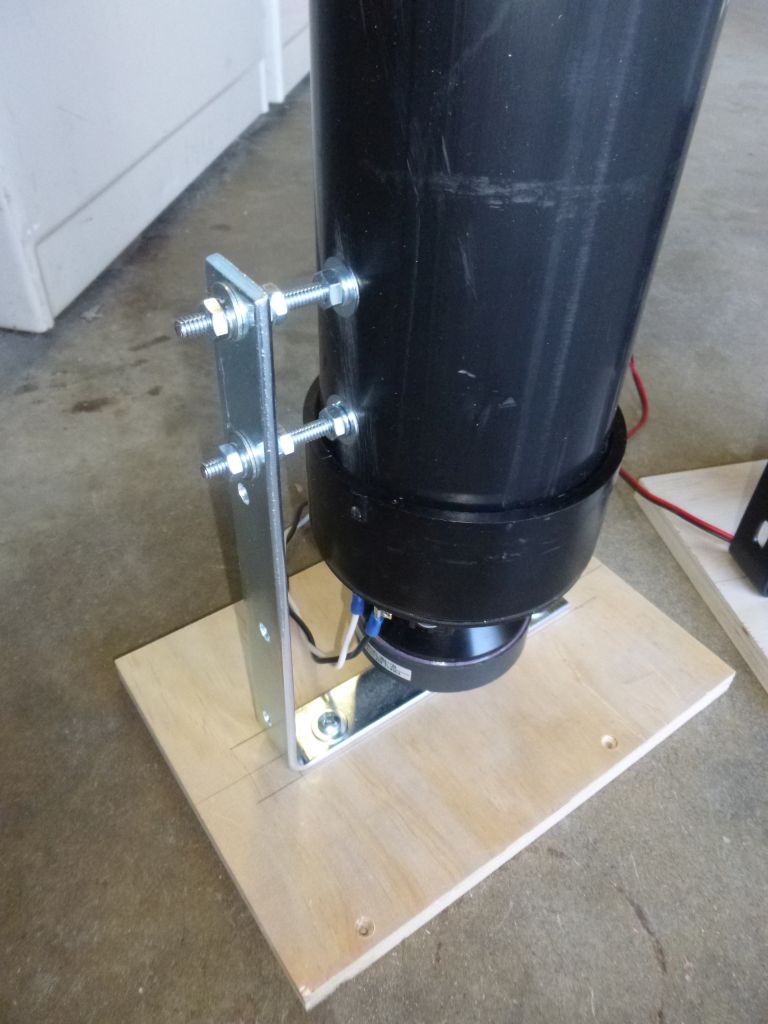

I finally got the 22C7.V2 up and running just before the end of 2019 😀
Previously, I was going to build the 21M7 until I saw the 22C7.V2. I deviated from the 22L7 (bass section) to use a Tang Band W4-1720 4" woofer in TL arrangement - ABS 4" plumbing pipe 55" long. I've been listening to this setup for 2 days now and am very impressed.

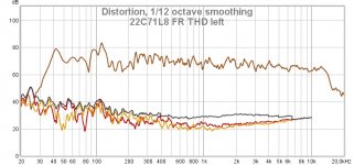

I am in difficulty if I have to judge the quality level reached by my prototypes. I have no experience with top-level devices, I don't know if and when I will make a Hi-End prototype, I don't know if and when an MDD loudspeaker will be on the market. I hope other DIYs will try and talk about their impressions. The first attempts seem to confirm that the relationships between costs, time and performance are already very good with the prototypes already published.
I agree on filling the room with sound energy, localization is a possible secondary effect. When listening to a live concert or band music, it is still difficult to locate the origin position of all sound.
The low frequency "sequester" I would call it the transfer of acoustic energy from the cone to the listening environment. With an open waveguide you cannot hope to violate the need for a length greater than L / 4, if you want to reproduce the 20 Hz you need 4-5 meters in length. For now I have reached 2.4 meters, about 40 Hz.
The unconventional aspect of the non-conventional MDD technology is mainly linked to the need to use easily available material for carpentry, plumbing and electrical systems. With a workshop and suitable software available, development times would be much shorter and the appearance would be more appealing, unfortunately they are out of budget.
MDD neutral cabinet

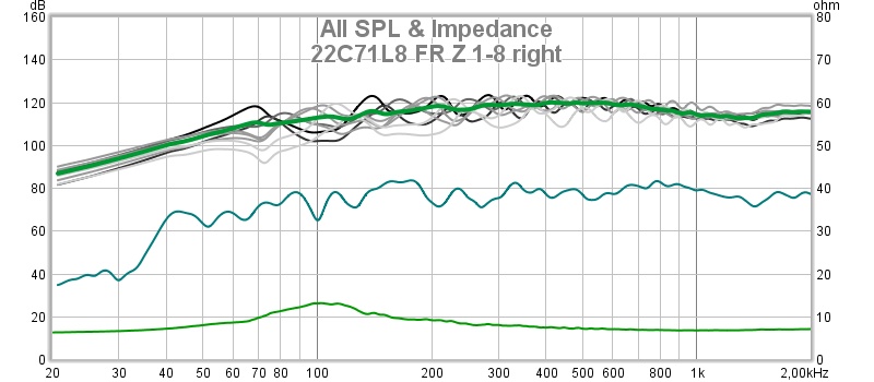

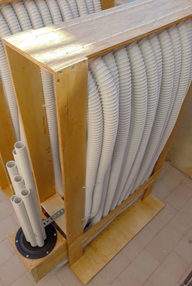

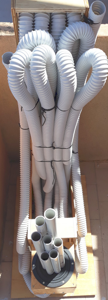

I made the second version of the 22C71L8 project, I fixed the spiral guides to a wooden table and rigid guides. It is now transportable and usable for a series of measurements with the microphone at the exit of the flexible guides.
With the graphs it is possible to calculate the mathematical average of the frequency responses which highlights the neutral behavior of the loudspeaker at low frequencies.
More photos at the address: 22C71L8
More information on the neutral cabinet at: acustica MDD projects

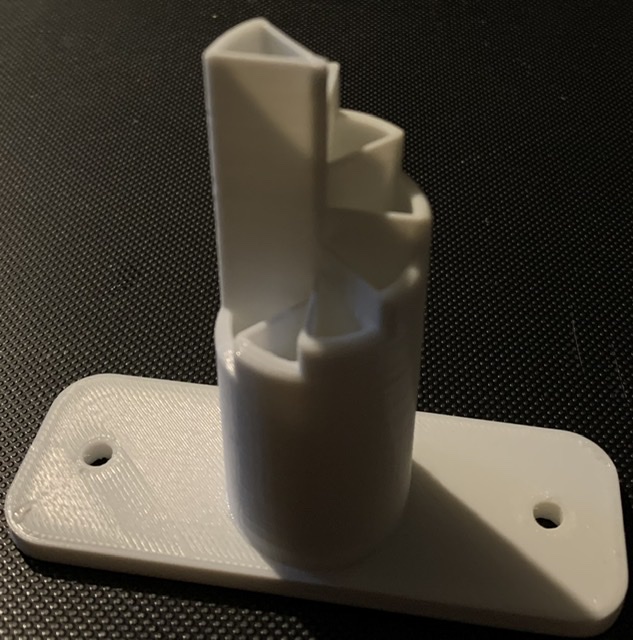

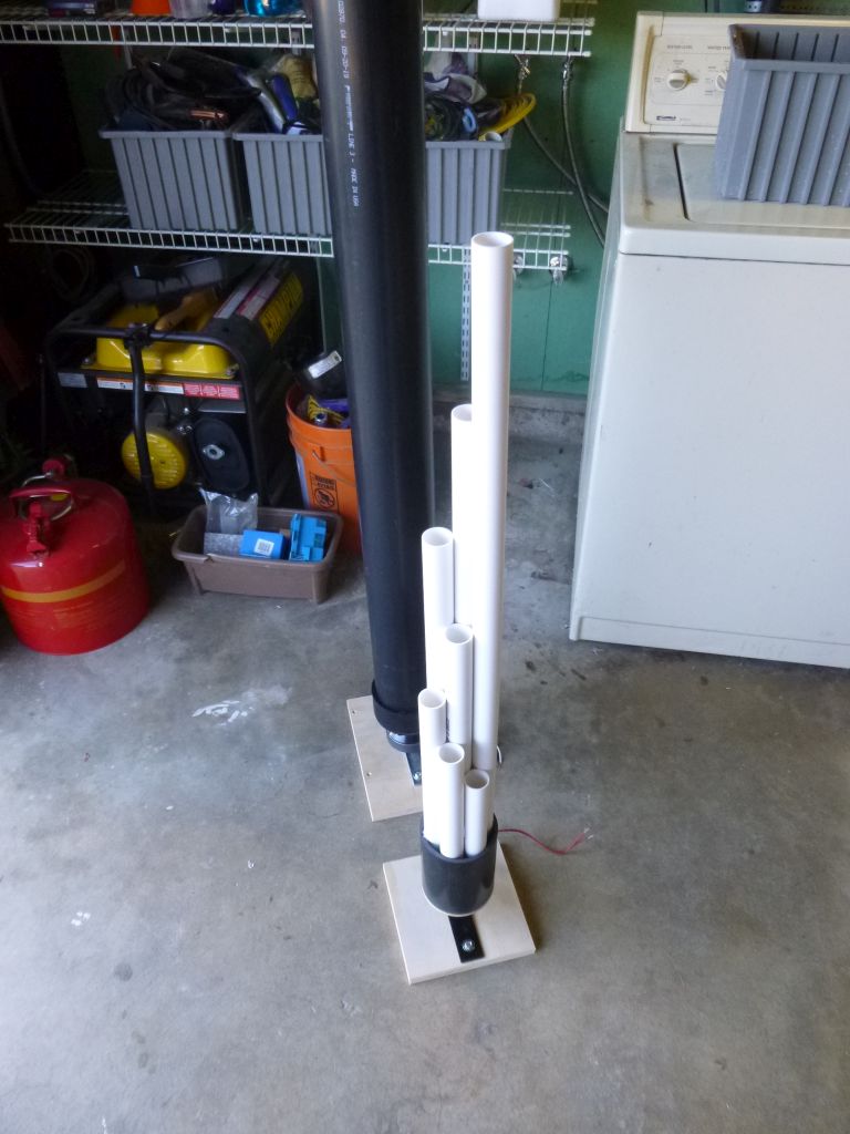

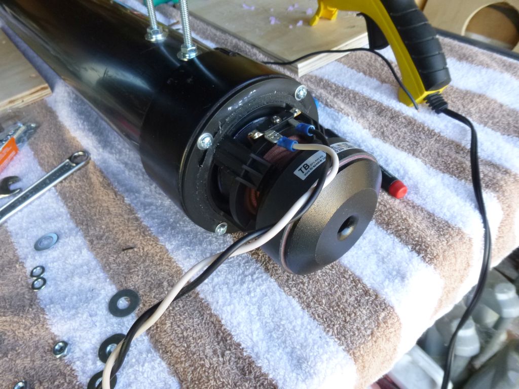

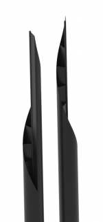

MDD attachment for compression drivers
I wanted to try out 3D modeling of the MDD as a proof of concept. I yet have to think about how to make the spiral, but the steps look OK. I printed that scaled for a 1" compression driver, the overall length is 85 mm. Once I have some measurements, I will post them.
As another idea, I wonder if MDD type fullrange speaker could be used in a trunk of a car, where the openings would be placed above the back seats. I need to try that one day too.

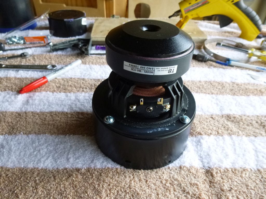

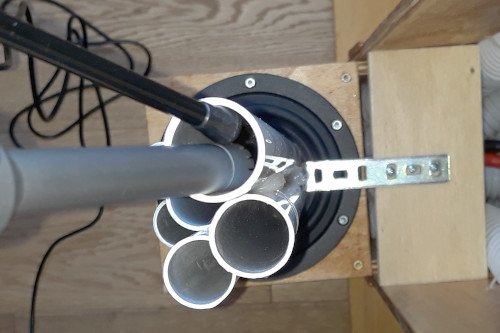

MDDHX135 an MDD project with the HX135 driver
In the MDDHX135 prototype I apply MDD technology to a discontinued Ciare HX-135 speaker. With previous projects I think I have reached the limit of the potential of the excellent 3FE25 of the Faital-Pro, I decided to experiment with the best speaker I have available.
The HX-135 cost about 10 times more than the small 3FE25 and at first glance you can perceive the difference. The first impression is that of a greater extension to the ends of the band, less distortion and greater listening pleasure. I plan to take a series of measurements within ten days.
Most of the time it was used to build a frame that supports the MDDBL rear acoustic load made with spiral sheath for electrical systems. The frame also supports the horizontally mounted speaker and the MDDFL frontal acoustic load, which is very simple to make.

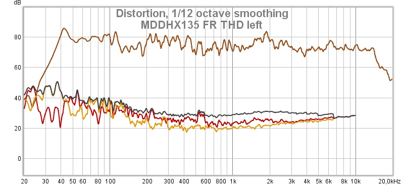

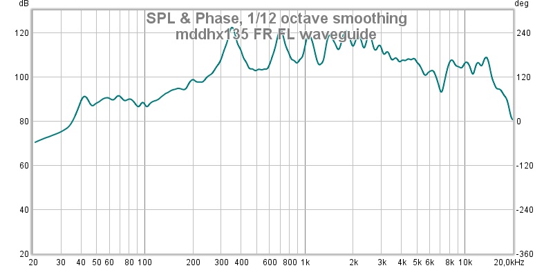

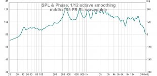

I published the measures of the MDDHX135 project.
link:
Claudio Gandolfi - MDD (Multi Delays Diffraction Loudspeaker)
MDDHX135
MDDFL
MDDBL
link:
MDDHX135
MDDFL
MDDBL

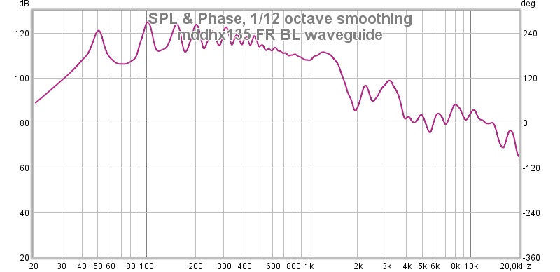

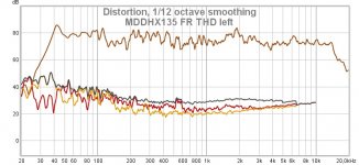

MDDHX135-LV (Lockdown Version)

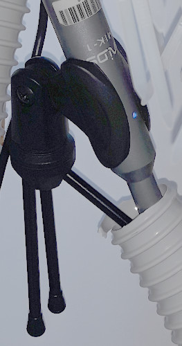

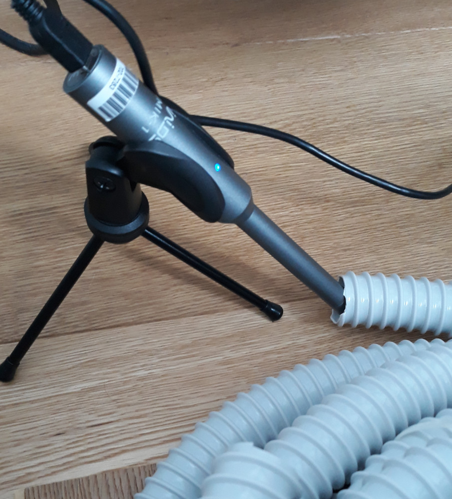

I made the measurements on the MDDHX135 prototype in my studio, I found myself in the situations of those who move to a better place in the theater but are worse off because of the presence of annoying neighbors. In my case I was annoyed by the excessive dimensions (1000 x 760 x 360 mm) in a 4 x 4 m room, also after 15 days the smell of the solvent contained in the impregnating agent was still excessive. I reconnected the 22C71L8 prototype and continued listening to music with that.
For the impregnating agent, I left the prototype outside without the speakers for another week. For the size I arranged. Stuck in the house for the covid-19 emergency, I could not buy and have the wood cut to size, I had finished the electrician clamps. I cut parts of the frame freehand and instead of the clamps I used rigid copper cable.
I used the only abundant resource: time. If I hadn't been stuck in the house I wouldn't have used a couple of days to get a result like the one shown in the pictures, a prototype destined to be dismantled with the normalized situation.
I moved the speaker cube back and moved the waveguides back. It is clearly seen that the frame is undersized to support all the spiral sheath. The only bulky part of the prototype is the rear one which is positioned close to the wall. The visual footprint is much smaller than before.
How does she feel? Well very well.
I will not make measurements on a prototype destined to be dismantled (I hope soon). Those already published on the same page remain valid, they also contain measurements with the microphone positioned at the outlet of each waveguide.
More photos at the links:
MDDHX135
MDDHX135

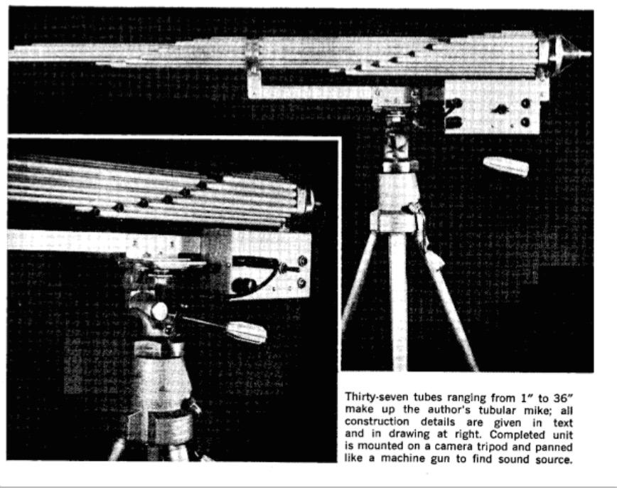

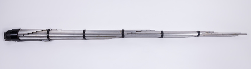

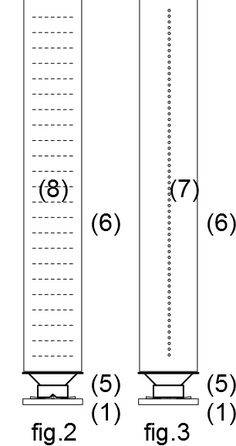

I'm struck by the similarity of this to Harry Olsen's (RCA) original design to increase microphone directivity, by placing a bundle of tubes of progressive length in front of the microphone element. That design was superseded by the now familiar interference-tube "shotgun" microphone, which substitutes a single tube with multiple holes or slots along its length for the bundle of tubes. Some designs use a single tube formed from a material which provides a specific acoustic resistance through the wall of the tube, such as a tight-weave metal mesh.
Experimenters here might similarly try a single pipe with holes or slots along its length, a tube which is "acoustically porous" formed from a mesh, or a tube with a slot running along its length.. which then begins to bear similarity to Karlson tube designs.
This image too large to attach-
https://digilab.libs.uga.edu/scl/files/original/2dc753ad6cd22e015cdfd7387eecdd2a.jpg
Harry Olsen's (RCA) microphone
thanks for reporting a microphone that I didn't know existed. The structure of some MDD speakers (22C71L8 - 21M7 - 21FL7) and this microphone are very similar, it is the mode of use that makes them very different.
With MDD technology, most of the sound energy emitted by the speaker enters the waveguides, passes through them and is reissued by acoustic diffraction with coherent, delayed and omnidirectional wave fronts.
In Harry Olsen's (RCA) microphone a small part of the energy of the sound fronts in the environment enters the waveguides, only that emitted by a source in line with the waveguides can be detected by the transducer. Sound energy does not come out of the waveguides. The result is an extremely directional microphone.
The presence of multiple guides in the MDD technology and in the Harry Olsen's microphone (RCA) derives from the fact that a single waveguide has minimum and maximum frequency response in the frequency domain. The frequencies of the minima and maxima depend on the length of the waveguides, with more waveguides of appropriate length the minima and maxima compensate each other and a linear frequency response is obtained.
The single tube with multiple holes is a configuration that I have already tried and proposed in the patent application (now abandoned) in 2015. With a single tube in the speakers there are two problems. Resonances related to the length of the tube make the response at low frequencies irregular. The individual exit holes disturb the flat wave fronts that cross the waveguide. With multiple waveguides, the only point of interaction between the sound sources is in the compression chamber in front of the speaker cone.
