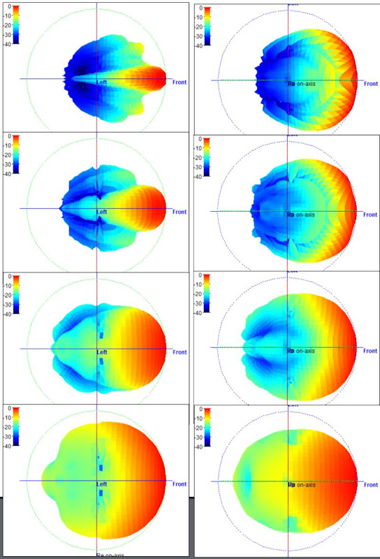

Hi Guys
So far as horn “pattern flip”, there isn’t a great deal written about it as it is a flaw or wart which is nearly unavoidable and not a “selling feature”.
An examination begins with Don Keele’s realization that the horn wall angle and dimension govern where (what frequency) it will lose pattern control. Also, the Horizontal and Vertical angles interact through this handy thumb rule relationship.
http://www.xlrtechs.com/dbkeele.com/PDF/Keele (1975-05 AES Preprint) - Whats So Sacred Exp Horns.pdf
The upshot is that for a given straight walled horn (makes it easy to define the horn wall angle), if you make it half the angle, it will lose pattern control an octave higher.
That second angle is needed to avoid the narrowing he mentions as the frequency falls and you approach the pattern loss point.
What is less clear is that if one makes a simple horn, one is limited to a symmetric case unless one accepts pattern flip.
When the loudspeakers go places where you count on a radiation pattern shape, pattern flip is bad JuJu.
It is absolutely ludicrous in commercial sound that loudspeakers are given a pattern angle, which may only be achieved at one Frequency over it’s entire band (similar to how some rate sensitivity too).
The problem is clear when you do the math. What if you want a 20 degree by 80 degree horn?
No problem, you make a rectangular pyramid shape horn. This gives you the familiar wide short horn shape. Do the math though and one finds if you want to avoid pattern flip, the mouth height has to be 4 times the width while the real thing is more like the opposite of that, wide and short.
The problem is that if you loose pattern control in one plane, the control in the other plane pushes the energy into the uncontrolled direction. When in the flipped domain, the pattern will be narrow horizontally and wide vertically, even though the horn shape looks like it would do the opposite.
I have tried to avoid geometry which causes this problem but there are times when the package size and arrangement requires a compromise. For me, I more or less limit the asymmetry to around 1.6:1 because greater amounts produce much more severe pattern flip.
I said this is not a selling feature but a wart and while ubiquitous, is rarely discussed because of the problem fixing it.
You can see what a mild case looks like if you look at the clf file for an sh-95. This is a simple asymmetric horn which had to be small.
Open the CLF file, grab the radiation balloon with the cursor and swing it around and examine it on axis, pointed at you.
Notice up high, it is rectangular where the horn is large enough to set that pattern.
Now, step the frequency down from 1.6Khz and watch the shape change as it losses pattern control. Note that at 500-600Hz, the pattern is “flipped”.
Now, while this is a mild case, it can be very severe depending on the horn asymmetry. It is why the proper mounting for a T-35 horn is up and down if you want wide dispersion horizontally, it’s pattern flip begins 8-10Khz.
Hey Earl,
Sebastian has taken the first quick pass converting the spherical polar data to a + - 90 degree map style display.
I am asking him to see if he can get the raw data out of the CLF file because this has 1/3 octave averaging / smoothing and I would like to see less. Also, we don’t need the display to the low corner, the directivity down to 100Hz would be plenty. This is a 3dB step each color.
I haven’t looked at that many of this spectrogram style “maps” but to me it looks like it has a decent amount of directivity.

Pattern flip is not a new concept, but without measurement is "hard to get".
Below are an equalized 90 degree horizontal "non divergent" Paraline, the horizontal dispersion shows very uniform (excellent) pattern control to below 500 Hz.
The vertical control goes from about 16 dB down at 16K 30 degrees off to only about 1dB down at 500 Hz, from a narrow beam to a nearly omnidirectional radiation pattern.
