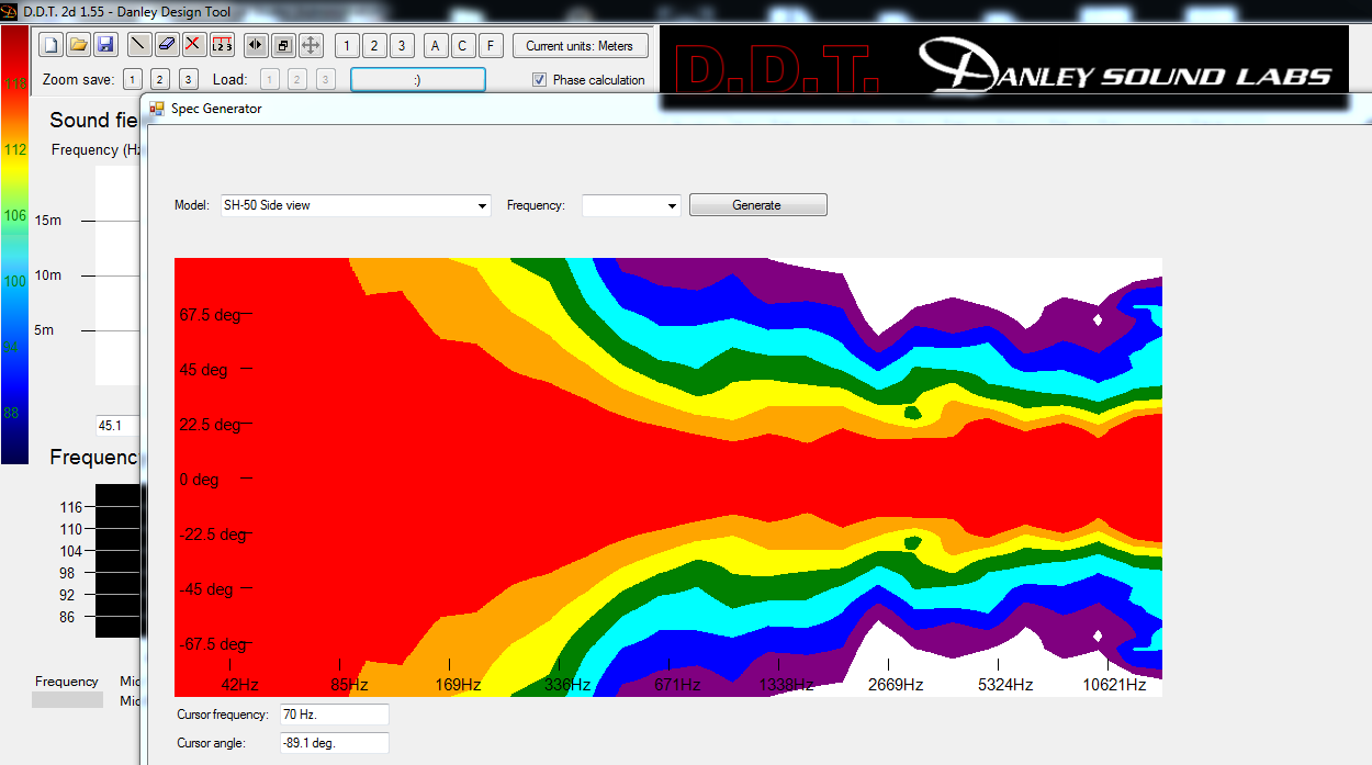

Hey Earl,
Sebastian has taken the first quick pass converting the spherical polar data to a + - 90 degree map style display.
I am asking him to see if he can get the raw data out of the CLF file because this has 1/3 octave averaging / smoothing and I would like to see less. Also, we don’t need the display to the low corner, the directivity down to 100Hz would be plenty. This is a 3dB step each color.
I haven’t looked at that many of this spectrogram style “maps” but to me it looks like it has a decent amount of directivity.
Best,
Tom

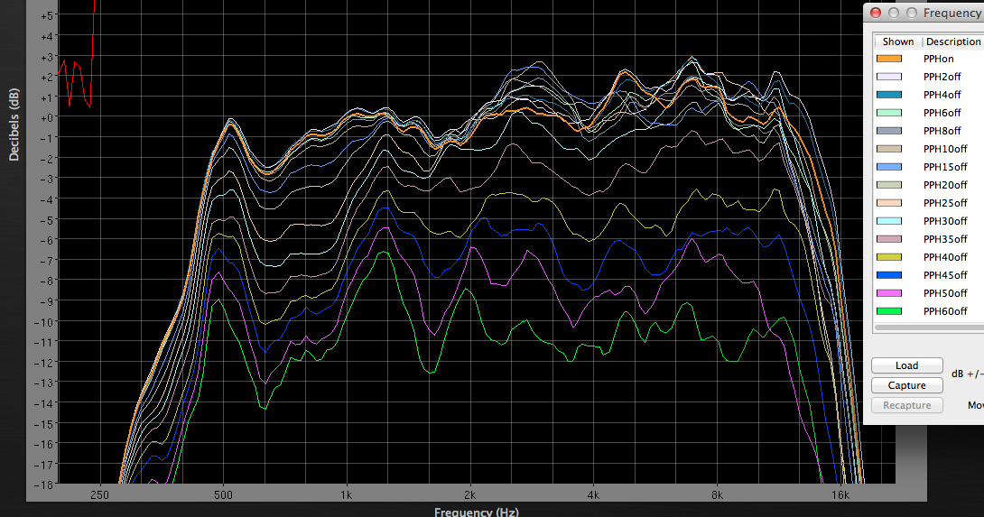

Below are an equalized 90 degree horizontal "non divergent" Paraline, the horizontal dispersion shows very uniform (excellent) pattern control to below 500 Hz.
The vertical control goes from about 16 dB down at 16K 30 degrees off to only about 1dB down at 500 Hz, from a narrow beam to a nearly omnidirectional radiation pattern.

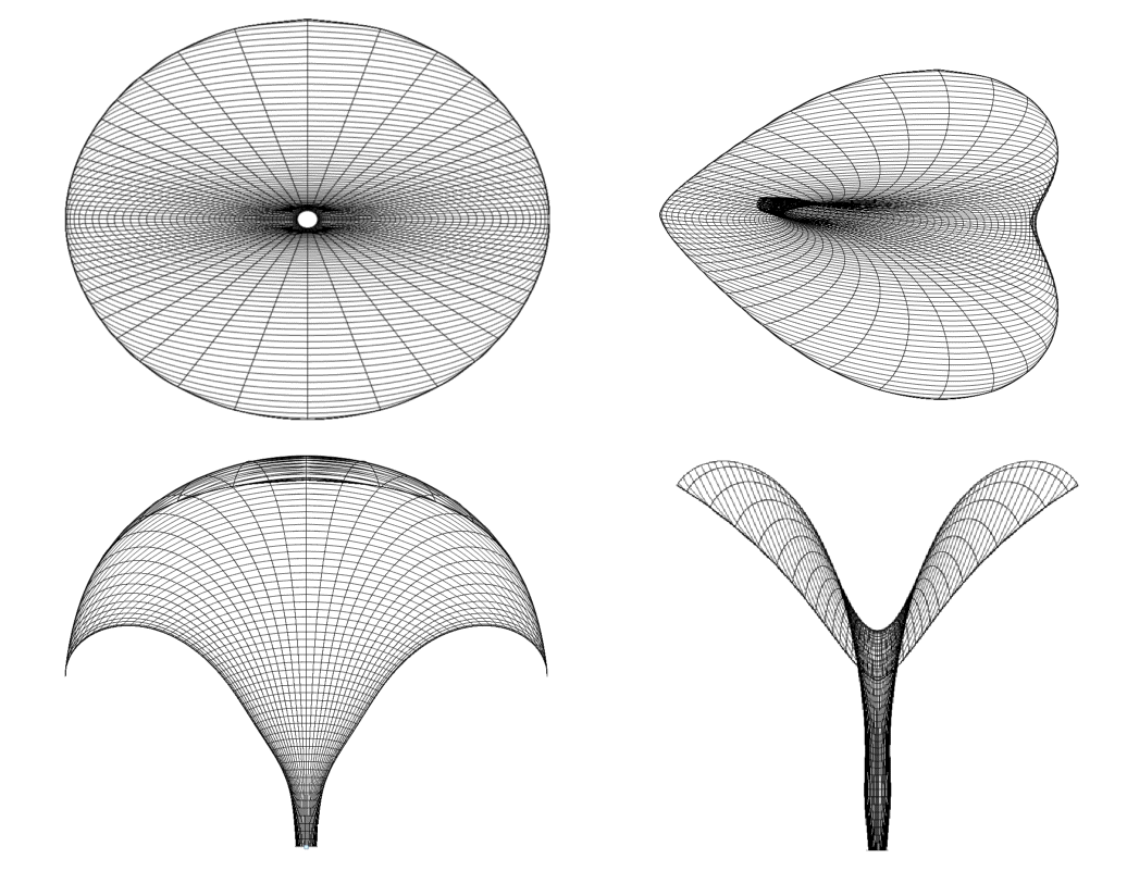

Hello Patrick,
I used to study a horn having a better control directivity in the horizontal plane than the axisymetriacl Le Cléac'h horn while maintaining the most acoustical resistive load to the driver on most of its useful frequency range.
Here is the result:
Too bad no one built it since today...
Best regards from Paris, France
Jean-Michel Le Cléac'h

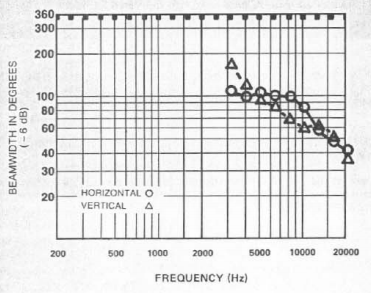

Originally Posted by weltersys
The rectangular Motorola Piezo horn was very similar to the Electro-Voice T-35 tweeter horn, which had recommended vertical mounting decades before.
Ahh, the T-35, i remember it, but didn't realise about the mounting details. See my screnie for the V/H beamwidth, which "seem" very close. I found a www with a number of other similar EV horns http://hf-antenna.com/Flotsam/EV/How_to-build_a-EV-spkr_system.pdf

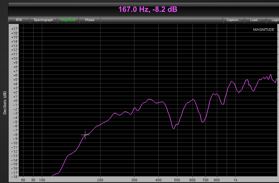

Apart from the other benefits, what "appears" incredible to me, is the "apparently" seemingly shorter lengths, compared to other horns, but inspite of that, go down lower !
The T-35 horizontal dispersion goes from 110 degrees at 3kHz to 85 at 10kHz, a 25 degree range, the horizontal from 160 to 60, a 100 degree range. That "seems" a rather large difference to me.
As far as the Iwata horns, if one is not concerned with constant directivity, a relatively low cutoff is not hard to achieve.
The Paraline which I posted polars for in post 496 has usable response down to 167 Hz (EV DH1AMT driver), and is only about 11.5 inches (29 centimeters) in length. It holds a uniform in horizontal response of 90 degrees from 500 -16 kHz, the much longer Iwata 300 goes from about 100 degrees to 15 degrees over the same range.
