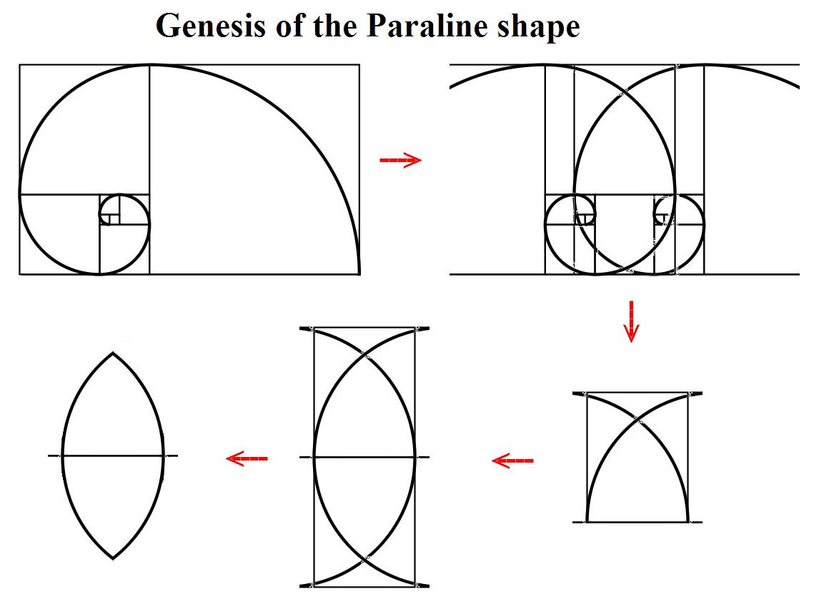

My hunch is that it's the compression ratio.
In a Paraline, the horn is expanding in one dimension.
In the OS curve or conical curve, the horn is expanding in two dimensions.
So at the throat, this expansion is appropriate; the volume of a Paraline and a conical horn is similar at the throat.
But as you go further from the throat, the volume of the Paraline isn't growing as fast as the volume of the conical horn.
This spreadsheet shows the difference well.
It compares the local flare rate of a 360 degree Paraline, half-a-Paraline (the thing I called a Stargate), and various conical horns. (40x40, 50x50, etc.)
So bigger is better... But it's especially important once you're about ten centimeters away from the throat.
This *might* be the reason that the FR Paraline has such small units, even though it's designed to go down to 100hz.
