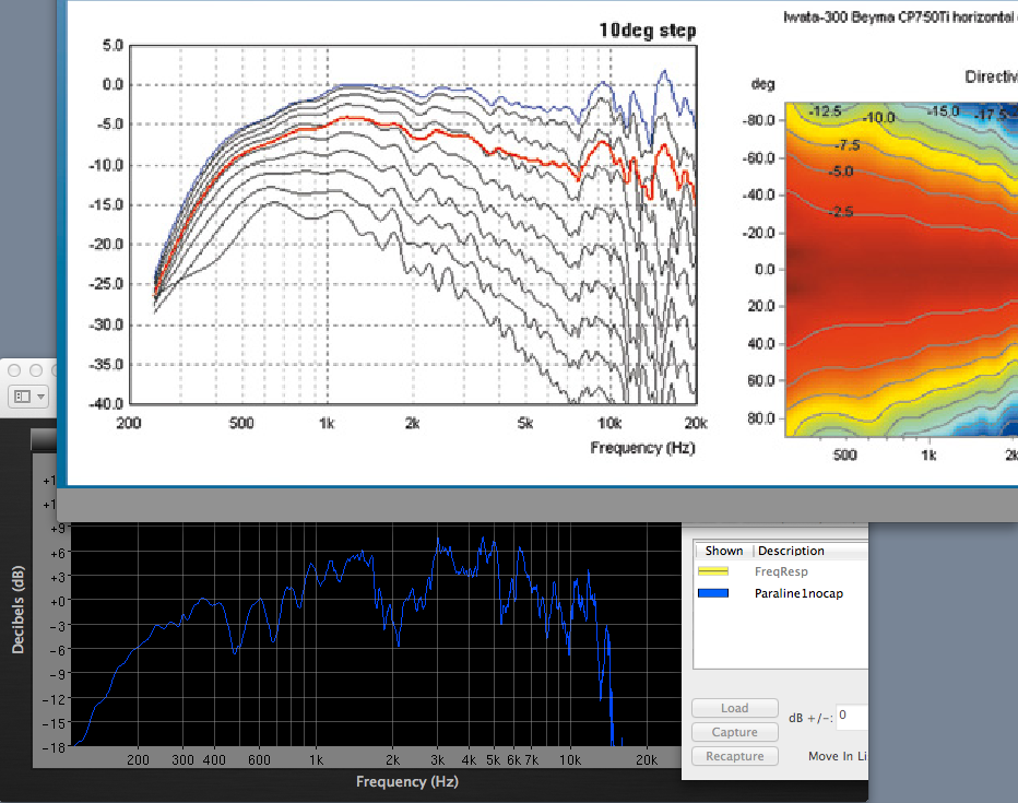

As far as the Iwata horns, if one is not concerned with constant directivity, a relatively low cutoff is not hard to achieve.
The Paraline which I posted polars for in post 496 has usable response down to 167 Hz (EV DH1AMT driver), and is only about 11.5 inches (29 centimeters) in length. It holds a uniform in horizontal response of 90 degrees from 500 -16 kHz, the much longer Iwata 300 goes from about 100 degrees to 15 degrees over the same range.
Art
Hello Art,
The design shown in message #497 is not an Iwata horn it is a very different design! The Iwata while having a lower horizontal directivity compared to the axisymetrical Le Cléac'h horn is not designed to control directivity. The new horn in #497 was designed in order to follow the current trend for controled directivity (even if for myself and others that want to benefit of a real 3D imaging from good stereo records there is no need for controled directivity as we listen only at the sweet spot andin the near field...)
What is seen in the frequency response of the Paraline you gave is that the ripples in the response curves could result in (multipaths) reflexions/diffractions inside the device, something that is avoid in Le Cléac'h horns.
Best regards from Paris, France
Jean-Michel Le Cléac'h
Impressive specs indeed, for such a short length 🙂 But a +- 7dB fr to 1kHz = ?
I also was looking at the circles and triangles which is why I noted the T-35 horizontal dispersion has at 3kHz to 85 at 10kHz, a 25 degree range, while the vertical has a 100 degree range in the same pass band, a rather large difference.I was looking at the circles & triangles.
As Jean-Michel Le Cléac'h said in post #501:
"What is seen in the frequency response of the Paraline you gave is that the ripples in the response curves could result in (multipaths) reflexions/diffractions inside the device, something that is avoid in Le Cléac'h horns."
The Paraline ripples and pattern flip are something that can be easily avoided using a conical horn with flared throat and mouth, (though a 90 degree conical won't go as low) which I have pointed out several times in this thread.
As far as the Paraline's low frequency response, one can see that the Iwata- 300 you linked in post 498 has around +/-16 dB response from 200 to 1000Hz, while the Paraline is only +/-6 dB in that range.

Paraline points taken, but +/-6 dB is still naughty 😉

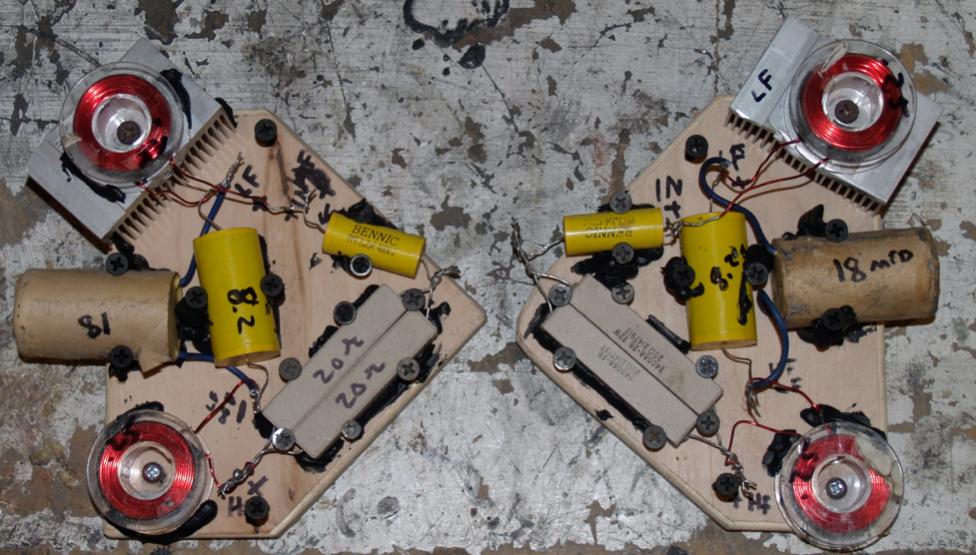

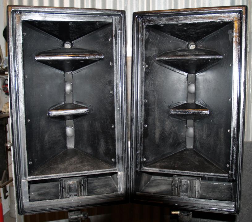

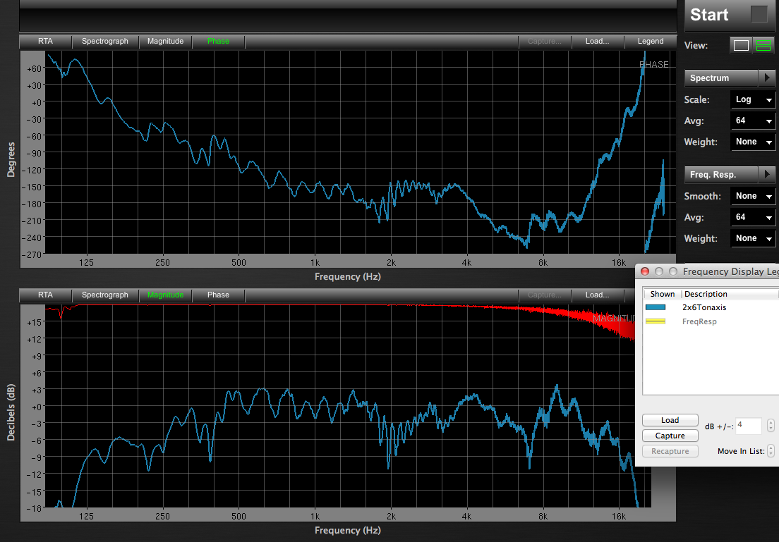

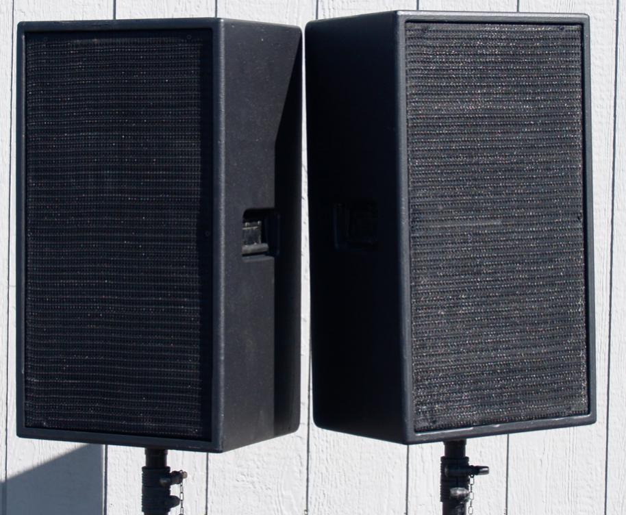

For a single (or a couple per side) cabinet use the cabinet design pictured below works much better for a pair of Alpha 6", is easier to build, and uses the inexpensive little Eminence APT for the tweeter. This arrangement allows around a 3500 Hz acoustic crossover, the 6" cover the voice fundamental range, the tweeter is really only covering harmonics, so has no problem "keeping up".
A very even 90 degree horizontal pattern, and no vertical pattern flip in the midrange like a single Paraline has.
Passive crossover has a surprisingly low parts count, yet has good phase response through the crossover region.
It is the same physical size as my Paraline PA cabinets, but oriented completely different, 26.5 tall x 15 wide and 11.25 inches deep.
Sounds good right up to around 125 dB at one meter, and is over 100 dB with one watt midband.
Needs a fair amount of EQ, but not nearly as much as a single Paraline.
I have used a pair per side of these 2x6T stacked horn to horn with a sub below for outdoor gigs with around 1000 people, everybody was happy.

James wrote:James,
I don't see where the reference to going omni at high frequencies is coming from. I would think that it would be just the opposite and the omni directivity would be at low frequency and that at higher frequency at least with a single unit you would just see a pattern flip at the dimension of your vertical height where the upper frequencies would flip radiation pattern?
"I suppose any object that small is going to get omni at a relatively high frequency, there is nothing I can do in terms of design to change that."
The "relatively high frequency" that the single Paraline "goes omni" in the vertical pattern is around 1000 Hz, it then narrows progressively at high frequencies.
The design I posted in #512 avoids pattern flip in that fairly critical frequency range.

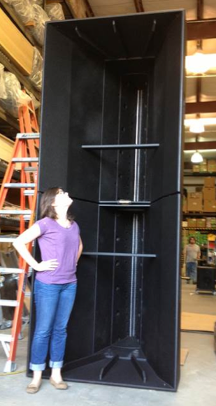

Danley posted a video of a new Jericho horn called a "J5 Caleb" on Youtube and Facebook this week. No info on the speaker on the website.
In one of their videos I noticed this monster horn being assembled in their factory. That's a lotta drivers!
(I don't know which Jericho horn that is; may be a J5, may not.)
The Caleb appears to be two part, 54 drivers in each.Danley posted a video of a new Jericho horn called a "J5 Caleb" on Youtube and Facebook this week. No info on the speaker on the website.
Mike Heddon stated dispersion of 40 x 15 degree, Ivan Beaver says driven by an iPod headphone output it is audible to past 150 feet.
