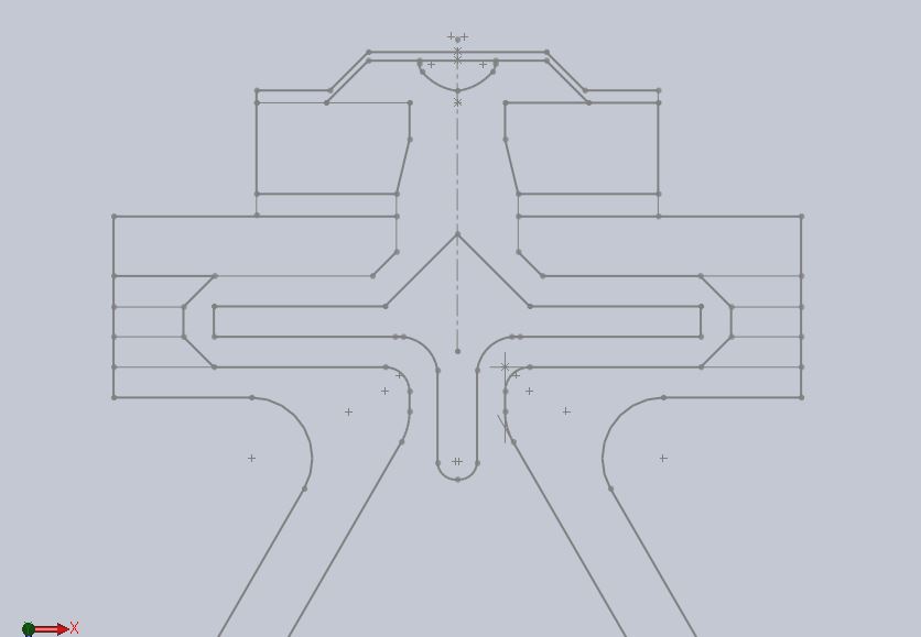

Nate...what material did you use for your latest attempt? How thick and how smooth was the passageway?
This latest attempt has been the only one thus far, I've been tweaking it as I go. 1/4" mdf for the plates which measures about .225 actual thickness. It's pretty smooth but there are a few spots at the bends inside that open a bit more than the .225 thickness, maybe .05 or so that could be addressed. The top inch or so on the left side of each Paraline got a bit "lazy" 🙄. My template was off and I didn't realize it till I was done. Probably goofs up the path lengths a bit. They're definitely not perfect! The "open eye" layers got a 45° chamfer around the perimeter when I cut them out, effectively adding reflectors in the internal bends. I'm not sure if that was necessary when the sound is constrained in the device but it can't hurt.
Looking at my 4552s I measure about 27° included angle in the driver exit. I got to looking at my tools and I've got a step drill that has about a 30° total angle on it. I'm off Friday and a project sounds fun. Talking snow tomorrow....... It's almost May!
Hopefully by Sunday I'll have both Paralines modified to have a reflector running nearly to the phase plug, following the driver exit angle and beginning the 1/4" internal height in the comp driver itself. It's going to be difficult to get the driver lined up over the reflector properly..... We'll see. If I have to I'll pull the back chamber/diaphragm assembly and mount the magnets first so I can see down the throat. I've got a cad drawing I'll post up later today showing what I'm up to.
I'm very interested to see if those modifications into the exit of the CD have any impact on the HF smoothness. Please do post the CAD drawings.

For reference here's how it's currently setup. This is what was used for the last set of measurements I showed.
Yep, that gap is definitely larger than the prescribed 1/3 or 1/4 wl limit which, in my lay mind could be the source of the HF response anomalies...or it might be meaningless.
Joined 2003
The new version definitely looks better. Are there still a couple of minor "choke points" on the 45* angles where the flow reverses direction?

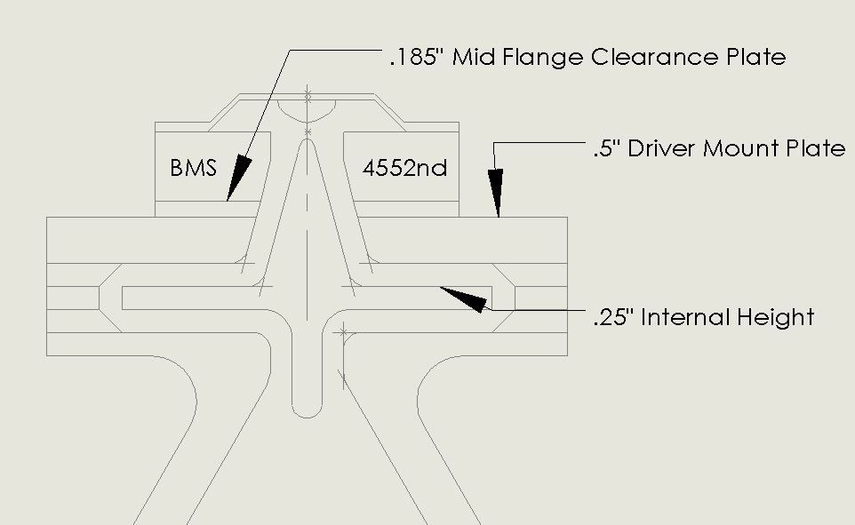

Here's the drawing.......clear as mud? I'm not one for fancy illustrations.
The .185 plate allows the CD to sit above the mid drivers' mounting flange, it's tight. I can take a pic if that doesn't make any sense.
Very cool drawings.
I've learned so much from mocking things up in Xara.
One thing -
Be careful about the reflectors in the correction slot.
I believe that one of the reasons that my 'Stargate' measures well is that it has fewer reflectors. I'm not an expert on fluid dynamics, but from what I know I believe that the transition in the correction slot is likely the spot where turbulence could create issues.
Basically, if you make the reflectors too big you create a 'choke point' which may be turbulent. Make them too small and you get diffraction at a lower and lower frequency. (The correction slot WILL diffract; the trick is to push the diffraction to the highest frequency possible. It's the reason I use 0.20" wood for mine. I've considered using clear plexiglass as that would make everything a lot easier.)
Also, if you guys aren't using a plexiglass mounting plate, like Geddes does, RUN don't walk to your nearest Tap Plastics and get on that! Plexiglass makes EVERYTHING so much easier.
