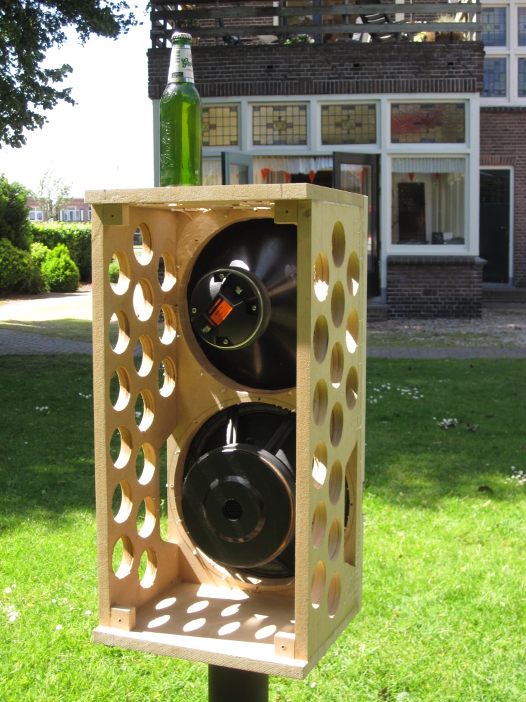

The concept is a 2-way speaker with a 12” woofer and a 1" compression driver with a 12” waveguide, crossed passively at 1 khz. A miniDSP is used for amplitude corrections and the crossover to subwoofers below about 100 hz.
I considered many drivers, but I ultimately settled for a Selenium D220Ti compression driver, a Dayton H12RW Waveguide and a A&D R1230 midwoofer. The Seleniums are relatively cheap and they are quite popular, so I thought those would be a good starting point. I bought both the Dayton JBL-clone (the one used in the Econowaves) an the Dayton H12RW. I chose to use the H12RW because it is axi-symmetric and thus has more constant vertical control. The rectangular waveguide allows better vertical alignment of the acoustic centres, which helps to minimize lobing at the crossover, but I don’t believe that to be as relevant as some others do. With a crossover at 1 khz, with this speaker the acoustic centres are spaced less than one wavelength apart, which is much better than many a conventional 2-way box speaker.
Initially I intended to put the drivers in a closed box, but in order to get the smoothest possible powerresponse through the crossover-region a simple box seemed not to be the best solution. Although others have already shown that the closed box format is very workable if you cross at the frequency where the directivity of the woofer and waveguide match, below the crossover frequency directivity usually decreases quite fast. Therefore I decided to experiment with an open box – a box with holes in it. The box is stuffed to the brim with rockwool (I intended to use glasswool, my favorite, but I didn’t have it at the time) and I use carpet without backing to finish the sides.
Some pictures:

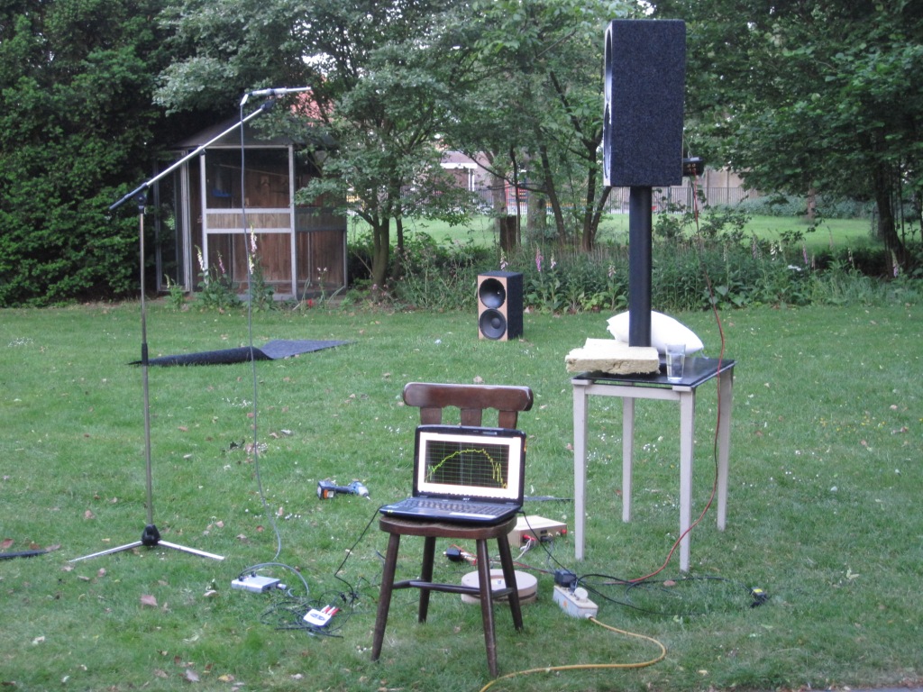

Typical measurement setup (measurements of the speaker with crossover are taken about 1.5 meters higher than this) :

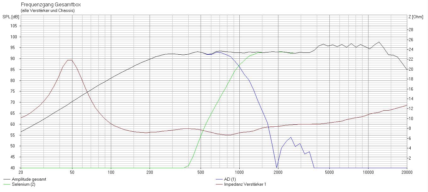

Let’s have a look at what the Selenium-Dayton combo looks like in comparison!
611124d1491990102-2-way-waveguide-cardioid-like-selenium_d220ti-en-ad_r1230-onaxis.jpg
Comparison on-axis response A&D R1230 and Selenium D220Ti on Dayton HR12W
The first thing I noted was the ragged response above 5 khz. Let’s hope it doesn’t sound as ugly as it looks! The second thing that struck me as odd is that except for the 2khz bump the curve overall is very flat! I expected to see a downward trend. Let’s see how constant directivity is.

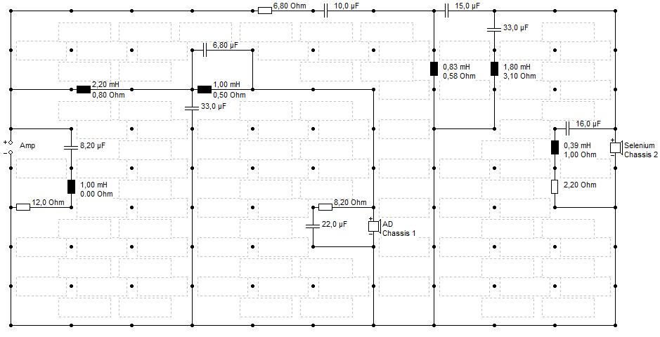

The passive crossover was a bit more difficult to get right than I’m used to. The acoustic center of the tweeter lies a bit behind that of the woofer. This causes some excess phase. To work around this, I had to cross steep and I had to do a few tricks to get the right amount of relative phase rotation [EDIT: as speaker dave later remarked, there is still some excess phase left in both the measurement on the tweeter and the midwoofer, which makes the plots look a bit messy]
Crossover schematic
Some inductors have unnecessary low Rdc, but that’s because I used components I already had. When I build the crossover into the speaker I’ll use more logical component values. The impedance correction is optional.

Unfortunately, then it started to rain, so I couldn’t do more measurements. Indoors I later lifted the highs a little to make the response flat on the listening axis of about 20 degrees. Also I EQ’ed a few of those nasty looking peaks. In the range below 500 hz I do a little room-EQ. Subwoofers are used below about 100 hz.

Can you explain some more about your intention of having carpet over the holes? A very "lossy box" perhaps? I'm experimenting with fish net material behind a solid baffle, so the sides of the "box" are nothing more than glass wool suspended behind the drivers. Automotive air filters are another way of attacking this as they create very lossy sides, close around the driver. The midrange is phenomenal.
At the sides there is only a minimum of rockwool, so damping is also limited. I needed something to finish the sides anyways (the MDF panel with holes in it doesn't look very nice) and I reckoned the carpet may provide some extra damping / flow resistance.

By the way, yesterday I set the entire system up in the garden. First I undid some roomEQ in the midrange and I made the response very flat. Then I decided to have a listen. It seems the harshness in the midrange seems to be due to faults in the frequency response. Outside it sounded very clean, also at higher levels. The biggest issue was the floor-bounce, which degrades the frequency response much more than it does indoors, where its effect is mitigated by other reflections.
After yesterdays corrections the speaker sounds a lot better. I've decided to optimize the speaker placement based on measurements taken at the listening position and not to do any roomEQ on the speakers anymore. The subs still do have some EQ. This sounds very good to my ears.
IMO, the Selenium to me is the worst sounding CD of them all, it could be just the screw on types though ( I never did get anything I liked out of the Dayton + Selenium CD). In that price range I would choose the Celestion 1745 over it.
Thanks for sharing.
The opinions of the Selenium vary almost as widely as its amplitude response above 6 khz! I think if you look at the response curve (or the CSD, for that matter) long enough, you just have to hear lousy high frequencies!
However, it is interesting that of the several audiophiles I've had over to listen to these speakers - most of them with limited technical knowledge of loudspeakers - nobody commented about the highs being sharp or lacking resolution! I myself don't hear it either.
I would like to know what others think of it too, though!
No problem, could be true about staring at measurements and then 'hearing' it but I listened to 5 CDs I bought for my 2-way waveguide build before I measured any of them.
There are many that have enjoyed the Selenium driver in the econo waveguides. Im just not one of them.
The passive crossover was a bit more difficult to get right than I’m used to. The acoustic centre of the tweeter lies a bit behind that of the woofer. This causes some excess phase. To work around this, I had to cross steep and I had to do a few tricks to get the right amount of relative phase rotation.
There was a good discussion about this on HTguide.com when Augerpro was building a two. I will try and find it. We also rear mounted our woofers to try and get the AC closer together.
I think this was the discussion
John Kreskovsky brought up an interesting alignment that might be prefect to try with this design, for the passive version. Here is what he said:
"Additionally, a 3rd order, quasi Linkwitz type crossover is easily constructed by cascading a B2 with a B1 filter and delaying the high pass section by 0.25 wave lengths at the crossover frequency. The response error will be +0, -1.2dB max. This is easily constructed using passive elements.
For the HP,
C1 = 1/(4 Pi R F), C2 = 1.2 /(Pi R F), L = 1/(2.4 Pi R F)
For the LP
L1 = R/(Pi F), L2 = R/(4.8 Pi F), C = 0.6 /(Pi R F)
Offset tweeter by 0.25 wave lengths at the x-o frequency and connect with inverted phase. "
What caught my eye was that the AC offset (versus 1300hz crossover) of my No Quarter design is nearly identical to the above spec of .25 wavelength of crossover. I also like that this has a broader overlap than LR4, but won't be as demanding as LR2. And all the usual LR properties of symmetric lobing and in phase drivers.
Found here
HTGuide Forum - Can you smell what Brando's cooking!?
D220Ti crossover point
I'm also using the D220Ti + HW12 in a speaker that I am building so I read your thread with much interest.
I noticed that you cross over at 1k Hz. This is on the low side for the compression driver. I am wondering if you have done any listening or distortion tests yet, and if so what is going on around 1k Hz? Can you detect any strain, etc? Maybe this is why the midrange sounds "shouty" (per your initial post)?
Hi Charlie,
I haven't done distortion measurements yet (will do that during next measurement session), but I'm convinced the Selenium is used nowhere near its limits. If these speakers were to be used in a PA, I would probably have used a crossover closer to 1.5 khz, but for hifi this is not necessary. Horn-loading is still evident around 700 hz, under which frequency the response begins to roll off. The crossover at 1 khz is about 30 dB acoustically, which is significant, so I don't see any problem here.
Last saturday I threw a party to celebrate my birthday. Some friends were interested in my new speakers and we listened to Child in Time by Deep Purple, from their Made in Japan album. Right now the limiting factor is probably the power amp (but it might also be the output of the miniDSP), an NAD C370 integrated amp with some 150 watts at 8 ohms. Up to about 107 dB continous inroom SPL it remained very clean, but above that it began to clip. This is probably due to the significant boost at 100 hz (about 8 dB's), to compensate for the open-box roll-off. I'm okay with a 107 dB SPL maximum continuous level - those aren't levels I want to endure too often or too long, let alone even higher levels.

The slightly shouty character I mentioned disappeared after I omitted the roomEQ in the midrange, improved the EQ of the speaker and changed the placement of the speakers a bit. Now they sound very good to me. I was really happy with the sound of the dipoles I had before (link in the opening post), but I think these sound even better.
