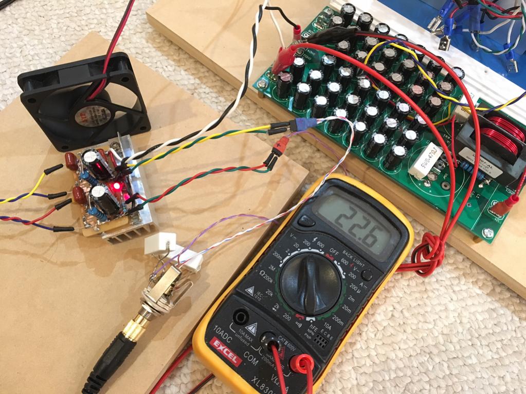

Aksa-xrk971 JFET HA works!

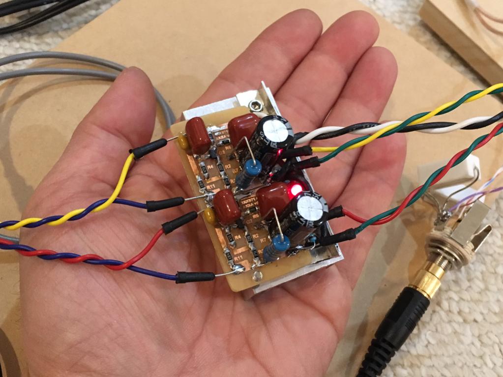

I just finished the amp and fired it up just minutes ago. It's a miracle it works the first time with no smoke or fire. I am using a 19.5v 4.65amp SMPS laptop brick for PSU raw (no filtering for now).
The board is so small, it was kind of a challenge to squeeze some of the through hole components in there. Juma recommended a 470uF output cap so I am using a rather dubious brand (as cheap as they come from China Chenxing brand 470uF 50v 105degC) but bypassed with 1uF 100v MKT. On input I have same 1uF 100v MKT paralleled with 10uF 50v MLCC to get the deep bass. I ran out of 47R SMT so using 39R gate stoppers. The source resistor is a metal thin film 100R 2w mounted vertically to fit. The LU1014D's are very securely fastened with a small L bracket clamp held in place with four 6-32 hex cap screws pressing down on power JFETs against silicone transistor pad.
It is a tiny amp! Look at the scale relative to the headphones. I am measuring 104mA bias current per channel. That's basically 19.5v x 0.104A = about 2 watts dissipation per channel or 4 watts total. Heatsink seems appropriately sized, hot but not unbearable to touch. I can hold it for over 20 seconds before it is uncomfortable.
I am listening to the usual YouTube dance mixes to give it some time to burn in. Sounds quite nice. Very clean and excellent sonic presentation. Bass is very good.
I will post detailed listening impressions soon - but so far so good. That laptop SMPS works surprisingly well. No fuss no muss type of PSU for a head amp 🙂
Edit: you have to see this thing to believe it - how such beautiful powerful sound can come from such a small two transistor amp? Here it is singing in my hand!

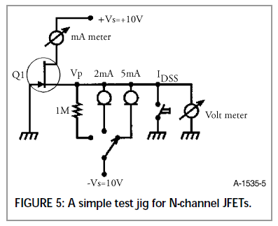

I have not set up a rig to measure gm or pinch off v yet. I can measure Idss easily. I have an order placed for that handy dandy transistor MOSFET/FET tester and will test when it gets in. Although I am tempted to make this rig and try for myself it's just a matter of priorities in my time available.
The eBay link I posted seems to work - whether they are genuine I don't know. The seller says they are original. I think there was a source that was mentioned in another thread where you can buy matched sets for $6/pair. Deep Surplus or something like that.
Also, from the Borbely article that Juma pointed out, in Fig. 5 of the first one looks like a pretty simple testing system:
I will see if I can sneak some time out of my day to try this. It's made easier with a solderless breadboard and 3-pin screw terminals for installing the JFET. I currently am lacking a good lab grade PSU so may just use a 9v battery.
