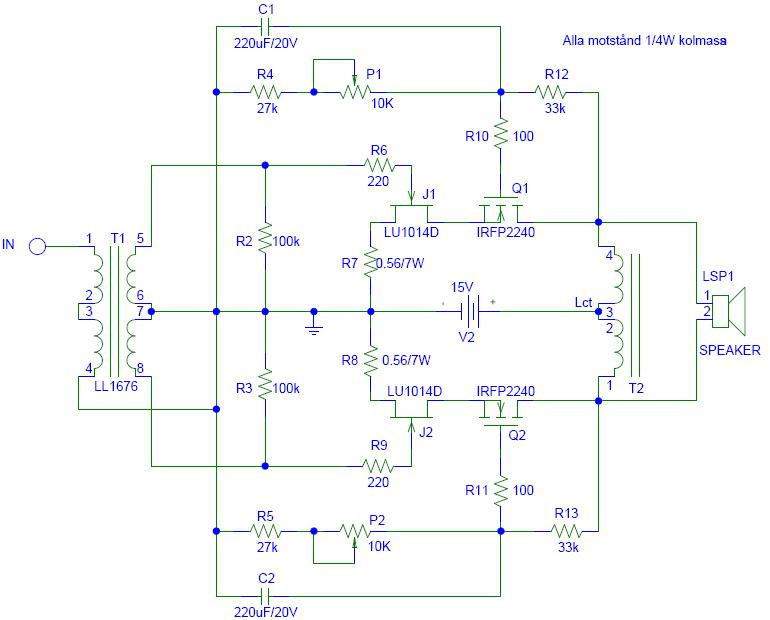

Carpenter:
It is very simple really, it is just a differential cascode with a mosfet ontop of a jfet. It is inductively loaded so the efficiency will be close to 50%. Since there is no feedback the output impedance will be very high, just like the FirstWatt F1. Since i drive it with a very well balanced input i dont need a high impedance current source like the F1 but can instead pull the jfet source resistors directly to ground. I really like the simplicity of this one and have very high expectations on its performance, i hope i will not be disappointed!
BR,
Anders
BR,
Anders
Interesting!
I see you specify the Lundahl LL1676 for T1, how about T2? Do you have a recommendation?
Also, I see a V2, but no V1. Is something missing?
Thanks for sharing this design. I'd be very interested in hearing how it turns out.
Paul
Paul

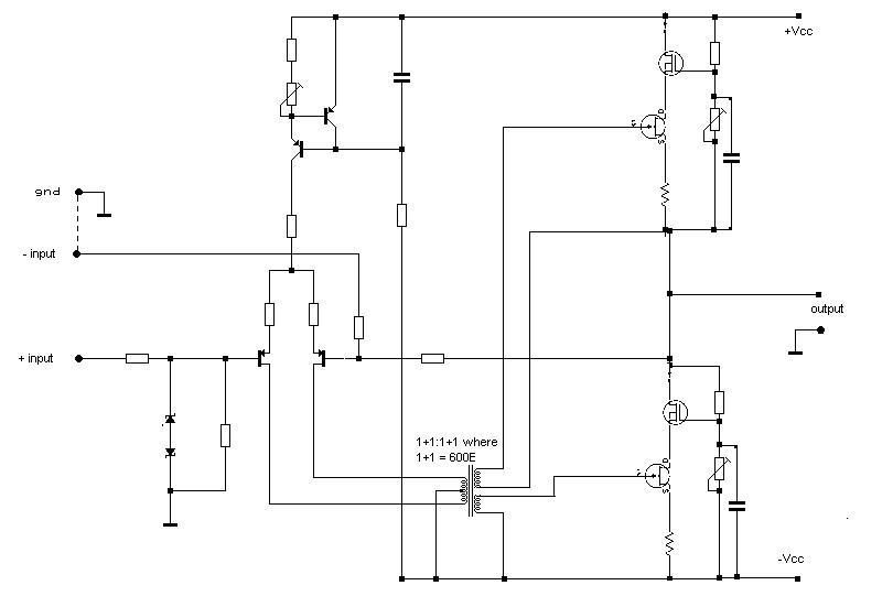

pretty picture, Choky...
It reminds me of the aleph topology with an transformer interfacing the two stages. Forgive my lack of expertise, but how does this tie into the ZV7-T?
flg, you're pondering the same questions I have. Cool! I didn't mean to appear to be chasing magnetic center as if it were some kind of "holy grail". I just thought that it might be a start to indicate if there were gross maladjustments/ misalignments in the transformer windings. I would imagine that the amp is tuned to remove as much measurable flux as possible. I don't know exactly what pots adjust magnetic center. If you move P1 and P2 you lose dc-offset. Maybe this is why Nelson mentions off handedly that he's been know to tolerate 50 mV of dc offset. It might take a little robbing Peter to pay Paul to make this work. And, maybe this is why there should be a 45watt resistor to ground off each transformer output leg... (I recall Nelson mentioning this)
hehe-connection is just xformer,nothing more
it's just little cut'n'paste jobie,I didn't even delete incorrect feedback for that type of amp.......
regarding your question-everything is in DC symmetry.....additional resistors are handy -think of them as sort of source resistors for output fets.....
further tweaks can be with use of distortion meter,or (at least) with CRO and sig gene-looking for perfect AC symmetry in both halves
Paul Ebert:
T2 will be made up of 2 bifilar windings on a 250VA c-core, but at first i will use the secondaries of a Lundahl LL1623.
BR,
Anders
BR,
Anders
