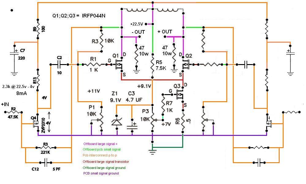

I've ordered 80lb. of 16AWG copper wire to fabricate the air-core chokes. I'm starting off with 50mH per leg since this amp is to be used over 400hz.
R-13 is my best guess. I'm a rank amateur at this stuff. Fabricating is what I do best.
I've ordered 100 IRFP044N transistors cause I want to hear what the little fellows sound like; this is why I lowered the input voltage, not to mention I run a 110 db horn from 400hz to 20k. I don't require 30 watts...
Right side of schematic is a mirror of left, hence no values entered.
I'll begin revamping my project this weekend. 😀
John

by the way...
I treated the ZVP3310 like a LED and biased it accordingly. Like I said previously, I'm just an amateur at this. I think Nelson is biasing this transistor at 8 mA, so I adjusted the bias resistor to the lowered 22.5v voltage to match the 8 mA figure.

Interesting...
I replaced the 1000V/A Plitron with a very small (in comparison) center-tapped, air-core choke. It weighs 6lb. and has an inductance of roughly 10mH per leg -- that's according to the coil winder's meter. It's resistance is about 1.6 ohms per leg.
The amp is bi-amped, operates the high frequency spectrum and is crossed over at 500hz.
It's late, no time for adjustments, just fired it up.
Observations:
The CCS transistor not only doesn't get hot, it doesn't even get warm. Humm? The gain transistors are slightly cooler than normal, but still warm up the chassis a bit -- they're easy to touch, though. The choke is mildly warm, not hot by any means.
I'm running the amp through my surround sound, center channel 2445 driver and horn. The driver is rated at 16ohms, 110 db. 1w1m.
The sound felt a bit rough at first but became sweeter as the amp warmed up. I hear less hash, it's a bit brighter...
All in all, this mod pleases me, and best of all, cost much less than a transformer. I spent $36.00 (US).
Again, my fondness for Nelson is further reinforced. I've learned a great deal from him and this forum. Thanks everyone. 🙂

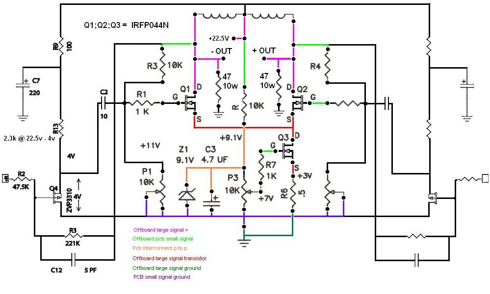

The chokes are getting warm, now. You can touch them with ease, but I wouldn't call them "cool".
Here's where the amp is currently running:
Input voltage: 28.6v
gate of gain FET: 8.8v
source of gain FET: 4.3v
drain of gain FET: 23v
junction between CCS and R6: 2.9v
edit: almost forgot; dc offset cold 15mV, hot 3mV.
It looks like I'll be keeping the input voltage around 28 volts vs. 22.5v as drawn in my version of Nelson's schematic. The drains of the gain FETs are 23 volts -- nearly what I wanted as is. Can anybody see why I shouldn't be able to use IRSP044N transistors?

Nice to hear those comments John😎
I might have missed this but what is the bias you are running on the output?

Hi guys!
Apassgear, I believe that the bias voltage is located at the junction between the CCS and R6 -- 2.9 volts. I'm just learning so if I'm wrong here, I apologize in advance -- what I do is divide 2.9 volts by the power resistor's resistance which is 0.5 ohms. This yields 5.8 amps of bias for the gain transistors. What's amazing is that the CCS transistor doesn't get hot, it's barely warm.
Dennis, I use an online choke calculator. I practice a bit of moderation and use 14 gauge wire. You could use 12, but it takes a whole lot more. Going with 14 gauge, the calculator suggests for 2 times 80mH a bobbin that's 2 inches tall/wide (depending how you are looking at it) with an inner diameter of 1 inch and an outer diameter of 7.5 inches. Both legs are wound at the same time creating a center tap. This fellow has 2 ohms per leg. Hope this is useful.
edit: Dennis, I checked a chart -- 1600 feet of 14 gauge copper wire weighs about 20 lb. My inductors weigh 6 lb. Your inductor is going to be quite a bit larger than mine! Good luck with your adventure.
