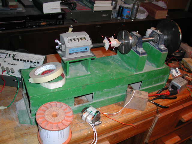

coil winder
You won't get far wit a small motorised unit, as you will need a quite powerfull unit to wind 2*1.9mm wire. The best way to do it "low budget" is to use a lathe. I have a winding machine for smaller coils, but I use a lathe for anything over 1mm wire.
All you have to do is to make a rev. counter, such can be purchased as a complete unit, or made of a calculator and a switch. I have chosen the calculator solution, as it can count parts of a rev.
Magura
Magura
John,
This is what I use for my DIY work. It has a core shaft where I mount different forms made of wood or solid steel. It has a rev counter attached to the shaft with ¼” rubber hose. Initially it was design with the idea to motorize it but never came to do that. I have work 12 gage wire over rectangular forms, which is more demanding that round forms, not easy though with that heavy wire.
