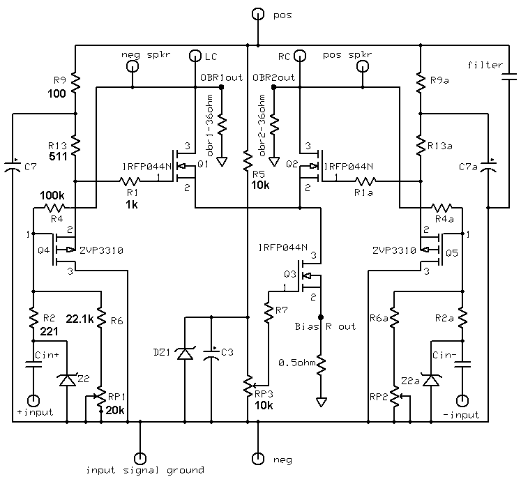

Wow! 😀 I paralleled a 47k resistor to R6 (making it 35.6k total) and paralleled 122k to R4 (making it 95.6k total). The midrange became very solid sounding.
But the micro-detail was lacking. So...
I lowered R2 back to 221ohms. 😱 The results are wonderful! The detail is back and the upper end is solid as a tank.😱 😀 As a bonus, I got to turn down the gain on the x-over one full click.
I'm very happy with the end results and plan to stay here awhile. I'll be assembling my next ZV7-T using Lee's inter-stage coupling technique (basically, remove everything between the gain stages but the stopper resistor). I'm very fortunate in that the pcb allows this process without the severing of traces. I just have to relocate two resistors and omit whatever else stood between the buffer and power transistors. This even places pots P1 and P2 in series with R6 and R6a. This way I can adjust offset at the buffer's inputs.

Lee, I finished my second amp last night and got to have a quick listen before bed.
First off, it works!😀 In fact, it came up to speed with very little adjustment (CCS P3 for the most part). This is wonderful considering that the first amp took at least a half-hour with back and forth adjustments to all thee pots.
I configured the pcbs so that P1 and P2 are in series with R6 and R6a. I preset the value to 30K and wound up with 10 volts or so at the gates of the gain FETs. Remarkable; thanks for the drawing.🙂

Hey John 😀 So, this is a ZV7-T with the gain transistors biased up through the buffer 😕 I guess with no R3 and C2, and with P1 moved???
I would watch the offset stability initially.
What are you useing for R2 and R4 values?

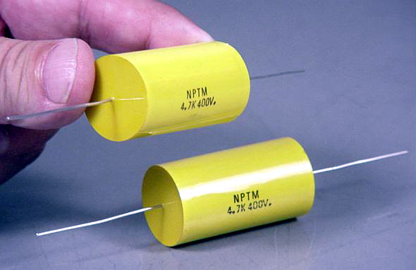

I've been reading for several hours on the "net" and came across what appears to be a fine capacitor. It's called Sonicap. 1uF @ 200 VDC cost $5.80 each. Dimensions: 0.47" x 1.3".
Anyone familiar with this product? I'm about to order four.

The only actual A-B test I did was replacing some Solen's with Kimber's in my Zen4. I could honestly say there was a noticable improvement. My Zen4 did not seem to have much high end anyway but it cleaned up what it had nicely 😀 😀 😀
As I said, I ussually use one or more in ll, "MKP" style, Metalized PolyProp rated for AC Line filtering until I think the amp is tuned up well in the prototype stage. Then I rebuild it into something more finished with the bigger $$$ Caps. I don't think the solen's are much better than your basic Evox-Rifa AC line cap. Ideally, No Cap is good 😀 But, I really hate poking my soldering iron around in a circuit that has $30 caps in it.
Hey, I just happenned to notice something??? Where did that Z2 come from??? Depending on its Zv that could be a problem???
And, I still think you need to change that 221 ohm for a real input resistor like 10k or so. Without a large enough resistor there you are running open loop(No Feedback).
Your high end would improve with R1 being 221 ohms, put them there...

carpenter said:I've been reading for several hours on the "net" and came across what appears to be a fine capacitor. It's called Sonicap. 1uF @ 200 VDC cost $5.80 each. Dimensions: 0.47" x 1.3".

Lee, the input zener is for static protection and hasn't been implemented, yet. I was thinking of something along the line of 10 volts considering that more than one volt input will drive this amp into clip mode--or at least it did with the old air-core choke. I haven't measured its voltage output with the transformer that's taken its place.
I tried changing R2 to 10k awhile back and the amp didn't sound very good--dull, muted. It sounds terrific with R2 at 221 ohms. The top end is very articulate--and I do mean VERY. It's so clear, I could probably hear a mosquito fart in the recording studio.😀 😉 😀 Perhaps I could try something around 2.1k?
I'm leaving R1 at 1k because Nelson mentions that the amp can oscillate with inductive loads, which is exactly what that big ol' transformer is, right?😕
The top end is a bit bright, almost to the point of bruising the "golden ears" in my family. They love what I've come up with, though. That's why I thought of trying an audiophile type input cap. Ok, a cheap, audiophile cap.

carpenter said:Have you had a chance to hear these? They are certainly in my price range.😉
look at lower links (in previous post) and I'm sure that you'll find few more alternatives...
who knows-if you mail Steve,mebbe he'll find something else for you
ps.
decent cap is decent ; good 90% at least as 50x costlier one......I think that these caps are decent
if you click on lower link,you'll find some poly and mylar caps in range of 8-10UF............certainly worth trying for that money
