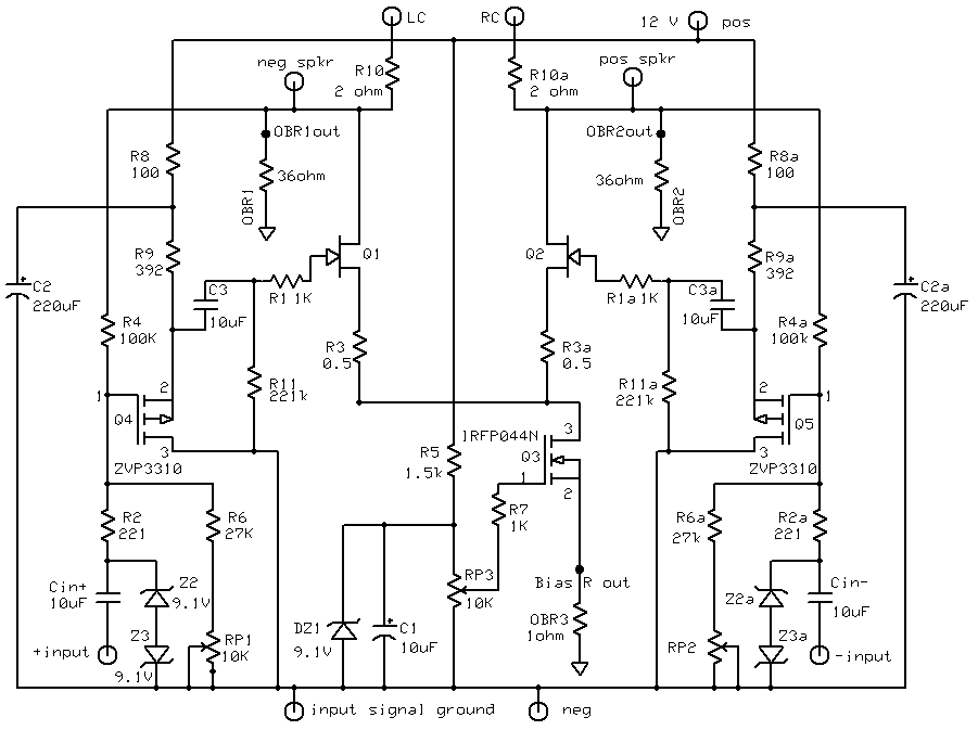

I'm breadboarding the following design: a jfet version of the ZV7-T. It doesn't have the buffers on the breadboard, yet. But the center portion of the schematic is up and running.😀
Stock, right out of the box, there's only 13mV of offset.🙂 🙂 🙂 which is good considering that I have no adjustment device.
Man, this thing sounds great! It's getting that wonderful warm sound. The best part is that I don't have a blow-torch sitting on my work bench. I sandwiched the jfets between a pair of 1.5" x 2" x 4" heatsinks. After 15 minutes, they're barely warm.
I'll adjust the schematics to reflect what my operating voltages are. Right now, I'm anxious to hook up a horn.😎
John

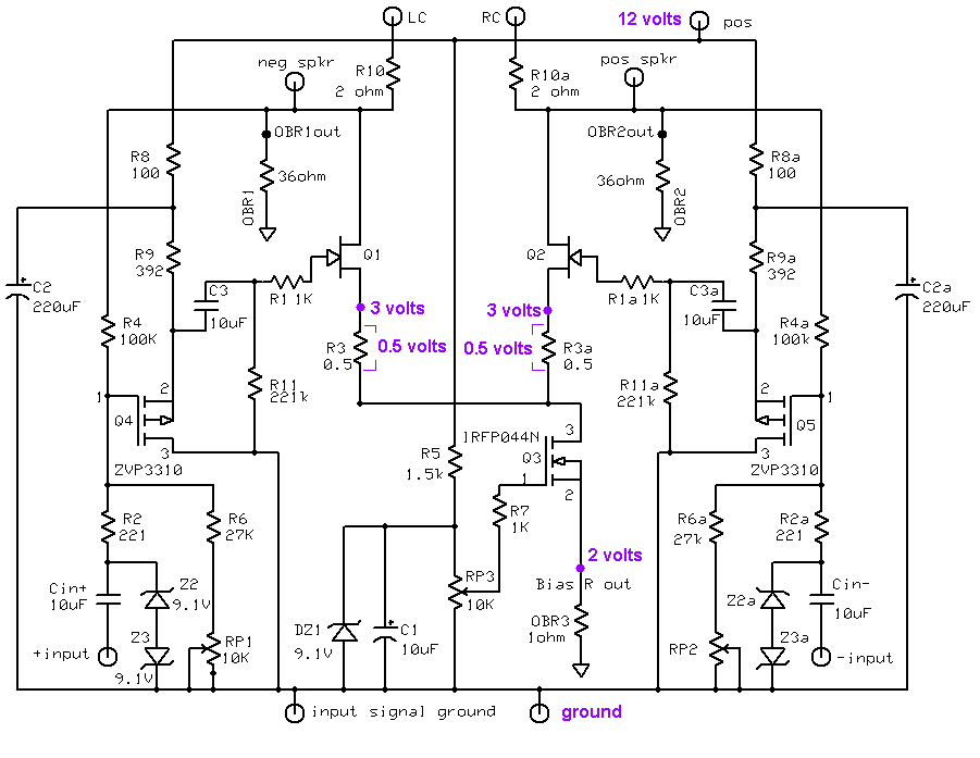

Here's a few voltage readings:
Also, it's worth mentioning, I am using an air core inductor which has 2 ohms per leg.
Looks like I'm going to be purchasing a bunch of Grey Rollin's jfets when I get back to work. You got to love it!
If my math is correct, this is about a four watt amplifier, and perfect for 110db 1w1m horns.🙂
