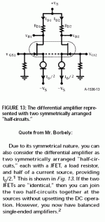

To have a differential pair, you ussually have to have your sources tied together so they steal each others current during operation. Generally that is a controled source of current feeding the pair. Diff pairs are in the common source amplifier configuration where the output is taken from the drain.
The input pair of transistors on your ZV7-T are common drain configuration😀 😀 😀

I based my premise on a recurring thought of Mr. Borbely's jfet tutorial where he depicts a pair of transistors in a similar configuration as my buffers. Just pondering...

carpenter said:Here's the piece of info that's perplexing me:
Yes, that's a diff pair. Notice the dotted line connecting the sources
N.P.'s BZLS and Aleph Preamps along with the SOZ all have this configuration. A resistor inserted at the dotted line can control differential mode gain.😀
