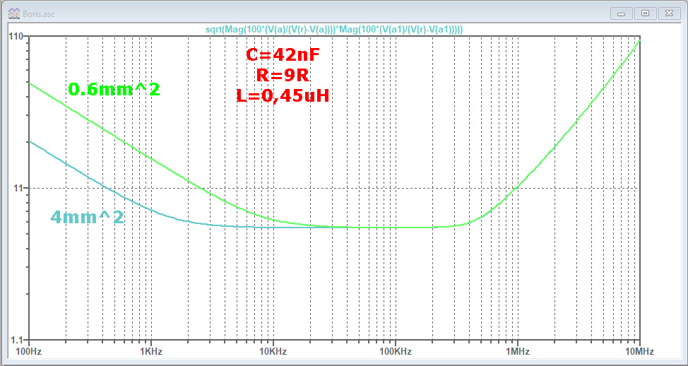

Boris,
You mentioned to have 6R speakers, that's why I have optimised the cable for 6R.
I have simulated Zo for your 0.6mm^2 cable and for a 4mm^2.
Quite obvious is the big difference at LF.
I have assumed to divide the cable in 4 equal parts, and to connect at the 3 points in between resp 42nF, 0.45uH and 9R, all components three in series.
The 9R should be a very low inductance 30Watt (current sense) resistor and the 0.45uH should be a version for several amps.
Hans
Hans
