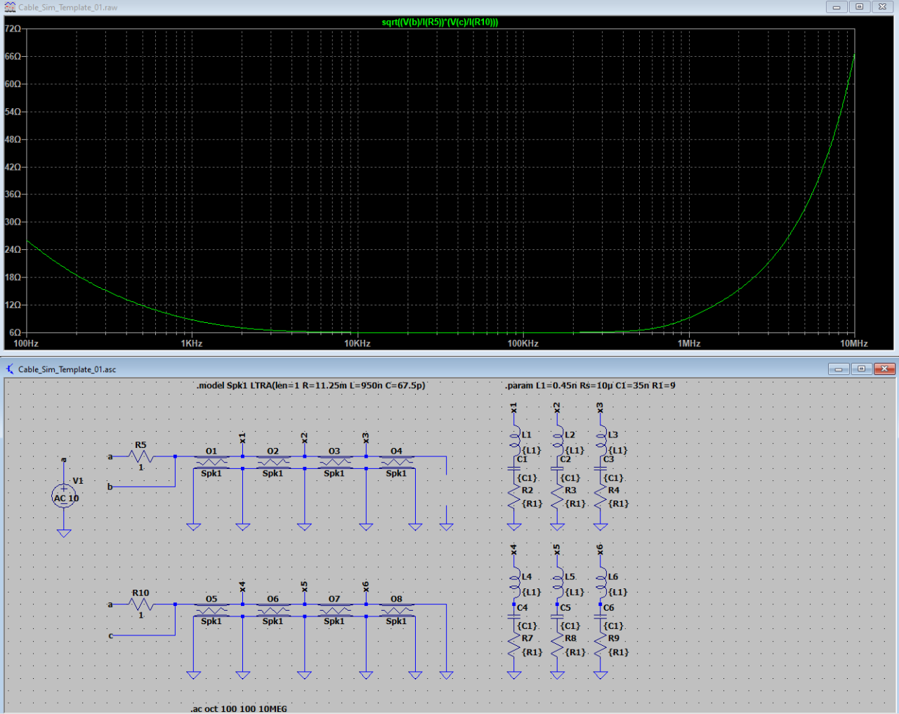

Hi Hans,
I managed to simulate this in Spice (I believe), but I did not find on how the inductor in the RLC- network has any effect…
Could you tell me what I have to look for after changing the inductivity?
Boris
