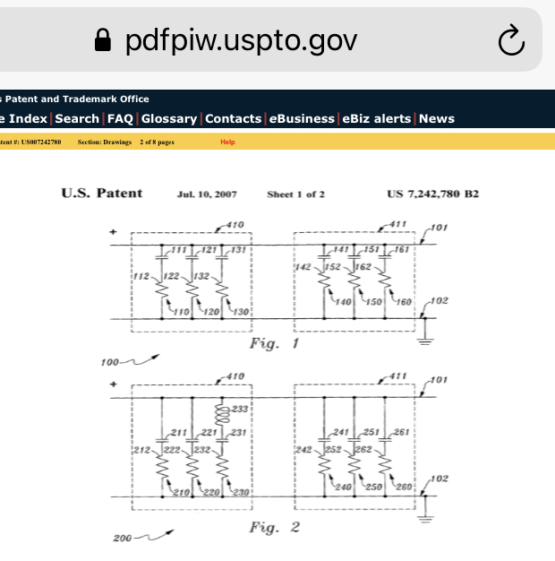

Does anyone know what's inside the mystery boxes on this MIT cable?
A few things can be said to that question:
1) how much can be hidden as a mystery that a VNA cannot decipher ?
See Zip cord for speaker test,
Zo is almost identical over the whole Frequency Range.
2) this MIT MH-770 cable was conceived long ago, but looking at MIT’s many patents, according to their latest one, they now do like what I did, see image below, although it may still be that they use several cord diameters in parallel in their very thick cables, where I used only one zip cord.
Hans

Hi Hans,
how do you calculate the values of the LCR ?
Hi Danny,
In short:
To start with, measure with a VNA the open and shorted impedance of the cable.
This gave me resp the inductance and the capacitance of the 2.5meter 4mm^2 cable, resp 1.5 uF and 150pF. With sqrt(L/C) this confirms Zo=100R.
Now to get Zo=4R such as in my case, from 4=sqrt(1.5uHu/C) it can be calculated that C must be 93nF, so divided over 3caps gives 31nF per cap.
When simulating Zo in LTSpice, you will find that you still need a resistor and a coil in series with the cap, of resp 600nH and 9R, but taking into account the 150nH and 1R that the cap has, I needed resp. 450nH and 8R.
Be aware that these inserted LRC components better be able to withstand a few Amps to prevent added distortion.
Hans
Sorry, I forgot the image.
Here it is.
Hans
