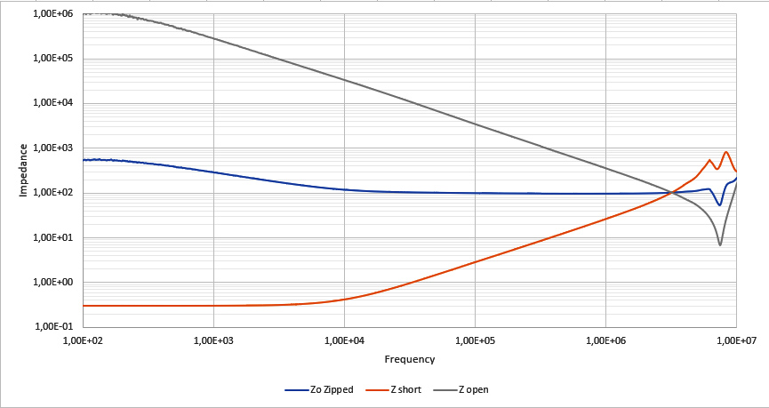

This is what I get with a single 5meter zipped cable.
Quite a bit easier to measure than unzipped cable.
This measurement was done with coax cables instead of probes with a 100R reference resistor.
Difference is a somewhat better HF part, but a noisier LF part.
Hans

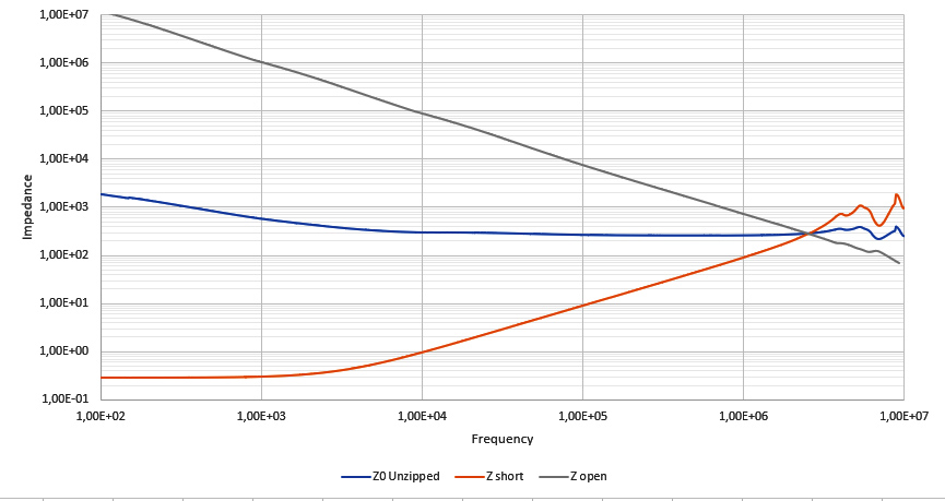

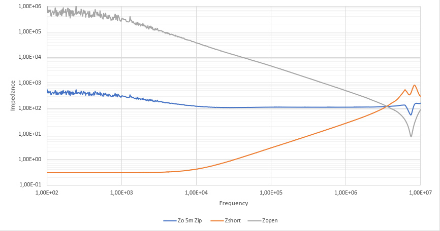

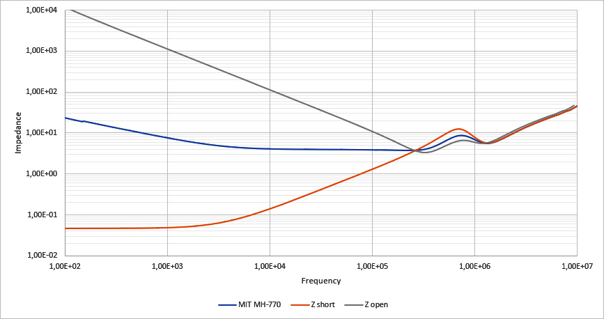

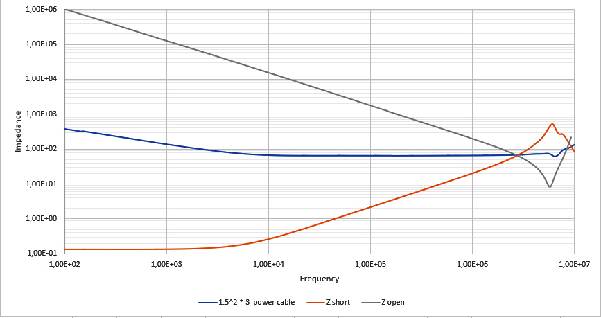

After having finally found the best set-up to measure cable's Zo, and after having solved the trouble with the previous faulty software, I have repeated all test and put them all together in one posting.
Recording was done from 100Hz to 10Mhz with 150 points per decade, 750 in total to get the most accurate results.
A 100R very low induction resistor was used as a reference.
But in those cases where Zopen was very high at 100Hz, a higher value was used between 1K and 10K.
Cables were 5 meter long, except the 9222 Triax and the MH-770 that were 3 meters.
Hans

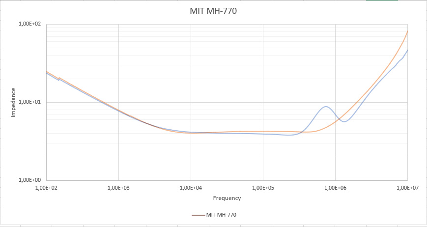

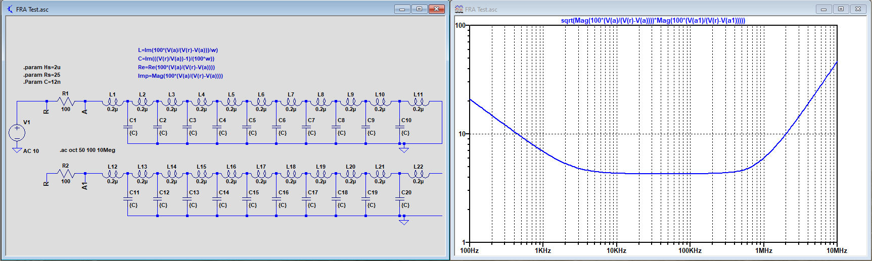

I was just playing around with LTSpice, trying to emulate the measured MIT cable.
Starting point was the measured 2.2uH open ended and 120nF shorted cable.
These values were divided over 10 segments as folows: L=0.2uH + Rs=3mR, C=12nF + Ls=2uH + Rs=25R.
Simulated Zo result came already remarkably close to the original recorded Zo curve except for the (meaningless?) bubble around 800Khz.
I'm almost tempted to construct this to find out how it compares sound wise to the real one.
Hans

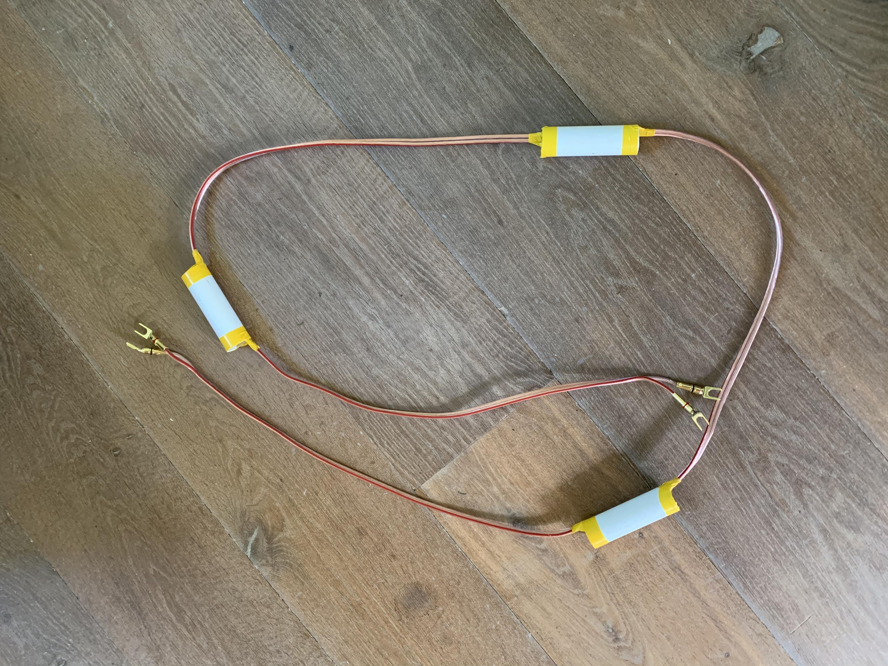

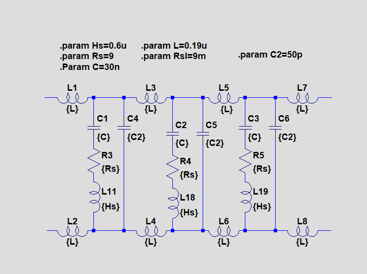

I decided to take the dive by trying to emulate the MIT MH-770.
I bought 4mm^2 zip cord, that has the same 100R char imp as the 0.5mm^2 version.
But Resr for a 2.5m cable is now 30mR, needed to get a low Zo below 1Khz.
I can use the cable's inductance , divided over 4 segments of 0.38uH each in combination with three 30nF Caps, giving a Zo=sqrt(4x0.38u/3x30n)=4.1R.
In series with the caps there are resistors and additional inductors needed to get the whole thing as close to the MH-770 as possible.
Having achieved that, I will do the following:
1) Listen to the two speakers driven through 2x MH-770 cables from one amp.
2) One MH-770 + one emulated MH-770 cable based on 4mm^2 zip plus caps etc.
3) One MH-770 + one unmodified 4mm^2 zip.
Although results will be subjective, I will try to listen as unbiased as possible.
Hans

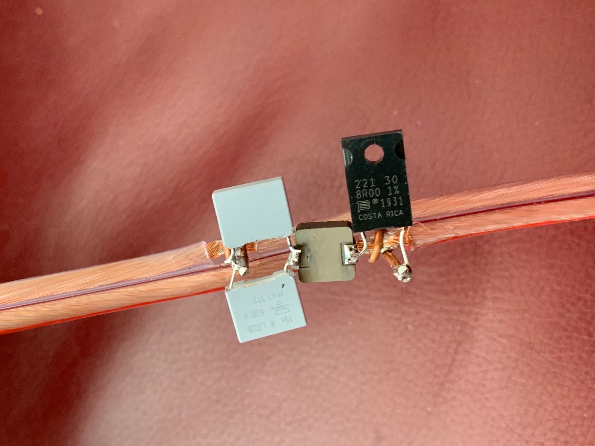

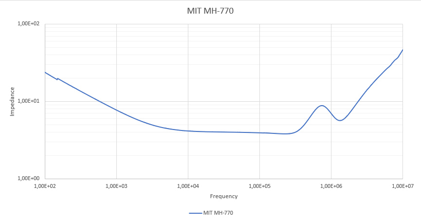

I managed to realize the impedance curve I was aiming for to emulate the MIT MH-770 LS Cable.
I used a 2 x 4mm^2 zip cable with Zo = 100R and added RLC networks, based on measurements of the Zip cable showing 1.5uH and 150pF for 2.5 meter cable.
See images below for the network, a picture of one of the three RLC networks that where added and the Zo curve in orange projected on the MIT MH-77- curve.
Auditioning will be done later this week.
Hans

So here are the results of my listening tests taken with ESL63’s connected to a 100W@8R class A amp. Only one channel playing, source set to mono.
All cables having the same length of 2.5 meter.
1) zip 0.5mm^2 and zip 4mm^2, both with Zo = 100R.
No noticeable difference between them, but sound without depth and width, flat and uninspiring.
2) MIT MH-770. A very 3 dimensional sound giving a “you are there” experience.
Sometimes possibly a tiny bit too wooly and warm, but very agreable to listen at.
3) My emulation. Also very 3 dimensional, less wooly and warm with better articulation of voices, but sometimes a bit too analytical.
Since I used cheap caps for this experiment, I will try to replace them by polystyrene versions and see what that brings, but the conclusion is that this experiment showed that you can clearly improve the sound of a simple zip cord quite a bit, at least for an audio set as I have.
You don’t need golden ears, everybody can hear it, difference is not subtle.
For below $30,- you can make a high end cable set.
The 4mm^2 OFC cable from Amazon costed €28,- for 15 meters, so less then €10.- for a 2.5 meter set!
Will tell after having changed the caps to higher quality versions, what the difference is, if any.
Hans
