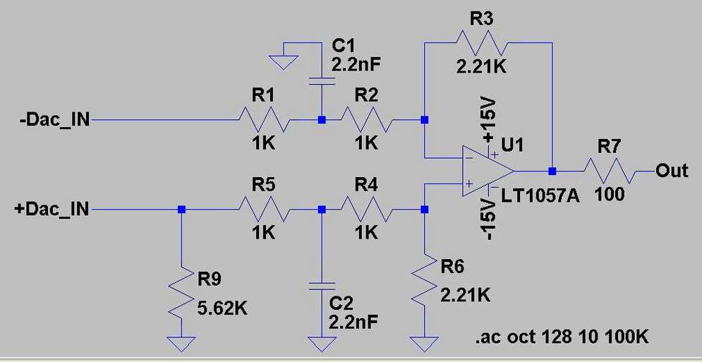

Circuit simulations
Let's hope I reverse engineered the analog filter pcb correctly. Here's what I've come up with for a schematic. The output of the op-amp is connected in series with a 2K resistor, then to a buffer. For the most part, this can be omitted. Just cut the track on the board, and wire the output of the first op-amp to the output of the DAC.
Image: Zhaolu output fitler schematic
I'm not sure what the 100K resistors are for, but they're completely useless from what I can tell. For comparison, here's some graphs I made comparing the recommended filter in the AD1852 datasheet to the one on the Zhaolu DAC:
Image: Datasheet output filter response
Image: Datasheet output filter response omitting the 200 Ohm resistor and 10nF cap
Image: Zhaolu output filter response
Image: Zhaolu Output filter response omitting 100uF caps.
[Edit: missed some parts, Zhaolu filter looks more reasonable now]

DcibeL said:Let's hope I reverse engineered the analog filter pcb correctly. Here's what I've come up with for a schematic. The output of the op-amp is connected in series with a 2K resistor, then to a buffer. For the most part, this can be omitted. Just cut the track on the board, and wire the output of the first op-amp to the output of the DAC.
<snip>
Great work and it looks correct to me. Incidentally you are right about the 100K resistors - they are totally useless..
To get best cmrr you should replace the 100K resistor on the non inverting input with a 2K resistor to make the input impedance the same on both the inverting and non-inverting inputs. Delete the 100K on the other input.
One other thought I had particularly if dc coupling to the diff amp might be to scale of all those resistors and caps by 10X so resistors go to 10K and those 2.2NF caps become 220pF - this should reduce the load on the dac op-amps and might help linearity. Why I ordered 1K resistors instead I don't know.. 😀
I removed the coupling caps, but I am not sure that this is a great idea, and I am going to put something back. I don't think the BG N types I had in there sounded too great, but perhaps they were interacting with the 1uF caps that I have removed.
I am planning to spend a little time on the dac this week-end and see what further improvement I can make without resorting to spending any significant money. I have plenty of parts on hand so I can do plenty. Big snow storm Saturday so I am going to stay indoors.
I think there is a very simple way to do a dc servo based on taking the output from the first op-amp and using the second as an integrator. I'm going to think about that and if I manage to get it to work I will post the details here.
Obviously I will tap the signal at the output of the first op-amp based on your recommendation, had been thinking of doing this anyway - simple with the mods I have done to this board already.
I am going to get the Twisted Pear kits, but I'll noodle around a bit more with this one, and then use it as a reference point for the next big thing.. 😀
I just realized I see a really big no no in the design of this diff-amp - that 2.2nF cap should not be directly on the inverting input.. I'll have to think about how to fix that. Damn should have caught that.. 😀
Edit - I've got it, I'll post the solution when I have tested it. Happily it will result in 2K input impedance at both inputs reducing the load on the dac op-amps and allowing the deletion of the 2K resistor I mentioned in the previous post about the non-inverting input. This will also allow smaller electrolytic caps if ac coupling is desired. 22uF ought to be more than enough.
Joined 2003
There's a 1K resistor in between. I don't have the board in front of my to be sure of my schematic, but the topology of this circuit is the same as what is in the AD1852 datasheet, just with different part values. Are you suggesting that the suggested filter in the datasheet also has a big no-no?
I'll have a closer look at this board over the weekend, and come up with what I think is a good improvement and order some parts. I'd very much like to see what you have come up with for a solution as well, provided it's fairly simple to implement.
I don't think this is a good idea, as it will decrease the 47pF cap to 4.7pF. At these capacitance levels the pcb traces will become problematic.One other thought I had particularly if dc coupling to the diff amp might be to scale of all those resistors and caps by 10X so resistors go to 10K and those 2.2NF caps become 220pF - this should reduce the load on the dac op-amps and might help linearity. Why I ordered 1K resistors instead I don't know..
This is a good idea, I think.To get best cmrr you should replace the 100K resistor on the non inverting input with a 2K resistor to make the input impedance the same on both the inverting and non-inverting inputs. Delete the 100K on the other input.
Take a look at what I have come up with - I will be implementing this tonight.
Flat with .1dB or so at 20kHz, down about a dB at 100kHz.
Gain is a little over unity which is what I need in order to have close to standard redbook output levels - currently the dac outputs 1.8VrmsFS.
CMRR with 1% resistors is less than 40dB, but can be improved to >60dB by simply matching them to better than 0.1% and selecting mirrored pairs.
You can probably ignore R9 in most applications - it makes sense if using ac coupling with reasonably well matched electrolytics to maximize cmrr.
