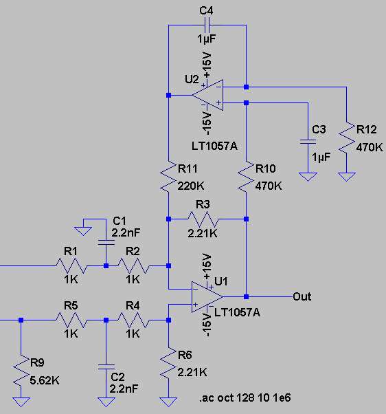

DcibeL said:There's a 1K resistor in between. I don't have the board in front of my to be sure of my schematic, but the topology of this circuit is the same as what is in the AD1852 datasheet, just with different part values. Are you suggesting that the suggested filter in the datasheet also has a big no-no?
I'll have a closer look at this board over the weekend, and come up with what I think is a good improvement and order some parts. I'd very much like to see what you have come up with for a solution as well, provided it's fairly simple to implement.
I don't think this is a good idea, as it will decrease the 47pF cap to 4.7pF. At these capacitance levels the pcb traces will become problematic.
This is a good idea, I think.
FWIW the 47pF/1K pole is probably high enough even with the changes I proposed to put it far enough out of the audio band as not to be an issue. I omitted to mention that I didn't intend to scale this network.
I don't like the implementation and will change it to the classical diff amp I outlined in the previous post. No special considerations are required for HF stability and the input poles while still not symmetrical are much closer.
I may also add the dc servo mentioned later..

I believe this circuit is often used in situations where the diff amp is expected to do all of the filtering in lieu of a separate LPF on the output. The values Zhaolu chose don't seem to be particularly effective based on the responses post. I would need to do further analysis to figure out what I would do were I to stick to this design which given my intentions to change to the circuit posted above probably ain't going to happen.. LOL
Joined 2003
Hi Kevin,
Your circuit looks good. I'll simulate it when I get home from work to see how the response looks, but I think it will be okay.
I'll have to order some parts, so the modifications will be a while before I can have something to listen to, but here's what I have in mind:

Hi Dcibel,
I did run simulations on the new version of the circuit and it looked very good.
I have also come up with a version using the other half of the op-amp as a dc servo, and this looks very promising. I plan to use some of the salvaged 1uF Caps in the servo circuit hence the values chosen.
Incidentally the attenuation at 1MHz is roughly -17dB relative to 1kHz for both versions.
I'm going to implement the new audio stage design tonight if I have enough time before my wife and I go out for dinner. (About 3 hrs after I get home) Hope to have something positive to report.

Well here is the latest update, and there seems to be some good news.
I modified the audio board using the non-servo design I posted. (I, uh didn't have any 1uF film caps for the servo..) 😀
While I'm not going wild with enthusiasm, and no it isn't better than the Sony now - it does sound significantly more relaxed, there is still a hint of the leanness previously mentioned but there is a definite audible improvement right where I wanted it - tonality.
I might want to try something like a BB2132 or BB2604 both of which I have or the BB2107 which I will have to order.
The AD1852 does have a significant amount of HF stuff on its outputs - I can see it on my scope, although at this point I don't recollect the exact levels. I do recommend the LPF as implemented in either of the circuits posted.
Incidentally R9 should be about 3.92K

Well this is what I have settled on for the time being:
The LM4562NA are back in the audio board, there is now an OP275 in the voltage regulator circuit.
I ripped out the Wima 2.2nF and replaced them with Xicon polystyrene and foil 3.3nF which has an insignificant effect on the frequency response out to 20kHz and a couple of dB at 1MHz or so.
I never have been a fan of Wima caps, and I think there was a very small but audible improvement due to their replacement.
I think overall the configuration change was worthwhile.
