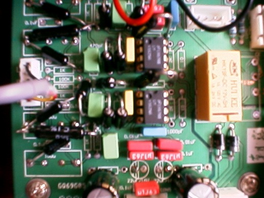

I think you should try to replace those 100uF/10V tantalums on the reference and analog supply pins - it does make quite a difference. I changed these from Silmic to Black Gate standard type 47uF/25V.
I also replaced all of the resistors in the input circuitry of the analog board with Holco H4 1.02K (couldn't get 1K) - these are the older ones.
I also replaced one pair of 2K resistors with Holcos - there is another pair that are not necessary as they go from the output of the first stage to the relay I removed. (You don't need to remove this relay, and if you use the headphone amplifier I would upgrade them.)
I revised the power supply bypasses by removing all of the 46uF/16V caps on the analog board and one pair of the 1uF films - I installed the new Black Gates were the films had been because of the lead spacing was the same.
I have included a terrible picture of the mods to the audio board, the key at the input is to figure out how to bypass a bunch of traces.
The 100K resistors are not required.. On the inputs going to the inner pair of wires on the connector (the ones closest to the connector ground) I have added 2K resistors to make the input impedance symmetrical on the inverting and non-inverting inputs of the diff amp. I have deleted all of the input coupling caps.
The improvements overall are significant enough that I can now tell there is a difference between the Sony and the Media Server as sources - and the Sony wins here too, but the difference was not audible previous to these latest mods. The tonal balance is still leaner than the Sony, but the differences are somewhat less pronounced now. I doubt it will ever equal the Sony but it is much better sounding benchmarked against the Sony (SCD-777ES) than it was when I started.
I will turn my attention to the digital card shortly. I plan to upgrade the RCA jack and may or may not add an input transformer on a permanent basis. (I'll have to try it.) I am going to scrutinize this board for other issues, but because of the very small smd parts on this board I am probably not going to make a lot of changes. (I may replace some of the 10uF tantalums with Black Gates depending on where they are circuit wise.)

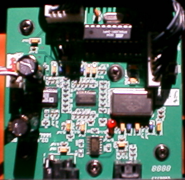

Here's a snapshot showing the Black Gates installed on the digital board, so far this is the only change to this board, but it makes a really major difference.
Basically bend the leads at right angles about 1/4 from the bottom of the cap, tin, and solder to pads. Check orientation such that both pads are reachable with your iron prior to cutting the leads.
Make sure you orient the caps correctly, the solid bar on tantalums is the positive terminal, through hole parts are usually marked on the negative side!

I installed a pulse transformer on the RCA digital input (Mouser part # PE-65612, all of $3.87). This brought the RCA input much closer to the good sound I am getting from the TOSLINK connection. There is definitely a problem with the RCA digital input on this DAC, because it should easily eclipse the TOSLINK. The pulse transformer evens the score, but I think more mods are needed in this critical area to bring it to where it should be.
Anyone have any ideas what else could be improved here, and how to go about it?

BobM said:I installed a pulse transformer on the RCA digital input (Mouser part # PE-65612, all of $3.87). This brought the RCA input much closer to the good sound I am getting from the TOSLINK connection. There is definitely a problem with the RCA digital input on this DAC, because it should easily eclipse the TOSLINK. The pulse transformer evens the score, but I think more mods are needed in this critical area to bring it to where it should be.
Thanks,
Bob
Hi Bob,
Outside of all the things I have addressed? 😀
I will order one of those transformers, but in my case both sources have transformers on their outputs.
I did improve the digital grounding on the dac board with the addition of some braid to provide a lower impedance ground path to the chassis connections. The three caps I changed in the analog section of the dac board made a very big difference. FWIW there is a lot less low hanging fruit on the AD8512 board anyway as this board was laid out a bit better than the others, and the small size of the components restricts rework options except for the very bravest.
The input circuit probably does not present a 75 ohm load to the outside world. I need to see what is going on there. I'm not yet sure what they are doing, but my gut sense is that it might need to be fixed. 😀
I've swapped out all the RCA connections for better ones. I also do see a SMD 75ohm resistor just under the RCA connector on the board. I would guess a better quality input resistor there might help, but it is QUITE small.
Overall I have to say that, after burn in, the RCA connection is now more open than before. The TOSLINK still has more air, but I now also hear the digital grunge on it, where the transformered RCA is cleaner overall.
In general I think this little unit is now sounding pretty darn good. I guess I'm just looking for that higher hanging fruit at this point, if there is any to be had.
