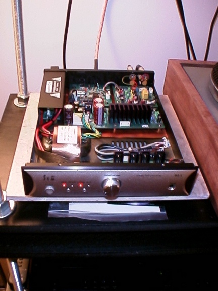

I've been investigating some sound quality issues that have surfaced lately with my Zhaolu 2.5A Dac, well the problem is that my modified Sony SCD-777ES SACD player is absolutely creaming it on red book cds sonically speaking, to the point that the Zhaolu sounded broken. Now the Sony is more than slightly modified, but the differences are so profound on a/b via spdif coax to the dac and the analog outputs of the Sony - and the results are virtually identical playing the same material via the media server until I upsample to 24bit 96K where the audible differences are less but not gone - the Sony still wins by some margin. Incidentally the Sony's are regarded as quite good transports in their own right, unfortunately I do not have another dac to compare with. The Zhaolu sounded far better at the time than the PS Audio Ultralink II which I subsequently sold.. The Sony is far quieter, shockingly so, and you may not even understand what I mean - the background is black, there is a lot more micro-detail, and it just sounds much better..
I took the dac apart tonight and discovered that the power supply board is full of pcb layout errors. The grounding scheme is somewhat messed up. I discovered that the transformer center tap is grounded to multiple points on the board, and that the only way to fix it is to remove con1 on the board and looking from left to right cut the 3 tiny etches that go from pin 4 to the board ground plane on both the top and bottom - this at least removes one error in the board grounds. More work is needed and I will add detail as I figure out how to fix some of these mistakes.
The chassis is also part of the grounding system for the digital portions of the dac, and I found adding a copper foil plane in the chassis improved things audibly. I had to remove all of the stand-offs to do this, and there are a lot.. 😀
I also added the missing safety ground that others mentioned and checked the AC leakage for both normal and inverted ac polarities and could measure no difference in leakage current with the Keithley 2002.. (ground not connected obviously) So I left it as it was.
Still doesn't sound good next to the Sony, but it is definitely a little closer.

Update...

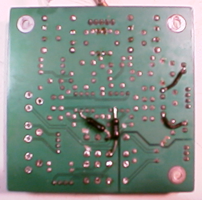

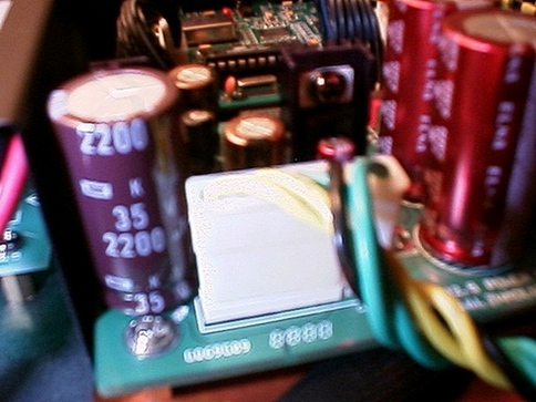

There is a 2200uF/25V G-Luxon cap on the left hand side of the power supply board with a direct connection back to the transformer center tap that I did not cut the last time around. This time I cut the etch on the top of the board to this cap ground and ran a wire directly from the negative side of this cap to the mecca ground between the two analog supply 3300uF caps - this plus replacement with a generic rubicon made a big difference. (This change makes the transformer center tap go directly to a point common the grounds of all three filter caps powered by this winding and from there to the board ground - it keeps all of the charging currents confined to well defined paths.)
I also shorted various of those "ground traces" to the ground plane with wire and solder as opposed to the thermal decoupled through holes that exist. I just did the ones by the all of the regulator output caps.
Much cleaner, and now sounds a bit closer to the Sony analog outputs. The Sony still wins hands down, but it is not embarrassing as it was before. (This was a substantial improvement and should be audible on any 2.5A or 2.5C I suspect.)

More rework detail:
I have a very poor digital camera that will not provide detailed pictures for this mod. The mod consists mainly of removing the transformer secondary connector on the pcb, cutting six little whisker sized etches around con1- pin4 (transformer center tap), reinstalling the connector, replacing the 2200uF cap with something decent and cutting an etch to its negative terminal on the top side of the board and jumpering it directly to the ground "mecca" on the bottom side of the board between the two large 3300uF supply caps to the analog supply.
Finally if you look very closely you will notice the ground side of all of the components in the analog supply and some of the clean analog supplies to the digital board have tiny little whiskers to the ground plane, and odd traces that run all over the board and are grounded at multiple points on the pcb - these shouldn't exist at all. (These are thermal through hole pads incorrectly implemented.) Just scrap some of the mask away around the adjoining ground plane and solder some wire across this point. I did it near to the output caps of the +15/-15V and the dac's analog supply as well.
Get some thin copper foil or sheathing (home depot, etc) and remove all the stand-offs, fit to chassis and drill holes where the screws need to pass through, reinstall the stand-offs loosely and then install the boards - once everything is aligned properly tighten everything snuggly.
I am going to figure out how to reconfigure the muting relay to shunt the output, currently it is in series with the output signal, not the best thing for clean sound.
Also I have not replaced the POS output jacks, and this is needed desperately.
Hope this detail helps..

Take a very careful look at the power supply board as there seem to multiple problems with the grounding arrangements. I found 3 separate places where the transformer center tap was grounded to the board, and all those etch cuts I described were just to address that one issue. (It really does help.)
The other thing is the way that thermal vias are used to make connections to the ground plane, and that there are often traces between each of the components connected to the plane on the ground side - each trace being connected to the plane at the thermal via. These particular thermal vias have relatively high resistance connections to the plane, and I think it is worthwhile to fix this by at least shorting across the trace to the plane in one place - I choose the output caps - I didn't try to cut all of those whisker thin etches though because there are a lot of them..

I replaced that G-Lukon 2200uF cap with a much lower esr/esl rubycon and I think this helped as well.
The copper foil also seems worthwhile because this is a steel chassis and many of the standoffs go to ground points on the digital board as well as the power supply board, over time I suspect corrosion would compromise these grounds, not to mention the powder coat overspray all over the inside of the chassis. Steel isn't a particularly good conductor particularly at high frequencies so I think the copper foil is a good idea. You can use copper sheathing from a local home center, and that might be even better. (Probably brush some clear varnish on the foil/sheathing after installation to keep it from corroding?)

Next from the top side remove the 2200uF G-Lukon electrolytic cap and discard it. Cut the etch topside (anywhere) from Con 1 pin 4 to the negative side of this capacitor. Next install a better 2200uF (Elna/BG whatever) here and solder a wire from the negative terminal on the back side of the board to the middle of the mecca point where the two 3300uF Elna caps feeding the analog supplies are located. This looks like a big T that goes directly to the middle mounting standoff pad.. Solder a piece of braid from the pad to the adjoining ground plane. (Make sure it does not interfere with the standoff causing the board to bend.) Reinstall Con1.
There won't be any pictures of this mod, because my camera does not have sufficient resolution to show it clearly. Anyone else who does this mod please feel free to post it here.
If you remove the power supply board the issues I mentioned should be very obvious.

Well I did some more work on the dac only for it to get clobbered by the Sony again. (Consensus of my friend Nick and I) Still it has improved and here are the latest mods.
I removed the two ferrite beads, and reconfigured the muting relay to shunt the outputs.
Just cut out the two 10 ohm resistors on the top near the op-amps, hard to miss as they are the only 10 ohm resistors on the board. Solder 100 ohm resistor from pin 7 of each op-amp to the appropriate pin on the relay as shown below.
I removed the relay on the outside edge of the board, this one feeds the headphone amplifier which I will not be using in the future.
I also ripped out the crummy rca jacks and replaced them with a single pair of tiffanys I had on hand.
The traces on this board lift very easily compared to the power board and the copper seems very thin.
This modification did help significantly, slightly narrowing the gap. Nick thought the dac sounded a bit brighter overall than the Sony, but that unfortunately it lacked the clarity and detail of the Sony. I agree.. Most of the odd colorations and grittiness previously audible are gone, the highs are a little cleaner, but the ultimate level of resolution is audibly (and vastly) inferior to the Sony scd-777es analog output. Connected to the server and playing the same music ripped from the same disk the result sounds identical as best we could determine and does not get any closer to the level of performance we heard from the Sony analog outs.
I would say this is a good dac, not a great dac, but the others I had previously must have been worse I guess.

I've ordered parts for some cap upgrades in the audio and power supply boards. (Mostly 47uF BG) I have also ordered a bunch of the original Holco H4 1.02K (1K no more stock) to replace the originals in the diff amps with - it will be a tight fit. I also plan to make some changes to improve cmrr in the diff amp stage.
I'm going to move the ground on the analog inputs on the audio board and take a closer look at the digital board.
