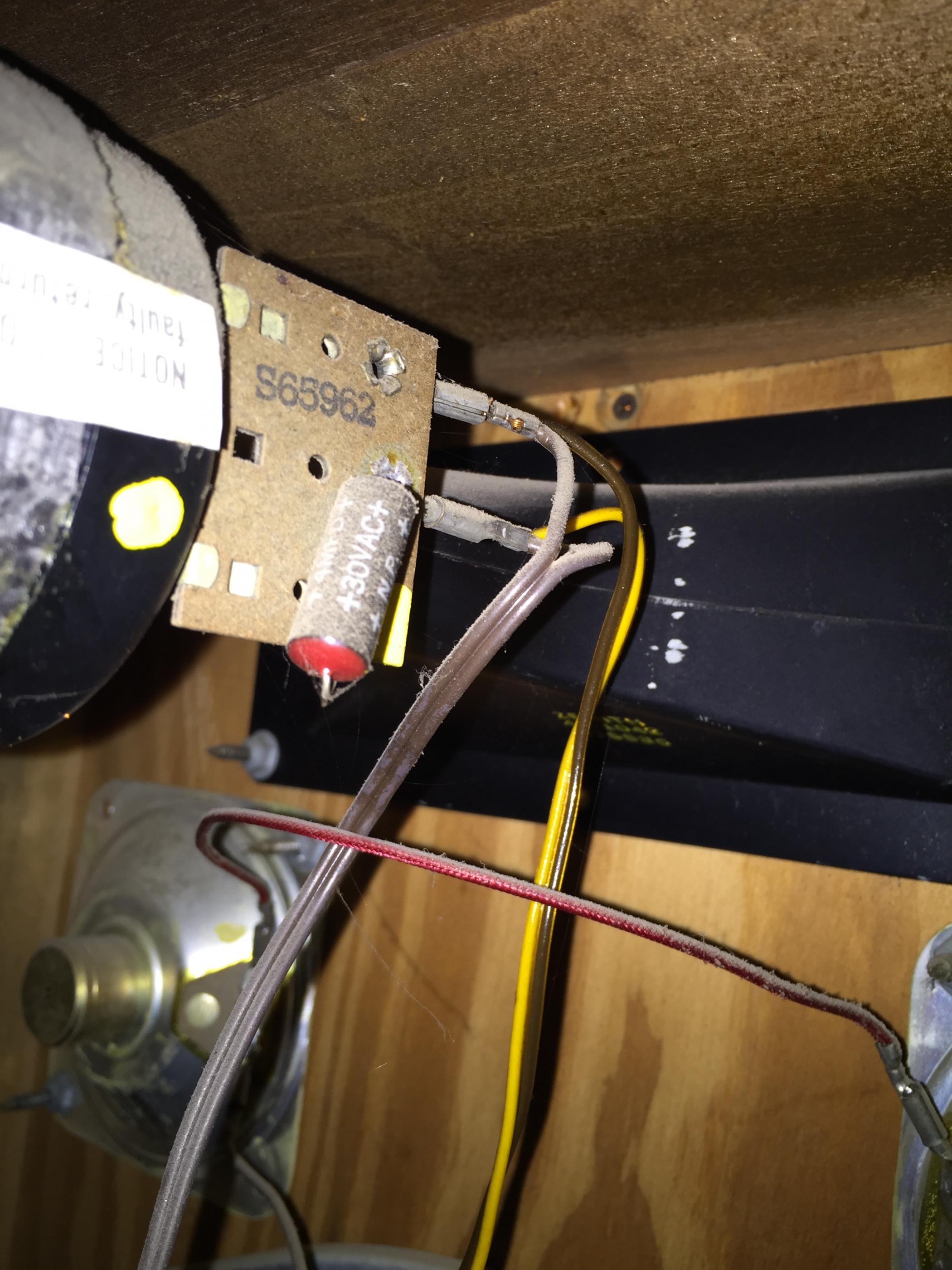

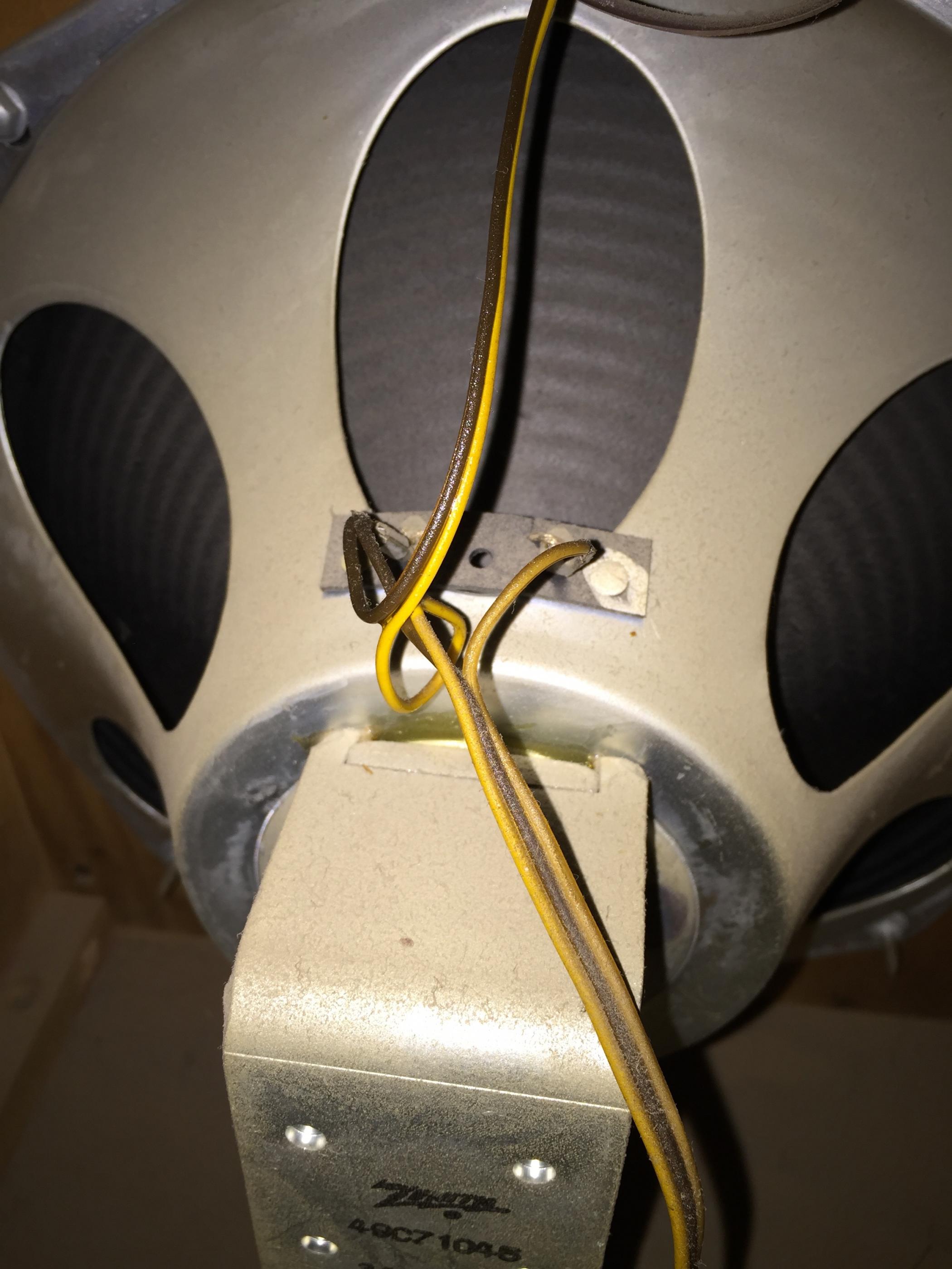

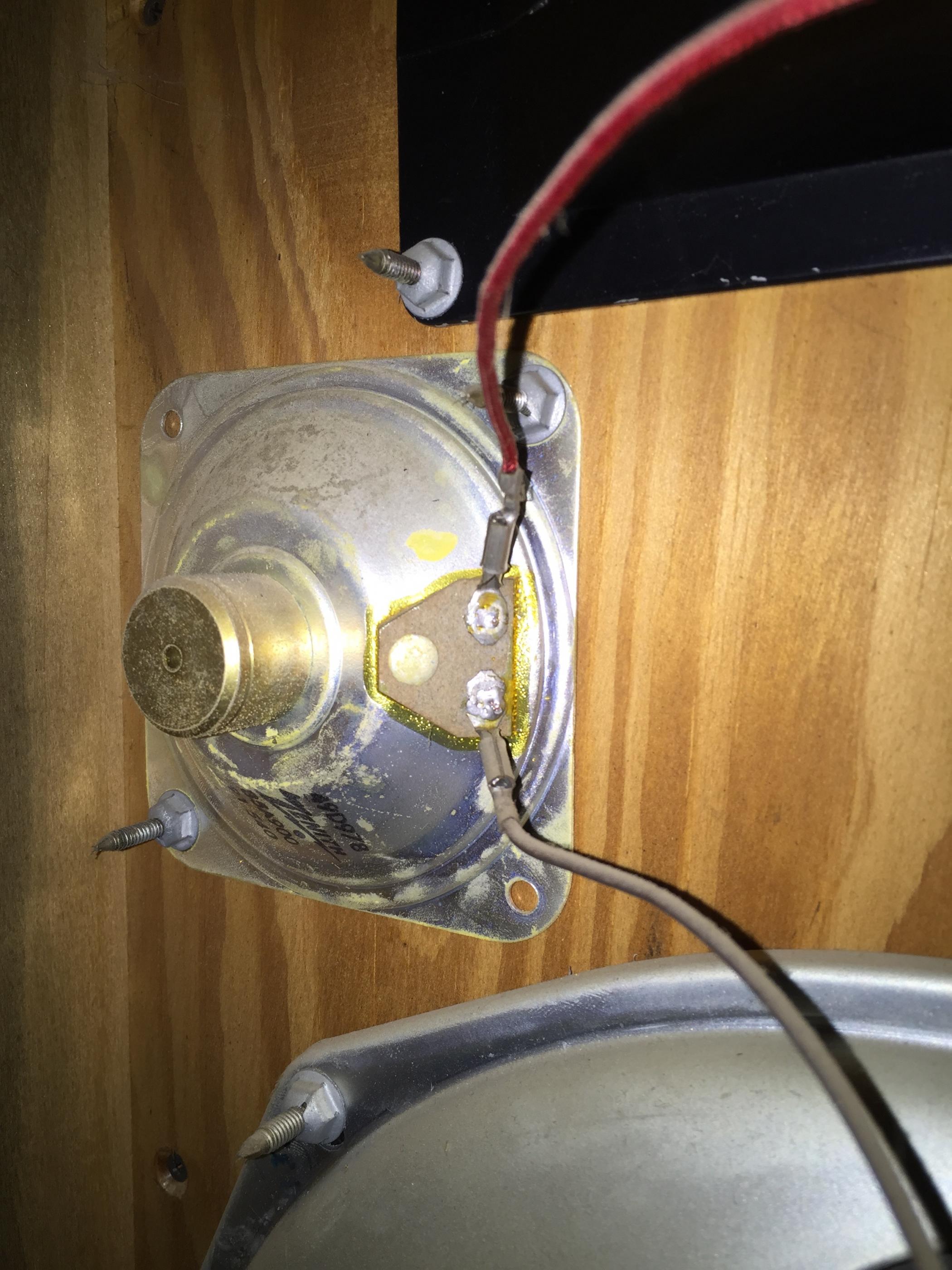

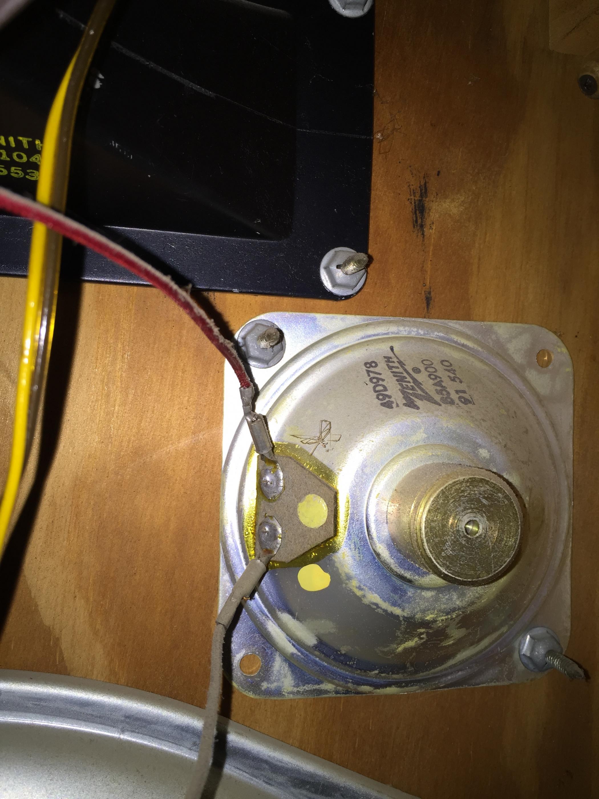

'why 3 wires not 2?' - looks like two stripy wires to me (post 31 RH pic), but I could be going blind.....;-)
re 3 wires i have encountered this in other Zenith consoles some are indeed "bi-amped" others are merely parallel high passed through a capacitor but the wiring color scheme is consistently dark brown (- or ground) and beige/tan = low and drk brw and yellow = high.

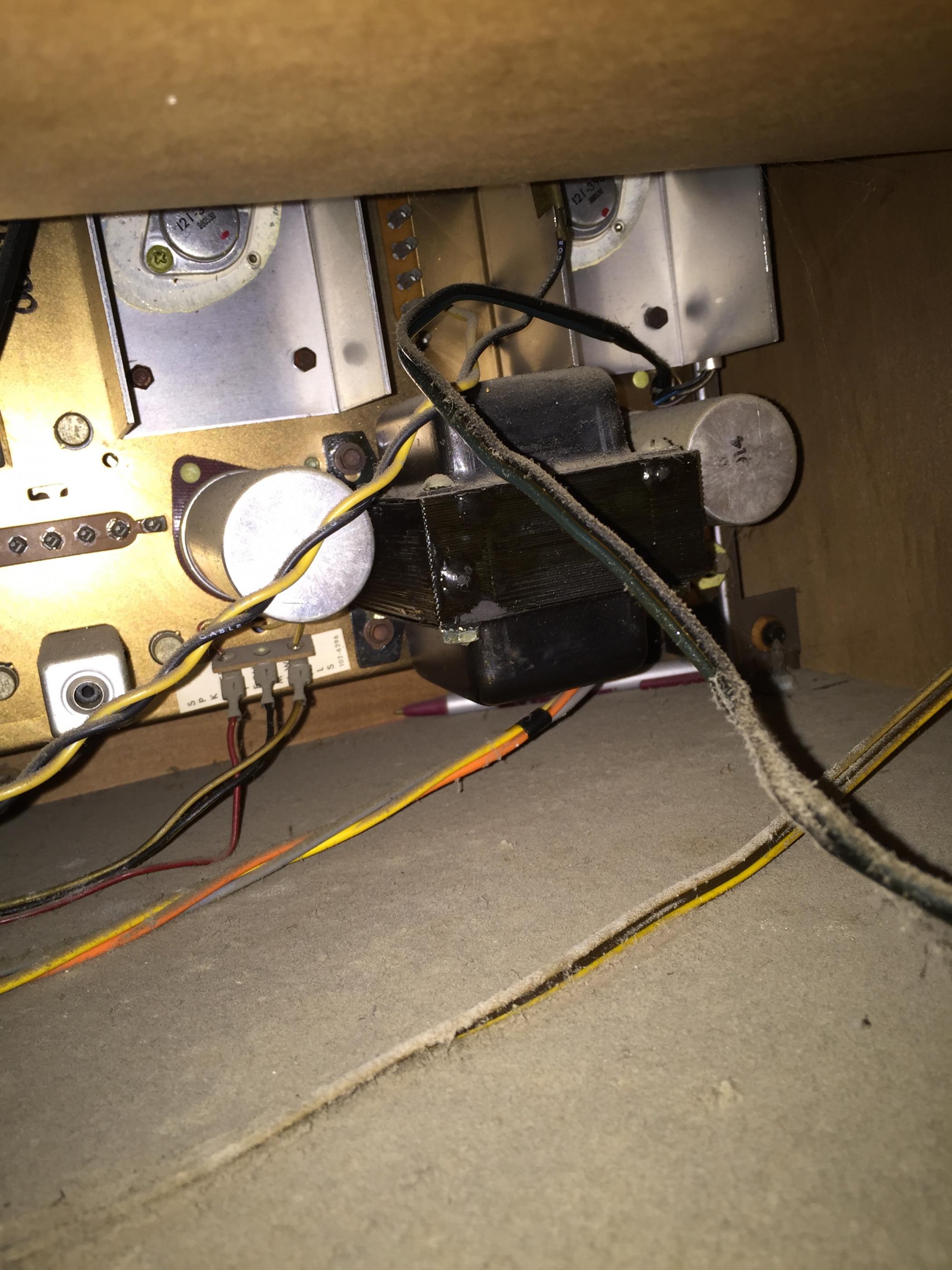

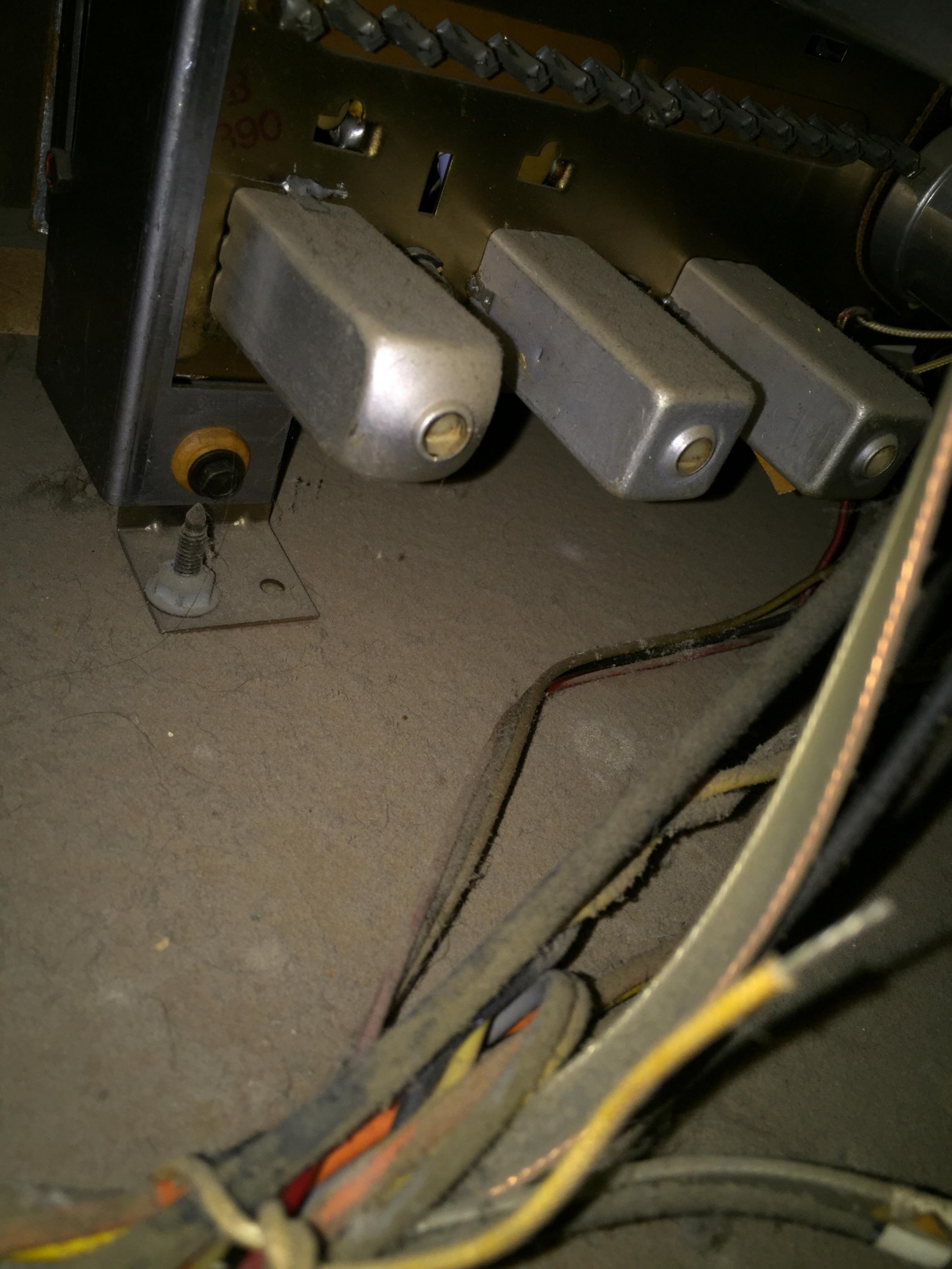

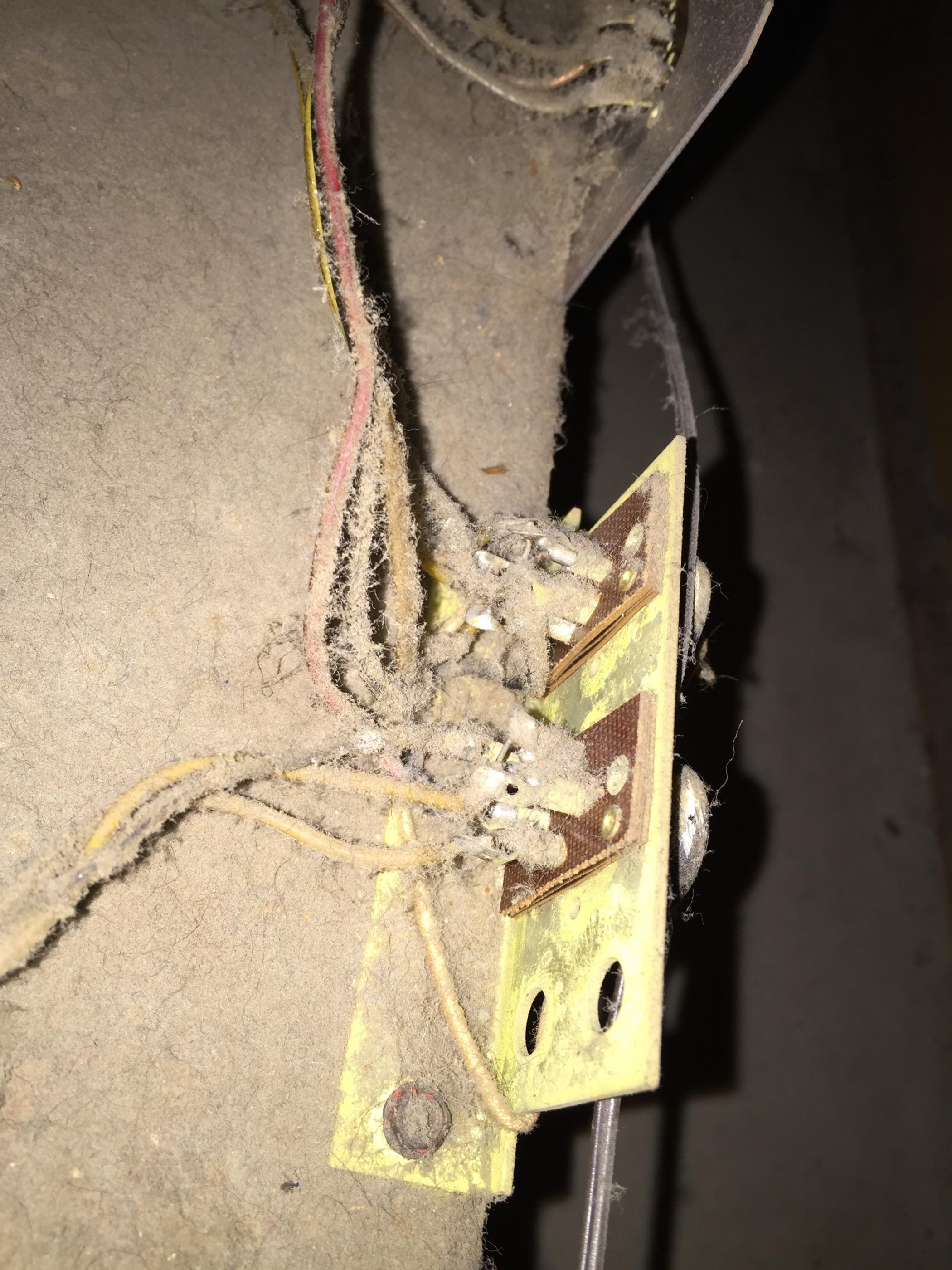

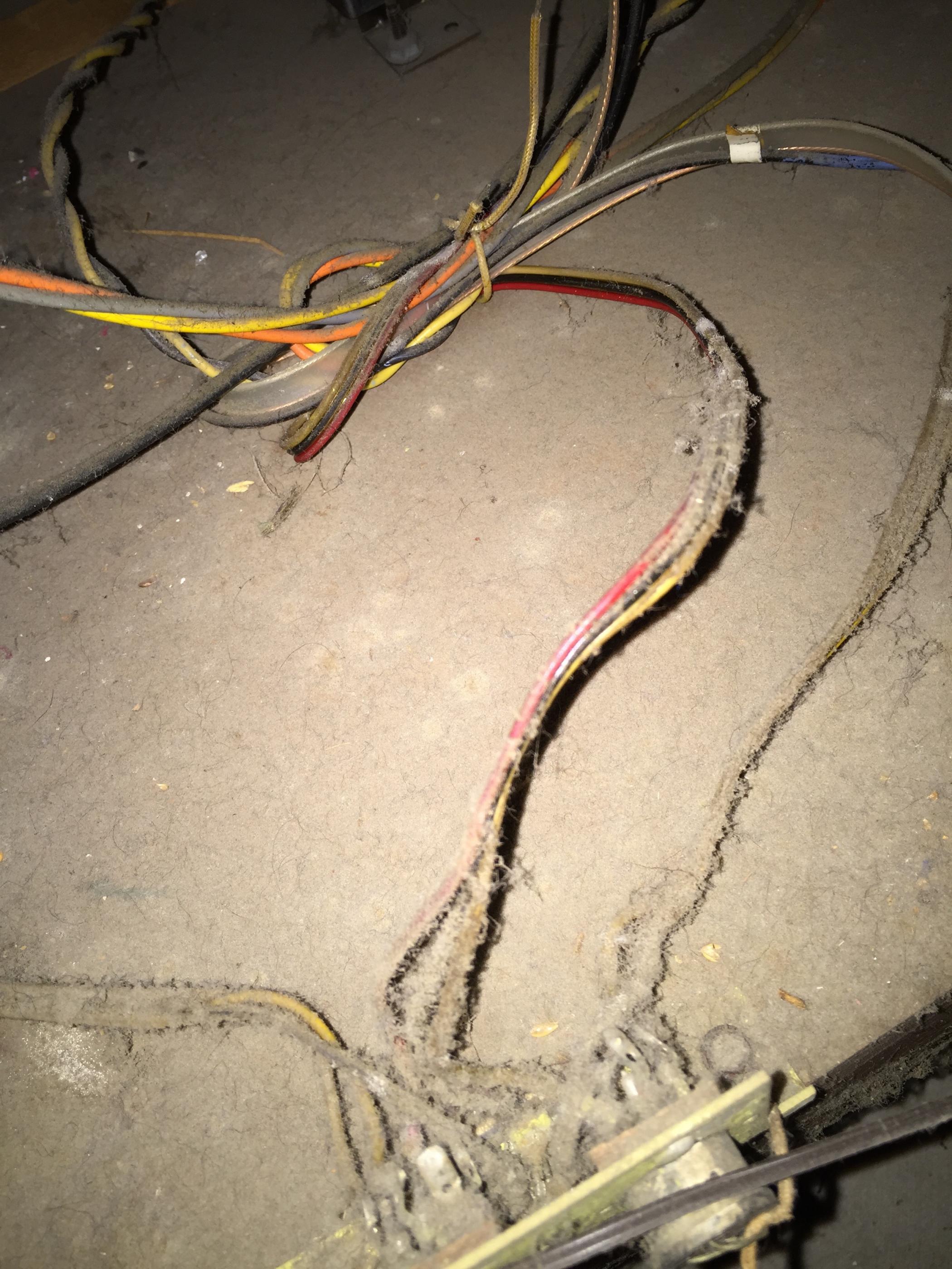

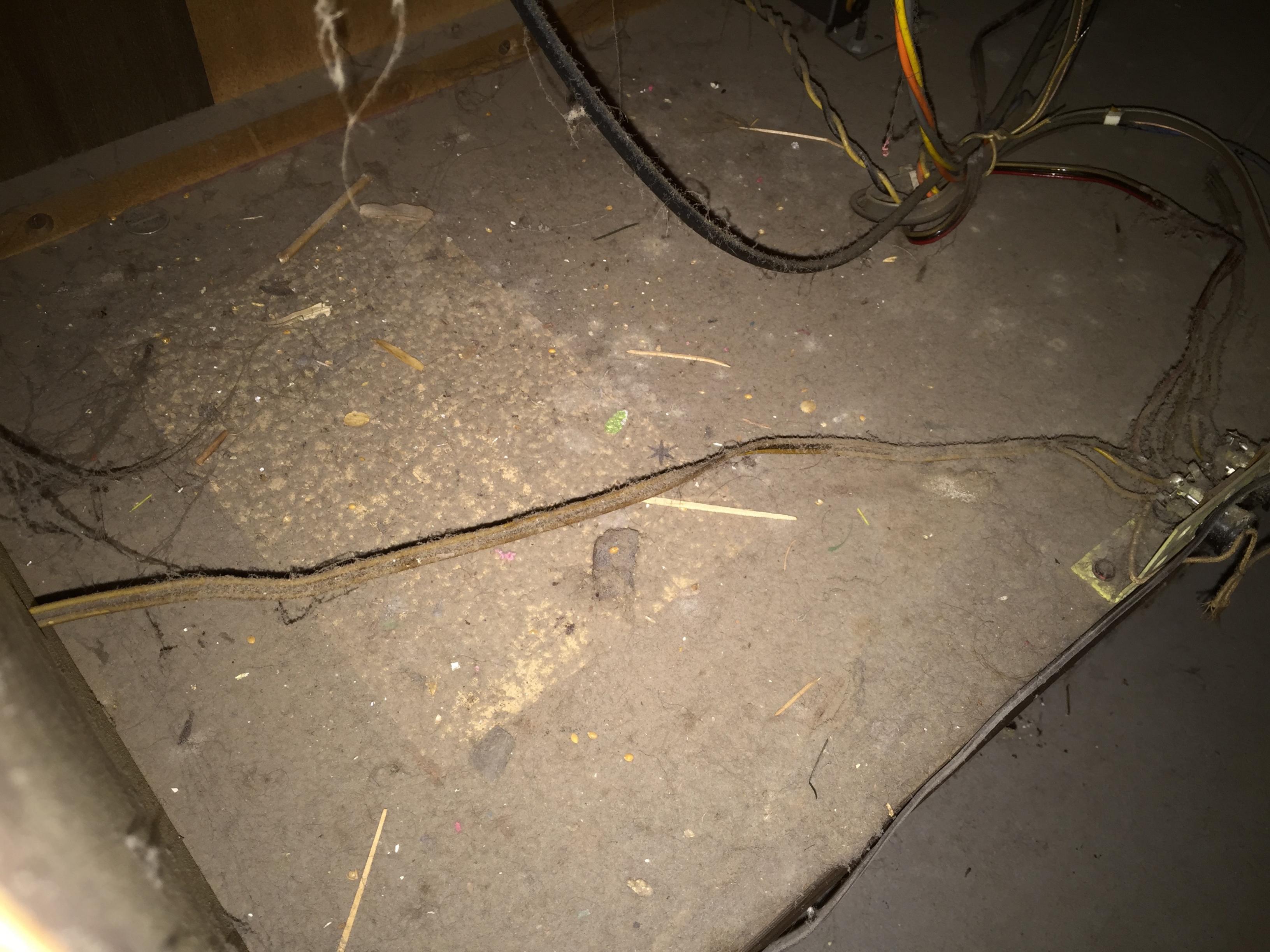

so the thing we need to sort out is whether or not the high section was being driven by a separate amp or whether it was parallel high passed (and what frequency the x-over is) tracing the wiring back should help to find the components where looking to transplant.
Ok, i will trace the wiring back and take pics.

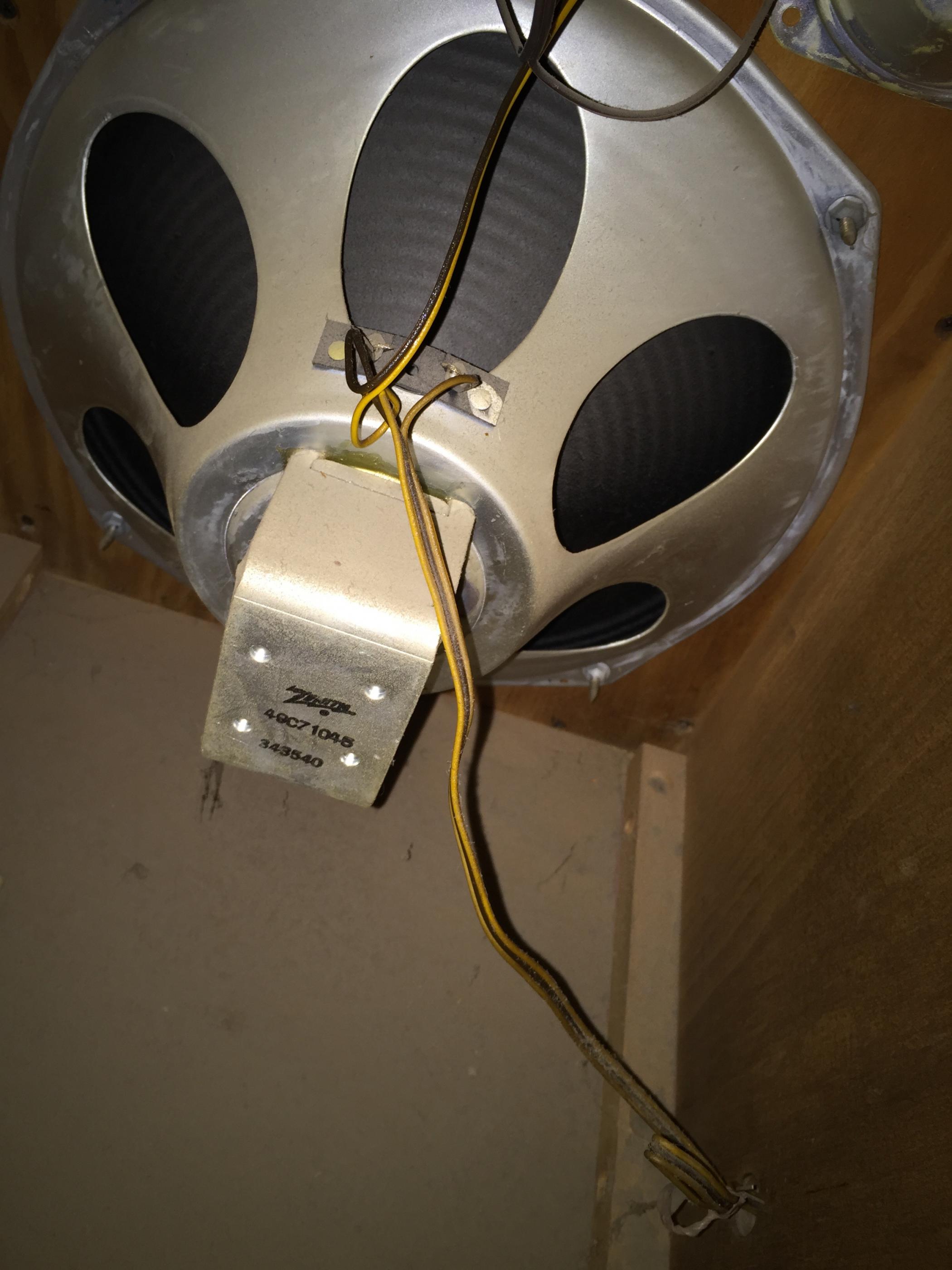

Looking at the pics, I don't think it's that hard - there is only one pair of wires going to the amp, & there is a single cap poking out at the RH side of the horn... i.e simplest xover possible...
so, make your boxes, (~same size as existing cavity & with open back), transfer the speakers with the same wiring, & connect the lower pair of wires coming off the woofer to the speaker terminals you want to use... voila...
Should I cut the wire that leaves the woofer to the extension speak connection? Do I need to disconnect the wires from the tuner/amp?
Keep the back of the new boxes open?
ok great! so the lower pair of wires coming from the woofers can be cut and fed into a speaker terminal?
