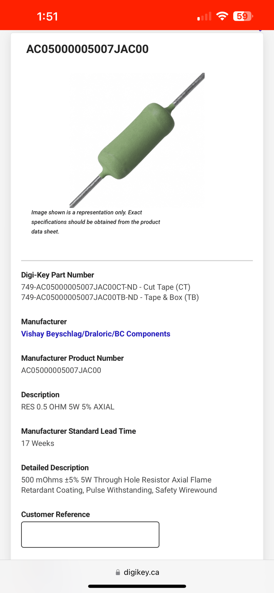

What is the number of manufacturer or Mouser for this R1 resistor?
Is this wirewound resistor proper?
https://www.mouser.kr/ProductDetail/Vishay-Dale/NS005R5000FB12?qs=d8Z78VFXGhkUcvPP/DEc/w==

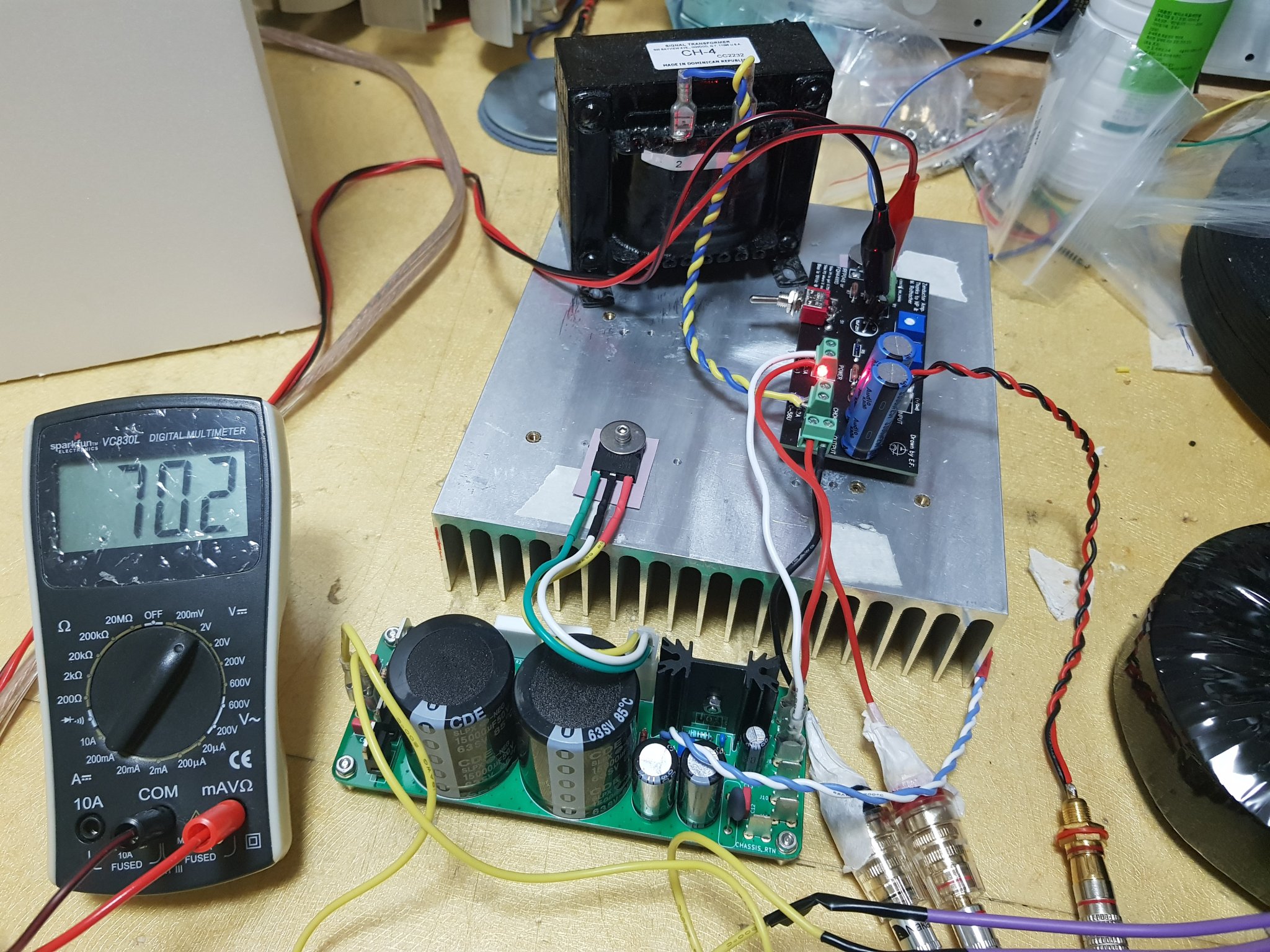

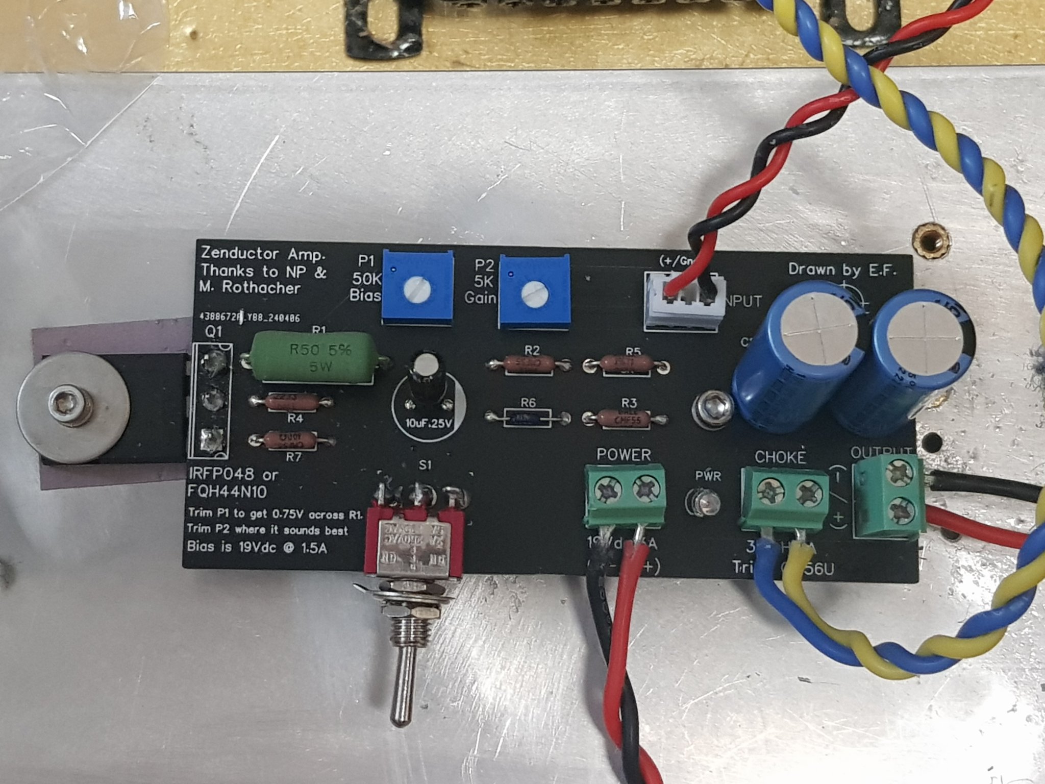

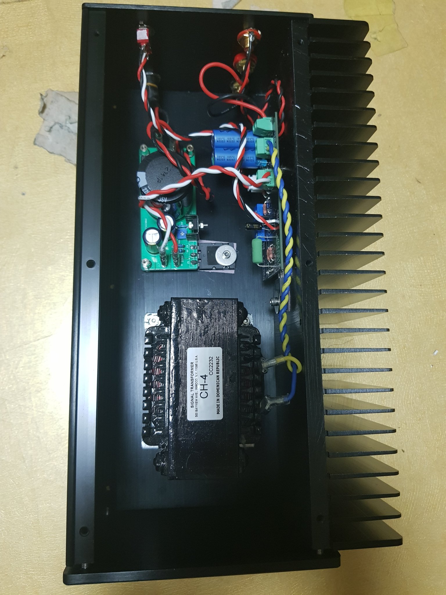

PCB by e_fortier
Power supply : 18VDC, 3A SMPS
R1 : 0.5R, 5W https://www.mouser.kr/ProductDetail/Vishay-Draloric/AC05000005007JAC00?qs=R4/Aj8xQbdXW%2BmVd5kK40A==
Inductor : CH-4 (Bel Signal Transformer, 70mH, 600mOhms DCR)
C2, 3 : 3300uF, 25V

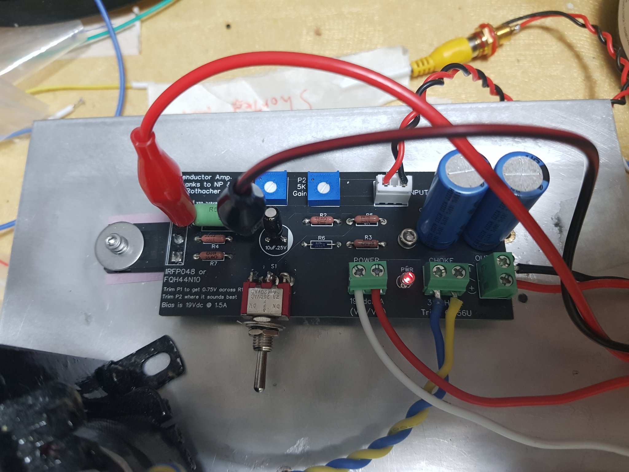

When I turn the switch on, the power LED blinks.
C2, 3 : 3300uF, 25V
Very likely you have either a short somewhere or the fet is faulty.
Check and re-check again. If you can remove the fet and check for shorts between pins. There should be none.

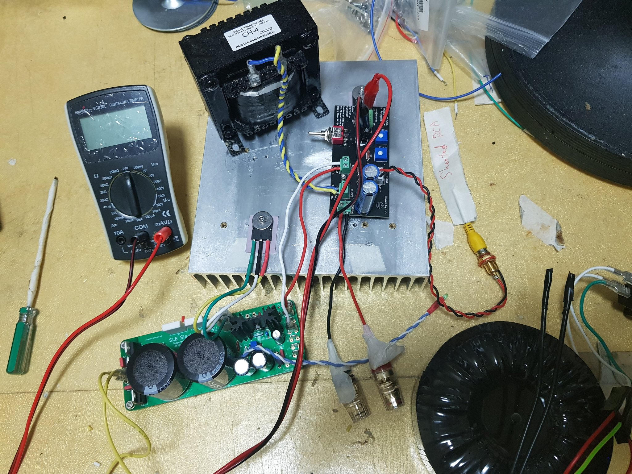

I changed smps to linear psu 17.4VDC.
I turned P1, P2 pots to full counterclockwise.
I switched it up ... then voltage of R1 was about 2.0 VDC.
...and my BOM https://docs.google.com/spreadsheet...XHMWGuYM4kkblgmK2L_q9G52M/edit?usp=drive_link
Hi
As I mentioned earlier, P1 is connected the wrong way. You must put it fully clockwise to have minimal bias then turn it gently counterclockwise to slowly increase bias up to about 1.5A to get about 0.75Vdc across R1. Keep me posted.
You can put back your SMPS if you wish.
Eric
Eric
Try starting with the Pots in the middle. It seems like one or both of the pots were "backward" (more voltage is counter clockwise). I can't remember for sure.
@e_fortier Thank you!
I started adjusting P1 from full clockwise and got 700mV 1.4A bias.

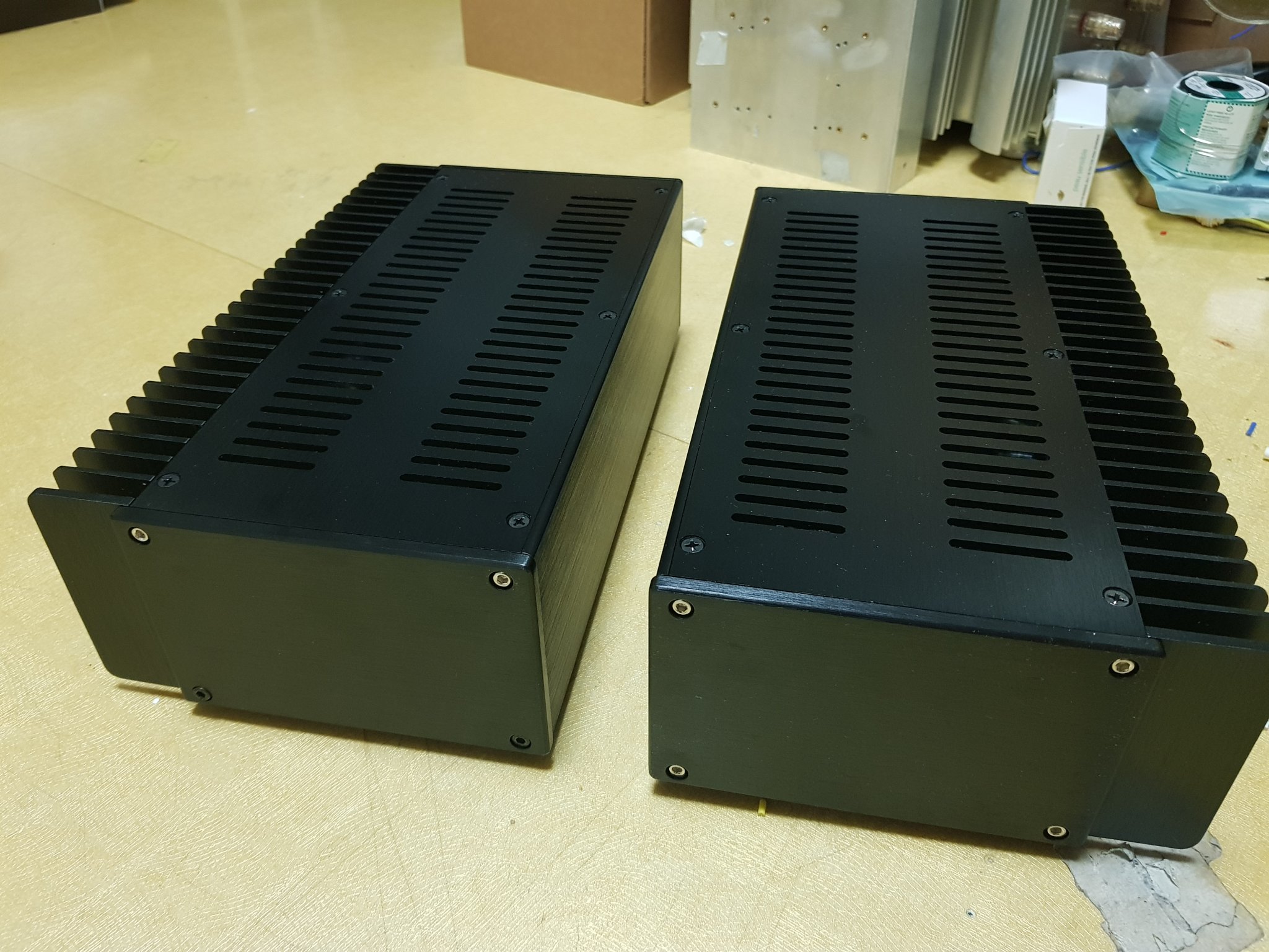

Is that the store mono chassis? Or a different one? How do you like the sound?I've built this amp in mono chassis.
I used MEAN WELL GST60A18-P1J but it made noise so then added CapMx.
https://ko.aliexpress.com/item/1005006872798055.html
I've requested the rear panel as blank to the seller.
You need 2 pcs.
I did not listen with this too much.
You need 2 pcs.
What is the required minimal value of C1?
I am considering replacing the 10uf electrolytic capacitor with a smaller value film type capacitor,
What value C gives 10 Hz rolloff?
Approximately...
Minimum input Z is 2k,
10 hz x 2pi = 63
63 = 1/RC = 1/(2000 x C)
1/C = 2000 x 63
1/C = 126000
C = 8 uF

Thank you so much.
I'm going to use this capacitor.
I think it will be easy to replace since the lead spacing is narrow at 5mm.
