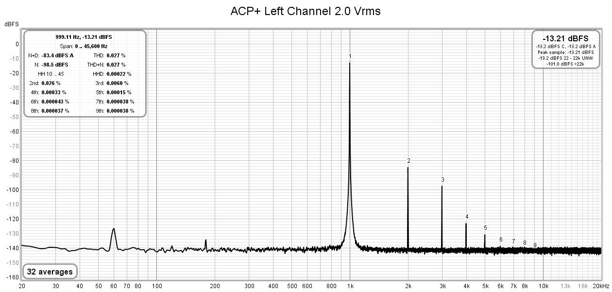

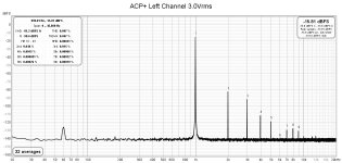

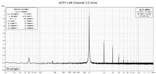

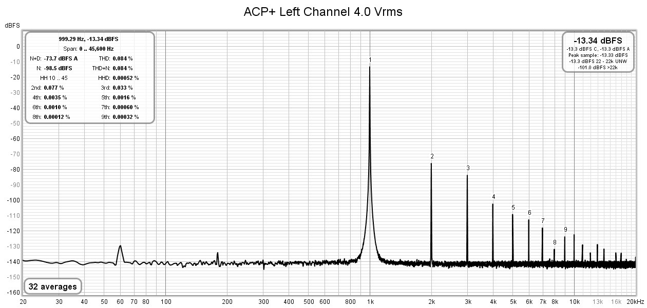

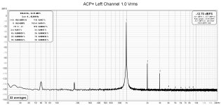

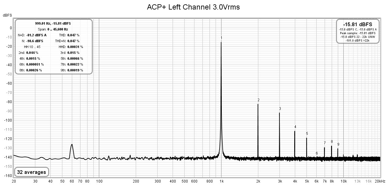

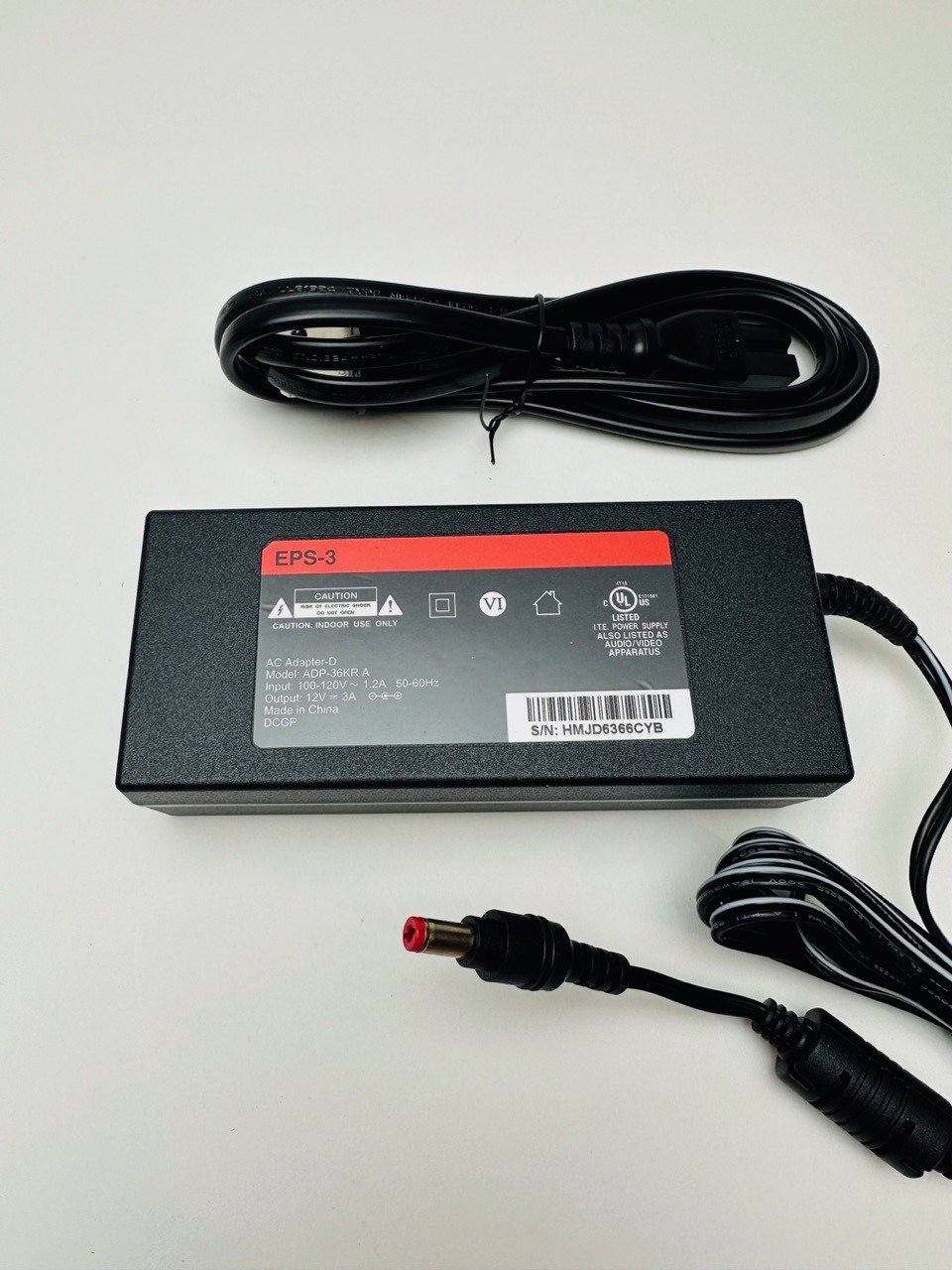

Jim, do you have a part number for the 12VDC power supply you show in the build guide pics?
Have found the Meanwell GST60A12-P1J - which is a 5Amp unit - I assume this will suffice?
The Meanwell has a 3 prong power cord, you would be better off with an isolated 2 prong power supply like recommended in the BOM. (It prevents ground loop)
Each channel seems to be bias at 0.9Adc (0.5V across 0.56 ohm resistor) so I’d aim for 12Vdc, 2A or 2.5A for each monobloc.
EDIT; Just noticed that the BOM is showing a 12V, 3A power supply.
BR
Eric
GND is state of mind
though, always best to respect state of mind of Constructor
so, in this case too, you can either short audio gnd to case, or "elevate" through regular ways - be it solo NTC or combined with bridge
-V is -V; negative leg of PSU, which is not declared and used as GND
so, yes, as Pa sez - important is not to use switchers having neg leg shorted to its case, thus resulting in short with chassis/safety GND
